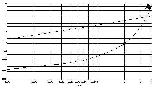

Are these pure class A amplifiers? Also our LME49811 based amplifier has beaten every tube and solid state unit is has gone up against (even Dennis Had at Cary was stunned when I did a demo of the power amps and D/A box at his place in North Car. He was so stunned he designed the new Exciter Dac around the national LME parts in 4 months!...which is quite a thing for a tube guy to do! Also I turned tube guru Joe Curcio into a believer. Joe is also still an FAE at National!) The LME49811 is class A internally by the way.
Listening is #1 of course but I (and Bob Pease) believe it must be combined with good measurements. If something measures poorly, .1 to 1% THD+N or higher, then the listening tests are suspect! We found in our single blind tests at National that small improvements in THD+N, that were linear with increasing power levels, resulted in audible improvements. Also the New LME parts have a unique process that matches the NPN and PNP transistors in such a way that they have identical dimensions, carrier flow, and ft's! Because of this we were able to run much lower bias currents than normal Class A/B amplifiers and still get great measurements and superb sound quality. That is why the opamps are doing so well in the high end community.
Has anyone done any set of measurements with an AP2 Cascade on one of the Pass amplifiers with these new output FETS like the graphs shown in AN-1850 for the LME49830?
I also attached a THD vs Power graph I made of my mono LME49811 based Amplifier with 50VDC rails into an 8-ohm load.
