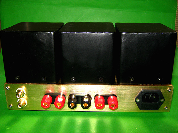

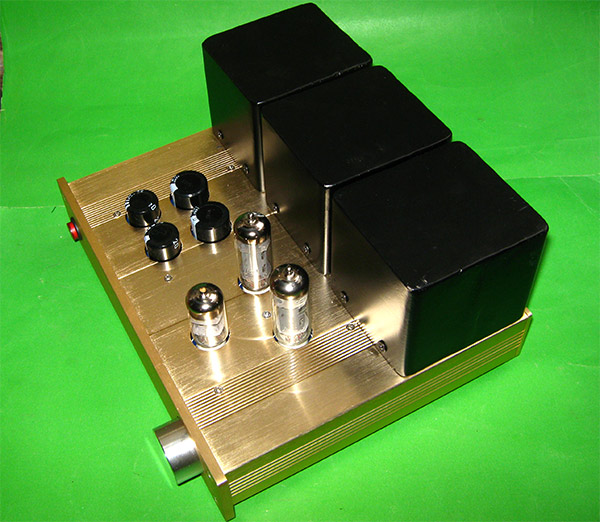

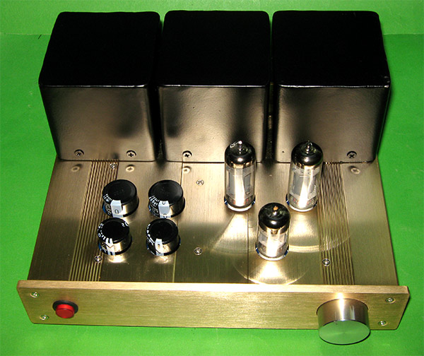

It take us almost two months to finish the project.Specifically the design of the aluminum alloy shell and three power supply 1mm thick metal shell£¬they spent us a lot of time£¬because the efficiency of factory was too low£¬so we, the working group begin to hate them very much
Now£¬PLS see following pictures
above picture£¬because its original image is too big to submit£¬so blurred after compression£¬ I am very sorry about it

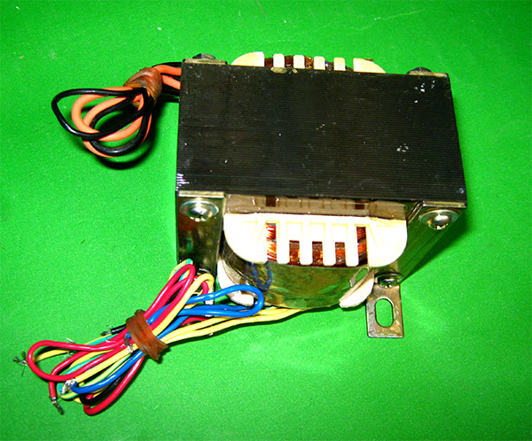

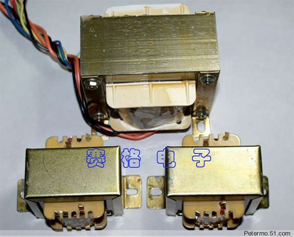

Power Supply£¬you know the power of tube amp is so important,We turn over the electronic market,can not find a suitable power,because the businessmen say they have never been done in this area of power£¬then we look for custom manufacturers

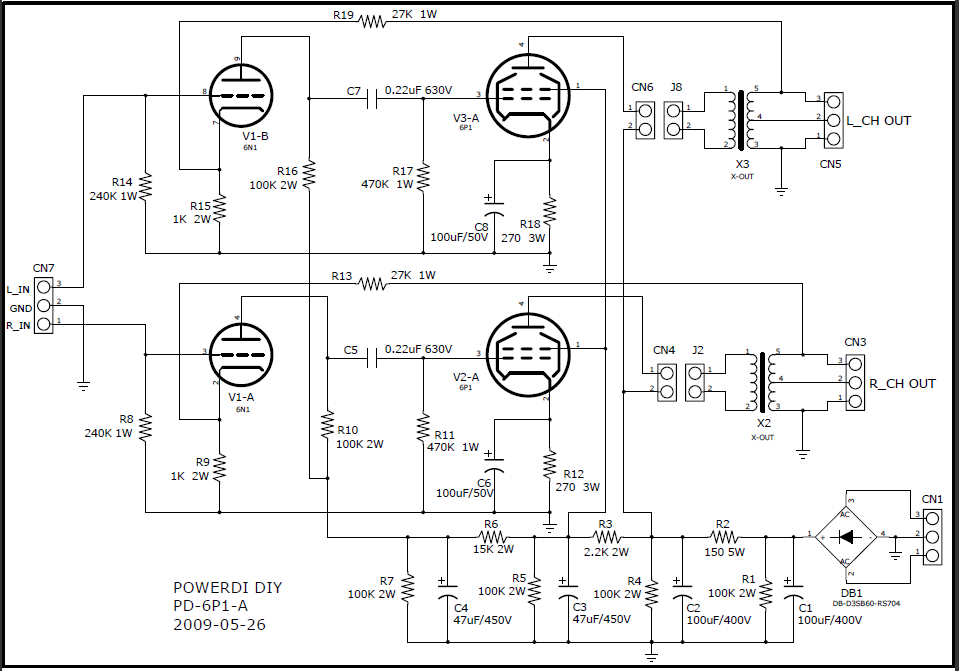

Sound of the amp is good£¬specifically in the treble£¬and performance in the bass is also good.
Integrated, we are very pleased.
It is an honor to hope that you make a suggestion 🙂

width£º262mm£¬ depth£º218mm £¬height£º128mm
Hi! Analysis of high pitch is clear. In the light music area£¬show good! I like metal band Linkin park and sum41£¬etc£¬I think our tube amp performance well£¬by the way£¬we are faced with in the low-end£¬But it is better to choose to upgrade the electronic components or add a tube pre-amplifier£¬can make better bass,We have tried

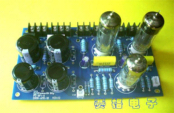

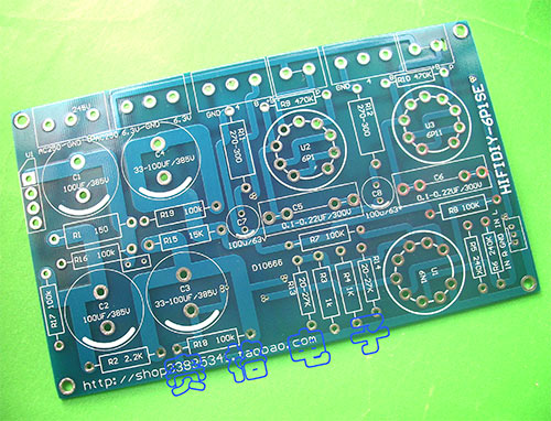

Hang, publishing the circuit diagram was a good idea, as it shows that you are genuine towards the DIY market. I wish you success.
Gordy said:Hang, publishing the circuit diagram was a good idea, as it shows that you are genuine towards the DIY market. I wish you success.
Thanks! I will do my best
