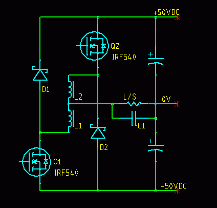

Well, things went a bit better than I had hoped. After I has sorted out a few pcb tracks that I had cut that I shouldn't have, messing up the earthing of the driver and output stages, I powered up the thing at it just went! No flames, no fuss. At first I only used +/- 10v rails on the mosfets just in case something was dreadfully wrong, and it sounded a bit dissapointing - very reminiscent of crossover distortion although it wasn't of course. Later on I got bolder (or more reckless) and in stages finally got the rails to +/- 35 volts, the limit of the supply I was using. By this time it was sounding heaps better. Switching frequency was 50Khz at first but I can crank it to something past 500kHz although it didn't seem to make a whole lot of difference to the sound.
The output inductors I used were 800uH each, 55 turns of 1.25mm wound on a Microlite MP4010PDGC toroid core. This core is made of a long strip of metal wound up like in a normal mains toroid, but is actually a distributed gap or something because it is meant specifically to handle a dc flux. Weird stuff. Output cap is just some 1uF 250v block thing; not really suitable actually. With these, the frequency response is -3dB @ 890 Hz (!) A bit more work to be done there. It sounds pretty much like an AM radio at this point, pleasant to listen to but by no means hi-fi. Would probaby be just fine for voice only PA use though. Winding the volume up, this amplifier is not afraid to get down and get with it; it keep saying "more, more" but it was 11:45 pm by this time so I had to keep it down a bit.
Power output is a bit limited at the moment because the current sense resistors in the fet source leds that go to the drivers are way too big so it cuts in too early. I can see right here and now, to make a top end amp using this aproach would be a huge job, but that was never my intention anyway. I *am* pleased.
P.S. Will try and post some pics tonight, about 8 hours or so from now - lunchtime 12:55 pm.

That should be "in the fet source leads" 🙄Circlotron said:the current sense resistors in the fet source leds that go to the drivers
Nuh, no feedback yet. Much fiddling remains to be done.phase_accurate said:If you have already implemented NFB then there's a simple explanation why it sounds better with the higher supply voltage:

Hi Lukas. Yes, that is basically the one I am using, only instead of two opamps making two out of phase signals that get fed to the comaprators, I am using a centre tapped transformer, the ends of which get fed to the comparators. This is just for the experimental setup so I can drive the transformer primary with whatever I like and also have isolation. I am using a UC3637 motor control pwm IC to do the job. The crummy sound I had at first turns out to be a crummy source, not the amp itself. Also I have changed the output filter cap from 1uF to 0.1 uF so it sounds a bit better now too.

Aren't you missing some of the possible switch combinations with the single transformer drive, as you will only be able to get the two combinations where one FET is one and the other off.
If you use their modulator, with 2 comparators, and separate drives to the FETs, you will get two more combinations where both are off and both are on, which should improve performance quite considerably.
Lukas

"Since the output devices don't operate linearly, no SOA protection is needed (only max current limiting, if any at all). "
You need a duty cycle limiter to prevent shoot through on clipping.
Motorola has an app note with a discrete design, Linear Technology has a driver IC with it built in.
