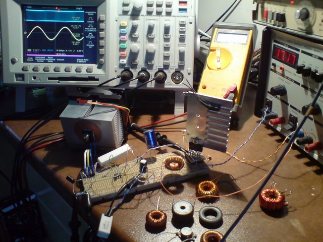

So now I have this parallel amp already crudely breadboarded. The lashup I made over the weekend consists of a mosfet follower stage biased to mid-rail and driving a high impedance (100 Ohm) load. An 8 Ohm speaker connects to this via a current sense resistor straddled by a comparator. This generates a bipolar error signal effectively flagging when current is flowing into, or out of, the follower - which really only serves as a voltage reference to be copied at the output. The real "heavy lifting" is acomplished by a half-bridge switched by the error signal and ballasted to the speaker via an inductor.

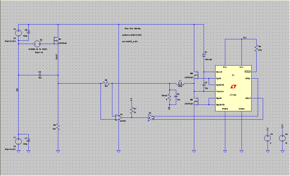

Attached is a schematic used to simulate the circuit although I have used a different bridge driver to the one shown. The principle of operation is really simple, and it certainly works. Of course the switching frequency is not constant and there are numerous trade-offs in terms of bandwidth and distortion. But the attraction to me is that there is a continuous analogue signal path all the way to the load - the Class A stage could also be a tube stage or AB or whatever but I just love the "no feedback" simplicity of a single transistor follower.
Do we think it would be possible to refine/optimise this configuration to achieve a worthwhile amplifier? Or is it only "all very well in theory"?

Have you considered modulating the current source on the basis
of drain current detected above M1? This drain current would be
amplified directly of any error voltage seen under the source. And
if the loop is tight enough, becomes an effective constant current
except what variations demanded by the signal into the load.
In the tube world, the suggested topology might be called a
White Cathode Follower... Search on those three words if you
need the history.
The end result should be mostly the same as the split sense
modulated switching source we discussed in the prior thread.
Except the sense resistor is out the way of the load and less
detriment to damping.
Now you can directly modulate the pulse width of the source
without regard to additional feedbacks, as M1 performs double
duty as the only voltage comparator you will need.

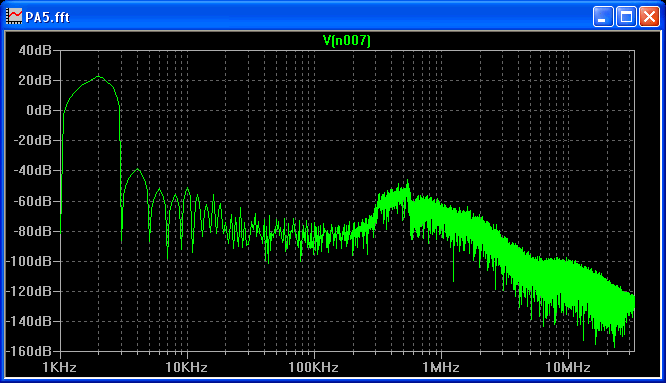

As a first step towards reducing the ripple I have added an error amplifier. The ripple is now around 60mv and, as far as simulation goes, is spread out at around 300 ~ 500KHz...
Note the even-order harmonics preserved in all their glory! The results are fairly repeatable on my breadboard, but the switching speeds are a bit strangled by the only H-bridge chip I have to hand (L6203). A LTspice simulation of the circuit incorporating an error amplifier is attached.

OMG this is too easy: I'm sat here in almost total disbelief ~ I have a delicious Class A sound emanating from a handful of parts and tepid heatsinks! The bridge chip is supposed to run motors for goodness sake.
I haven't trusted it it anything other than a battle-hardened Tannoy Lynx (3169G - 100W 8Ohm 12" high sensitivity Dual Concentric) so far - but it's producing sounds every bit as musical as my MF amps are capable of (on a good day). The Tannoy's yield 95dB @ 50 - 20kHz for 2.8V so my diminutive 35V supply isn't holding me back from a reasonable audition.
The next step I think is to swap the bridge chip for a pair of IRF540Z's and I'm thinking of letting an LTLT1160 do the driving. I can't see this being any slower than what I have now: "180ns Transition Times Driving 10,000pFn - Adaptive Non-overlapping Gate Drives Prevent
Shoot-Through" Sounds useful. The obvious downside is the 60V top-rail limit. ABS. Max is quoted as 75V ~ in a "protective environment" (i.e. with varistor clamps on the supply rail) I might just stretch it to 70V to get 75Watts into 8Ohms. Even at 60V I will have more poke than the A1 and about the same as the A120...
...Mumble now I'm wondering how to get to 100W to give the Tannoy's something to really chew on.

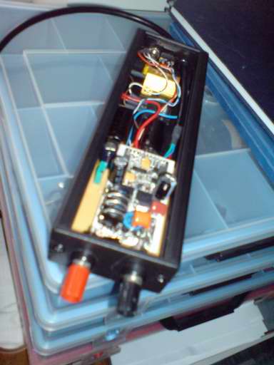

The experimental design is now boxed-up and running without any more tweaking. I've been comparing it with an old TRIPATH amp that I've got working again (see TRIPATH EB-TA0104 revisited ) and it's very much holding its own in terms of sound quality.
What I find seems to be the acid test for amps like these is playing around with an old analogue signal generator at high levels (only when the rest of the house is deserted!). At between 10KHz and my upper limit (13K and falling) fine-tuning the frequency reveals all the aliasing that happens as the carrier shifts with amplitude. Even at low amplitudes this has quite a nasty effect, but it's much more pronounced with the TRIPATH.

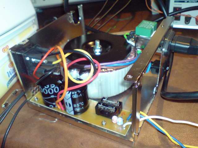

In the photos you can see an old ATX PSU case special dedicated to the trafo supply (I find these make great enclosures for quick-build projects like this) and the extruded case for the amp. It's a bit out of focus but the 100R 25 watt resistor that loads the follower is visible at the far end. Where the signal comes in there's a switch that controls the enable pin on the MOSFET driver chip and throwing this allows you to listen in pure "first watt" mode or with "Class D assistance". Unfortunately the only appreciable difference is a slight gain when Class D is used - presumably from the change in transconductance of the "unloaded" follower. Slightly louder always comes across as "better" but being critical it's not masking anything bad. I can't see why this approach isn't more popular!
