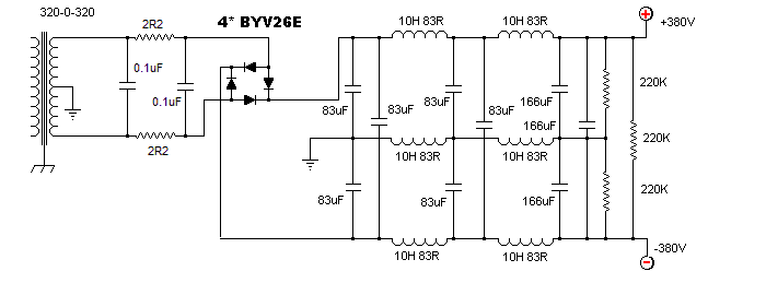

Here is the schematic of my latest design. It has a PP driver stage IT coupled into an 845 SE output stage. I had been given a pair of 845 and I wanted to use them in a two stage amp. I needed a voltage gain of about 90 from the driver stage. As the mu of the 6C45 is between 40 and 50, a push pull pair would nicely deliver the 90 times voltage gain.
I was worried by the chance of my son getting a 800Volt shock whilst probing the circuit so I decided on a + & - 400V supply for the output stage taking advantage of the ITs ability to isolate the ground structures throughout the amp.
I have just finished quick sketches of the amp and bipolar supply. This is an evolving breadboard at present so the values of components are changing...
All comments gratefully recieved.

Shifting ground
James,
I like the idea of the PP 6C45 to drive the 845, but I'm wondering about the power supply, and particularly about the inductors in the 0V rail. If the signal current from the + rail is different from the - rail, won't it cause a voltage to be superimposed on the 0V?
James,
EC8010,
There is that potential but that is the reason for the delta configuration of the psu capacitors. This way they can couple between whichever pair of rails the signal return appears in. I've started looking at 3-phase psu and how to arrange them and the design is based on that but I've only just started looking at the theory so I might be completely wrong!!!
The breadboard version that I have running doesn't have the earth line chokes as I ran out of them. It is working very well without so I might just drop the idea.

CHOKING ON CHOKES?
It would.
IMHO, a 3 phase is not what you want...you need a bipolar PSU so putting chokes in the + and - rail should do the trick nicely.
If you make both rails independent from eachother ( the purist approach) than you can move the choke into each earth return, no problem there as far as I can tell.
Cheers,😉
It would.
Cheers,😉

Hi Frank,
Your comments (and EC8010s) make sense and as it is working nicely without - I'm happy to give up the idea until I've thought through much more what I hope to acheive.

The bipolar psu for the 845 is great. I have got a brush contact shock from the B+ line and I was very glad it was at 380V rather than 760V - NOTE: my other hand was behind my back and all loose clothing was tied down - so my reaction to the shock took me clear of the amplifier

James
how does the input Cn ( neutralising capacitance) work?also how do I calculate the value for it? In your case the 6c45. From the diagram it look like the Cn is connected from grid of the first 6c45 to the anode of grid of the second 6c45 via the Cn and vice versa for the second tube.
For the capacitor value between ct of input transformer to ground u utilized 22uf. How did you come about to get this value? test and check for lower distortion? Also how does this cap tamed band resonances?
thanks for the help
thanks for the help
Nick,
The neutralising capacitors are there to help overcome the input capacitance of the triode by providing extra current drive at ac from a suitable in-phase point of the circuit. So it aims to 'neutralise' the input capacitance. In PP it's straight-forward to provide a suitable added current flow (positive feedback really). The value is found by experiement (according to all the text books) as there are too many variables to make calculation reliable. Start with the equivalent input capacitance and work away from that value... I wasn't after raising the frequency response of the amplifier (the original use) but wanted to avoid slew rate distortion. Since the pick off point also has the effect of the transformer imprinted on the signal it might help to offset some OPT resonance effects - pure serendipidy if it does - and in my case with cheap Xfmrs I think it does help.
The 22uF was arrived at by trial and error. Origonally I had the 22uF between IT CT and cathodes and 2uF between input IT and cathodes - I then swopped them and it sounded much better....
There has been conjecture in these pages that this can only be so if the 22uF is working against a resonance effect inthe input transformer. Checking with a scope looking at the 6C45 anode showed a resonance at abot 4.5Khz (fairly broad and about 4.5dB peak) that dissappeared with the 22 uF. I have not measure the IT and then modelled what is happening to understand this properly. I assume it is peculiar to my cheap transformers and topology but it works for me.
