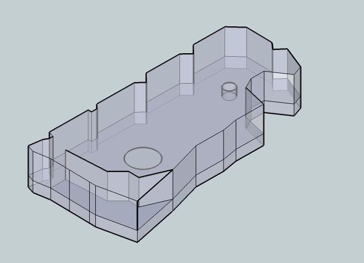

So, this is about a car subwoofer, specifically, the Porsche Boxster Bose box. The Boxster is a mid rear engine, 2 seats cabriolet, with no room for a decent subwoofer box. Porsche proposed as an option a Bose speaker system, with an enclosure that sits on the shelf on top of the engine, just behind the seats. When the top is down, the roof retracts on top of this box. The box is shallow, about 4".
I don't have picture of the box in the car, but here it is standing alone :
When we turn the box over, we can see the two 5.25" woofers :
When in the car, the woofer faces the engine shelf carpet, and thus there's only about 1/2" between the woofer and the carpet :
Inside the box :
Another view of one of the woofers :
I know the basic theory of closed, vented, passband subwoofer enclosures and I understand how they are designed given a speaker's T/S specs.
But here I don't understand how this particular enclosure is working, as the woofers basically face a wall, and I guess only rear waves are heard through the vent. Is this a passband enclosure with a very small front chamber?
Has anyone any clue on how this type of enclosure work?
The box pictured above is a friend's, not mine. I don't have this expensive option in my car, and I'd like to design my own subwoofer enclosure based on a similar design (because there's no room elsewhere in the car), but to do so I need to understand how it works. I guess this subwoofer will probably sounds like crap (the Bose one blurps more than it thumps) but it's a trade-off I'm willing to try.
Last question, would it be worthwhile to change the woofers in my friend's box? I guess he would have to estimate the T/S of the Bose speaker first, don't you think?

nope, I'm calling that box 6th order bandpass.. series tuned?
there is a port next to each woofer as well, so when the box is put on the carpeted shelf, you get another chamber infront of the woofers, thats vented into the main chamber the woofers are in :)
http://www.diysubwoofers.org/bnd/6thord4.htm
oh... wait.. the ports go the whole way though the box...
so, its just a standard 6th order... :)
yup, looks like typical schlock
from Bose...
it does look like a 6th order bandpass.

I'm not buying the 6th order bandpass. There is nothing to define a chamber, or a port. If anything, it's a standard vented box, with 'acoustic loading.' Measure the bose driver T/S params, and measure the amount of air in front of the driver, add that mass to your measured driver mass to modify your T/S. (search will turn up a great thread on adding mass to a 55-2421) Considering air is 1.2g/liter approx, and you have less than a liter of air in front of the driver, I suspect that the few hz of lower fs, accomplished by the acoustic loading would be inaudible vs if it were not there.

I disagree with 6th order bandpass aswell. They are two tuned chambers - one for each side of the driver. Putting the "woofers" to the carpet would give a similar effect to slot loading a driver, which reduces excursion. If the carpet blocks it completely, it's a 4th order bandpass.
TBH, I'd class it as a 4th order bandpass with pass ive radiator. The --unbraced-- plastic cabinet would happily ring along, like a PR.
Joking aside, out of the car, it's a simple, vented box. In the car, it would appear to be either an acoustically damped vented, or 4th order bandpass, dependant on if there's a route for the front of the "woofer" to your ears.

FWIW, when I looked at the photos the other day I saw a rather innovatively laid out, high tuned (small front chamber) 6th order BP once secured/sealed to a surface with a pair of high Fs 'full-range' drivers to presumably add some surround ambiance and after taking a 'fresh' look just now I still believe it is. IOW, other than the layout, just another typical B@$3 alignment.

Two things that could be important. In the Bose box, the holes next to the woofers (red arrow) are not vents, there are sealed and are there for locking the box onto the shelf.
If the front chamber is actually vented, it is then through the 3" grills in front of the box (yellow arrow) but then the waves would have to travel through a very narrow channel (at the right of the yellow arrow) :

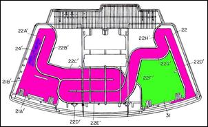

Arno,
1. I dont hink the 3" vent is for the bass. The 3" vent might well be for the 2.5" 'wide-range' also included as part of this system.
2. I suspect this is a variation of Bose 'wave-guide' system as used by their 'wave-guide' radio
http://autospeed.com/cms/title_The-Bose-Wave-Radio/A_1372/article.html
3. Do not be constrained by the shallowness of the box. Dan Wiggins and ADI were able to design a 10" woofer that might be useable (thought the Qts seems a bit low for IB).
http://stereointegrity.com/forums/2645-post7.html
http://www.acousticdev.com/cms/inde...t-sub-woofer&catid=38:uncategorized&Itemid=60
Your best bet would be to fabricate a fiberglass box that is maybe a bit deeper and hence has more volume for maybe 2 6-8" woofers. Used in conjection with the W3-871, CHR70, FF85K or other such 3" wide range you should be able to produce better sound than Bose. Enjoy.
Just do not expect this system to do Trance, House, or Hip-Hop at loud volumes. For Jazz, Rock, Blues, etc.. it will do fine.
