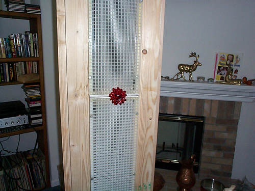

Actually, the stand is going to nearly triple in width by the time I'm done. Right now, we're just in Phase I ("Collect Underpants!"). I'll fire the subwoofers back up in a week or two; I want to get a better handle on what the ESLs are doing before I redo the crossover to the woofers. A line source of 15 or so 5" drivers per side, used as dipoles and integrated into the baffle, is in the works. One fun thing was redoing some of the conductive traces on the diaphragms without disassembling the stators.

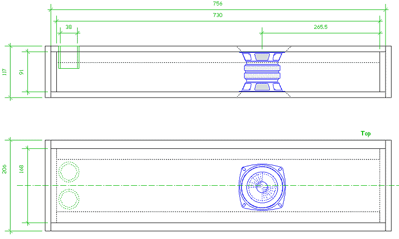

planet10 said:
With 2 midbasses i will do a bi-pole before i do an MTM
How would you approach that, as push pull or or two separate enclosures with drivers in front and back? I'm thinking about similar project and frankly, MTM doesn't appeal to me anymore. Especially, when I'm using only than 1st order crossovers.
Peter Daniel said:How would you approach that, as push pull or or two separate enclosures with drivers in front and back? I'm thinking about similar project and frankly, MTM doesn't appeal to me anymore. Especially, when I'm using only than 1st order crossovers. [/
Here is a drawing of a bipolar centre channel we are just finishing up -- the tweeter is not shown. The drivers are not shielded so the magnet-to-magnet configuration is a contraint on the design -- as an ML-TL so are the length & the cross-section. This is one of the reasons the drivers are mounted from behind the baffle.
Magnet-to-magnet is ideal in terms of maximizing the push-push effect but other considerations will often mean you have to connect the magnets with an intervening piece of hard-wood or metal (anyone want to bet on the use of Al if PD goes this route?). A common cabinet is preferred -- gives the drivers more distance before 1st reflections get back to the cone.
The big advantages are the push-push effect & no bafflestep. The "disadvantage" is that the back of the speaker has to be out into the room -- depending on the room you may or may-not roll-off the back driver at or slightly above the BS frequency.
dave
PS: the progenitor of my move towards push-push bi-poles is the TLb.
dave

I showed these pics to my wife
all of a sudden I don't seem so bad... thanks
Always happy to assist. The nice carpenter-built frames will come along when my wife gets her next raise. 😉
Do they work? Yep. A bit of panel refurbishment here and there, some rewiring of the transformer boxes, a few blow-ups as I learned how to measure the frequency response of the electrical signal applied to the panels, and a good idea but a practical dead end for the frame design... anyway, the temporary lash-up sounds pretty good.
The fence does no good against our five cats, but effectively keeps my 2-year-old's fingers off the diaphragms. The cats learned day one, the hard way, to give these a wide berth. My kid is somewhat stupider than my cats and needs protection.
