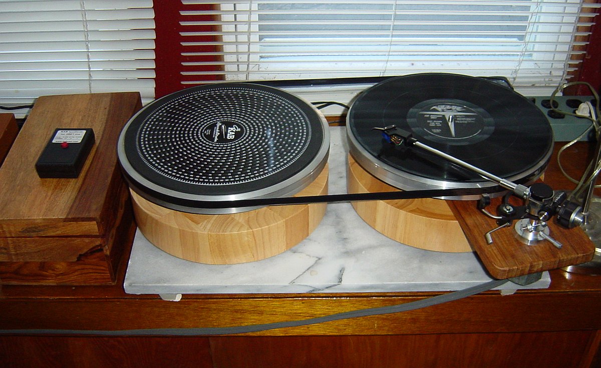

Here is what I have been up to. Using a Technics SL-1700mk2 (same thing as SL-1600mk2 & SL-1800mk2 with different auto functions and same motor as SL-1200mk2) belt driving an Empire 208 platter and bearing housed in a butcher block with Audiocraft AC300 tonearm and Denon DL-103 cartridge. Let's just think of the Technics as a giant motor pod with an extremely accurate and silent motor. The speed/pitch adjustment is handy to compensate the discrepancy between the two platters diameter. Practically this will work for any belt drive turntable.
I love the Papst motor from the Empire but it's simply not quiet enough and the fan noise is a nuisance. Those belt-drive Teres owners take note. Your motor might be great but give this "big" motor try. You might like it. Belt is from VHS tape and works much better than dental floss or similar material. I might try 8mm or 16mm film as it does not stretch at all. The less elastic the material the cleaner the sound which of course really depends on the quality your motor. No more rubber belts for me. Let the motor drive the platter and not the other way around.
Before anyone spend their big bucks on the next manufacture "upgrade" on a new motor or whatever for their high end turntable, do you self a favor and go get a decent direct-drive turntable with pitch control and tape drive your platter. SL-1200mk2 is perfect and if you don't like it, you can always resell it easily. The only hitch is that it takes up a lot of table space. I seriously consider building something more compact to house the DD motor assembly and electronics all underneath the platter so it's 12"x12" square size or a circle. Since the Technics platter is beveled at the edge and has strobe marks, I have to use another platter on top as adapter plate for the tape to ride on. If the active platter and passive platter is the same diameter then pitch control is not necessary - a Lenco platter stack on top of a DD table tape driving a passive Lenco platter will work!
How does it sound? EVERYTHING is cleaner and more refined. Quiet, smooth, and most important accurate. It spins and works how a turntable should be! I will spare you the pornographic adjectives. It's a TURN-table and, in this set up, it turns accurately, steadily, and quietly, and therefore, sings beautifully. It does not have the clinical or sterile sound people complain about the Technics. The VHS tape probably smooths out that last bit of microscopic rotational irregularities. To me driving the platter with a rubber belt only hides the problem with motor, its noise and speed drift or cogging. A direct drive turntable is NOT noisy, as the motor is running at 33rpm, that is HALF HERTZ. Put a stethoscope on the turntable or motor, I hear nothing. Well, except the noise from the power transformer, so there's still room for improvement. Now, a vintage AC motor like the Papst or Ashland, as great as they are, runs at 1800rpm and that's 30hz! You bet you can feel and hear the noise. The tiny bit of compliance, ie, the tape, between a DD table and a passive platter takes care of the last bit impurity in the rotation. The motor is so quiet that I actually hear more of the noise from the Empire's bearing. I probably need to put new oil in the old clunker. So, with this set up the bearing quality becomes paramount.
I am curious how this will sound on a Teres turntable as they are known for the quality bearing or any other quality turntables for that matter, especially those turntable that has a separate motor pod. Those who have tried it, let me know your result. Don't forget there are other great DD tables there so you might get an even better sound but the Technics is cheap and has high torque and great speed stability so it works for me.

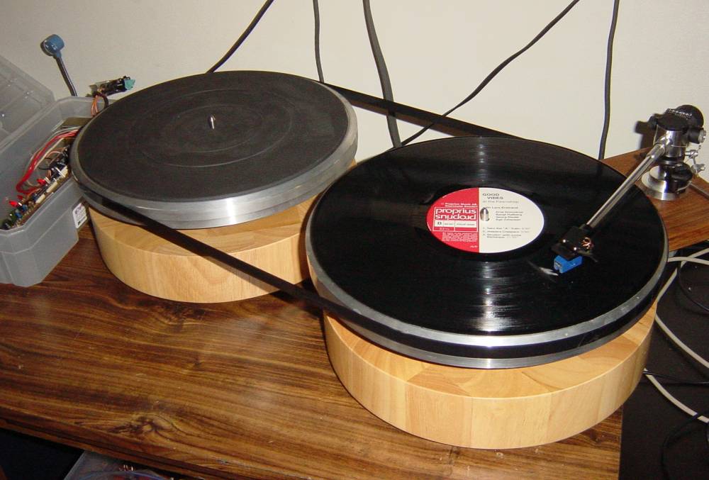

Here is a second experiment. This is something I've been wanting to do, using two identical platters from one direct-drive motor active platter VHS tape driving a passive platter. I can compare the sound of passive platter which is belt-drive genre and if I connect it to the power supply then it becomes a direct drive genre. Same tonearm and cartridge. Bother motors and platters are from Pioneer PL-L1000 turntables that have inverted bearings which is advantageous for belt-driving purpose.
The VHS tape is so thin that it presents no platter discrepancy between platters and requires no speed adjustment. It is running with quartz lock and the speed of the passive platter is dead on. Once set up, it's not that fiddly. Pretty straight forward.
Tonearm is Audiocraft AC-300 and cartridge is an Audioquest MC-3 high output MC cartridge.
- - - - - - - Sound Report - - - - - - - -
I first listened to VHS tape-drive and the sound is extremely pristine, pure and clean. Details are so clear and transparent that hear all the outline of the sound objects and instruments. There's delicacy to the sound with no fussiness. Everything is solid and sculpted. One very noticeable thing is that imaging is very stable compare to typical rubber belt drive - I don't think I can ever go back to a stretchy rubber belt - well, unless the motor is really noisy and jerky the elasticity might smooth out the jitters. Bass is dynamic but not as fat or bloated as idler drive. Quite honestly, the sound is so pure that I am not missing idler drive much now - but who knows if I add an idler wheel as the interface between two platters things might be different. Overall I am quite happy with the sound. The one thing I like the most is that there's no sense of overhang like those super heavy platter belt-drive table that sounded like something is dragging its feet. This set up is light footed and extremely quick in transient and response. Violin sounds silk smooth with no grain and extended without glaring or steely sounding. I like it.
Next is direct-drive but to be fair I still have the passive platter attache via the VHS tape so it might have added some damping to platter movement. Well, the sound is DIRECT. Everything sounds louder! Weird. The bass is bigger and more forward - goes to prove that the more direct coupling and less compliance helps bass dynamic. When it comes tobass, direct drive reign supreme. All the details are even more vivid as if they have been enhanced, like Photoshop enhanced detail, slightly unnatural. Hyper detail and things are more thrusting at the listener and in your face. A very exciting presentation. It's great for pop and electronic music. I might have exaggerated the sound a touch just to differentiate the sound from the tape-drive above. Other than the bass, things are very subtle compare to above. The bass is unquestionably bigger and stronger than tape-drive. I like this too but the tape-drive wins it by a nose hair. Your choice of music and system equipment might lead to different conclusion.
Once again, this is direct drive compare to TAPE drive, VHS tape in particular, and has nothing to do with rubber belt-drive which is a whole different sound and I don't have a long rubber belt to do a comparison. If you have one, let me know. But quite frankly I have no interest in ever listening to rubber belt again. If your system needs a rubber belt to sound good than there might be a problem with the motor.
Happy listening!

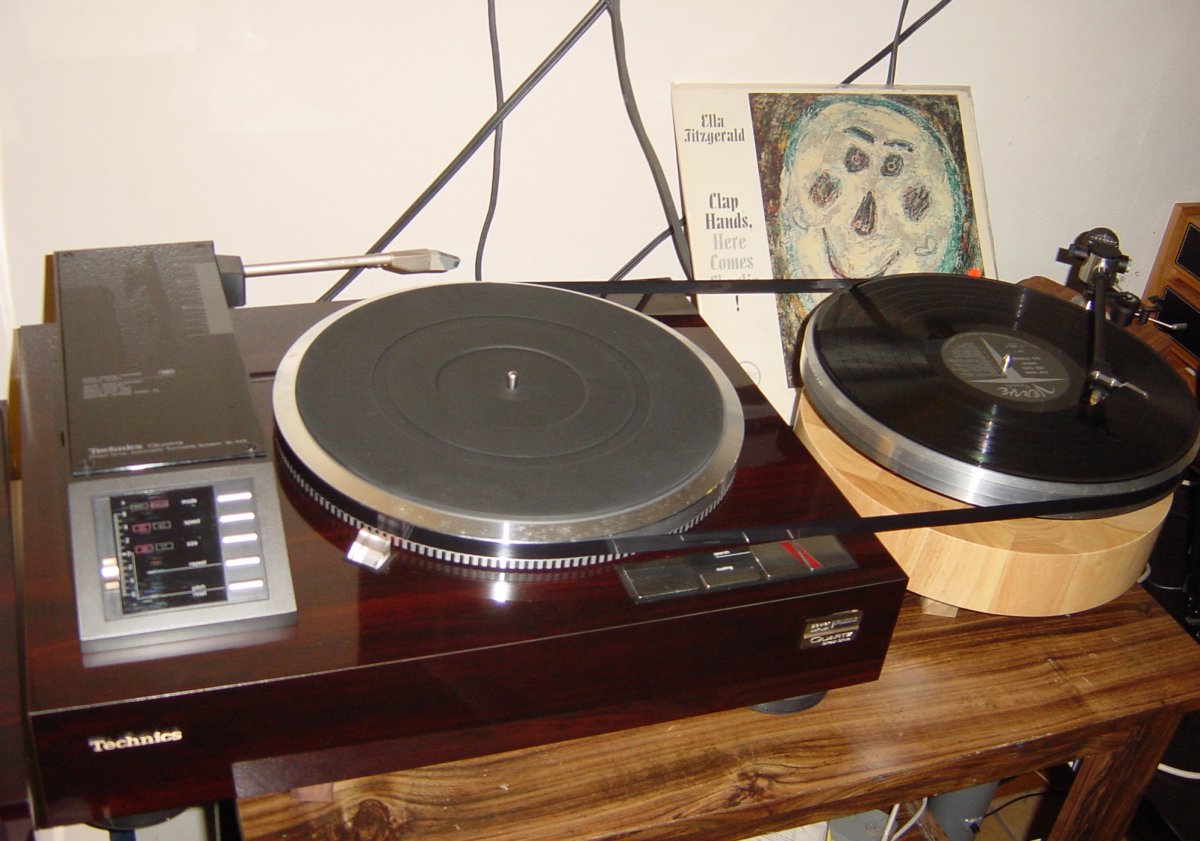

The torque on the the Technics is very high second only to the SP10mk2. It is essentially the same motor in the ubiquitous SL-1200mk2. The only other Technics tables that would work in this scheme without using an adaptor plate for the belt are SL-M3 and SL-M2 because their platters have flat circumference for riding the tape. The main criterion is that the table must have pitch control to adjust speed to compensate the platter diameter differences.
The Pioneer PL-570 or PL-550 works great too. I've been using two identical platters and motors from the PL-L1000 without speed adjustment. Less torque than Technics but super reliable without any of the motor going backward or super fast nonsense. Sounds great too. Not as forceful as the Technis but a touch more delicate. I will list a bunch of good candidates for this type of operation in the future.
I have completely lost interest in the traditional way of driving the platter using a small motor. I even sold all my Papst motors. Once you tried to drive your platter using another platter, you will not want to go back. As long as you have table space, try it!

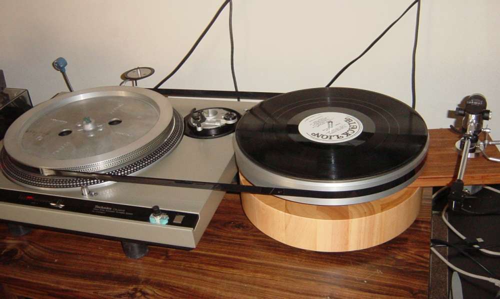

First one is using a Technics SL-M3 tape-driving a passive platter via VHS tape.

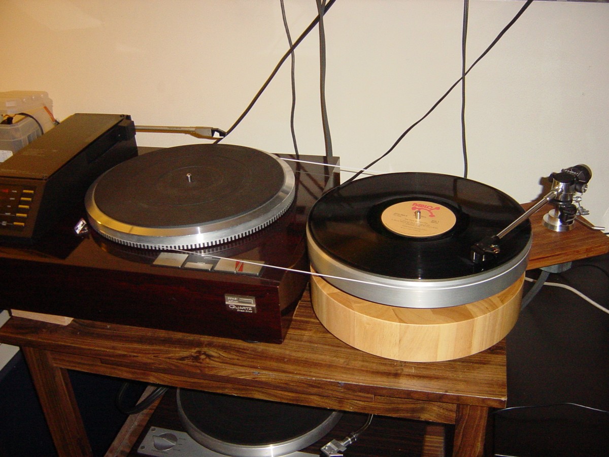

Second one is using another Technics SL-M3 thread-driving a platter via dental floss.

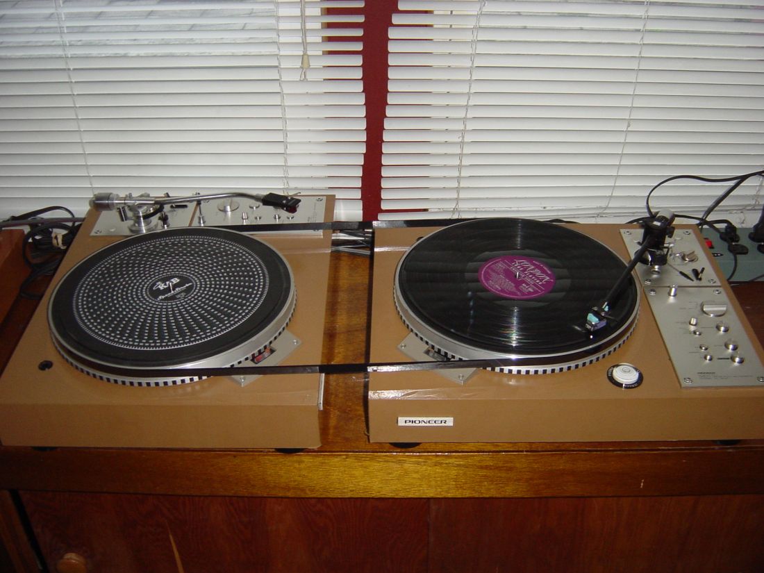

Third one is using two identical Pioneer PL-570 turntables tape-driving each other via VHS tape.

The easiest for people to try is to find an easily available direct-drive turntable with high torque such as Technics SL-1200mk2, either used or new unit and find a flat edge platter and place on top of the Technics upside down and use it as a adapter plate or pulley. And voila, you have a world class belt-drive motor that can compete with many high end products out there. And if you don't like it, it's easy to sell the SL-1200mk2 online. No loss. I can take this kind of set up and confidently challenge any VPI motor set up out there. Again, the only problem for many people is table space.
