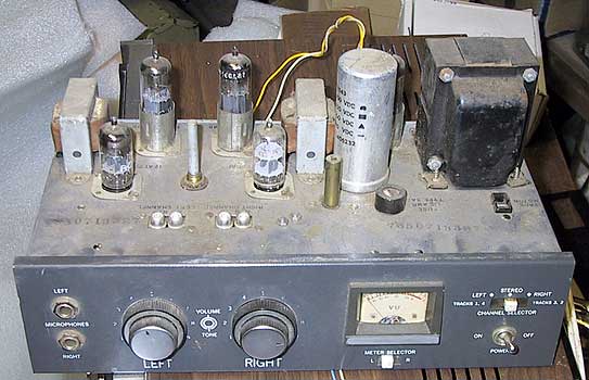

A couple of my 6BM8 SE projects should come in at less than half as much as yours -- i scored 2 Roberts R-Rs with 6BM8 amps in them for $40 CAD with all but rectifiers & an odd resistor coming from salvaged parts -- i don't know how the iron on the Roberts compares, perhaps the picture might give some indication (the other unit actually has a little nicer looking parts). My CalRad has even nicer iron and will run closer to your $75 when done.

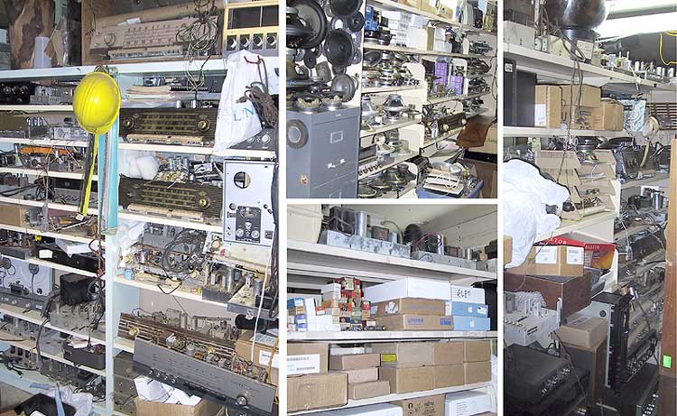

Dave,
You seem to be running a small museum...
In Europe it's become virtually impossible to get hold of little gems like that....well, not at garage sale prices anyway.
Cheers,;)
frugal-phile™
Joined 2001
Re: POOOFFF...
Not much is in museum quality :) The stuff keeps turning up. The SE ELL80 amp in the bottom right of the pic with the yellow hard-hat showed up this week (and the one in the top-middle of the same frame is a PP ELL80).
dave
diyAudio Senior Member
Joined 2002
ELL80?
As far as the ELL80 goes, I hope it's in good condition for it's merely vanished of the face of the earth.
Just from memory, I think it was a pair of EL90s or 95s? under one hood...really unobtainium territory for the past twenty years already...

I know. The ELL80s out of the PP went up on eBay right away -- paid for the amp. I have 2 ELL80s now which i am saving for a double diode, double triode, double pentode amp in a little perspex chassis.
The other iron will get used with either EL95s* or 6BM8s. *i have one of the ELL80 amps indicated where the factory added a dual EL95 daugher board.
Oh, and than there was the ECLL800 containg 1/2 of a 12AX7A as well...
I have a couple of those too. The triode is actually for a unity gain common cathode stage to invert the signal going to one of the pentodes -- an entire 8W PP amp in a singlr tube.
Brett said:
Is that your 'shed' Dave?
I don't feel so bad about my collection of stuff now. :)
No it was the garage (ie downstairs -- now called the lab). the Shed's have stuff in them that i am less worried about the wheather damaging them.
dave
