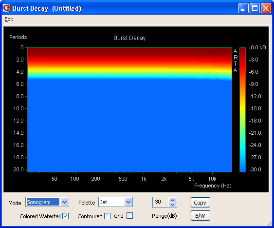

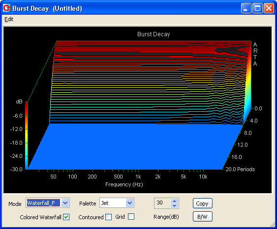

I did some measurements with monopole and dipole bass in a room.
Particularly I try to pay attention to temporal behaviour since as I believe steady state measurements in this case are pretty useless when considering human perception. Also I try to match the measurement excitation signal to represent the final situation, that is music.
Music is no impulse nor steady state sinusoid, thus I'm using short tone bursts with shaped envelope. It will give quite good visuality to what is happening in the room due the reflections.
I plotted some spectrograms. Note the horisontal axis is the time in periods. Vertical axis is frequency.
Also note that each frequency the maximum value of the burst envelope is normalised to 0dB. In this way it is possible to compare the room responses in perceptual sense since each frequency the amplitude is the same.

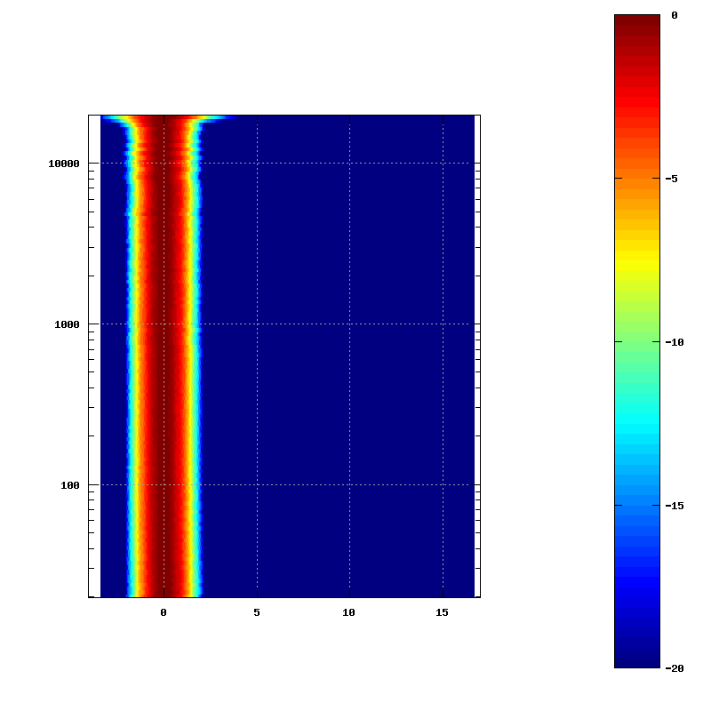

To start here's the ideal case for a reference, response of a laptop soundcard:

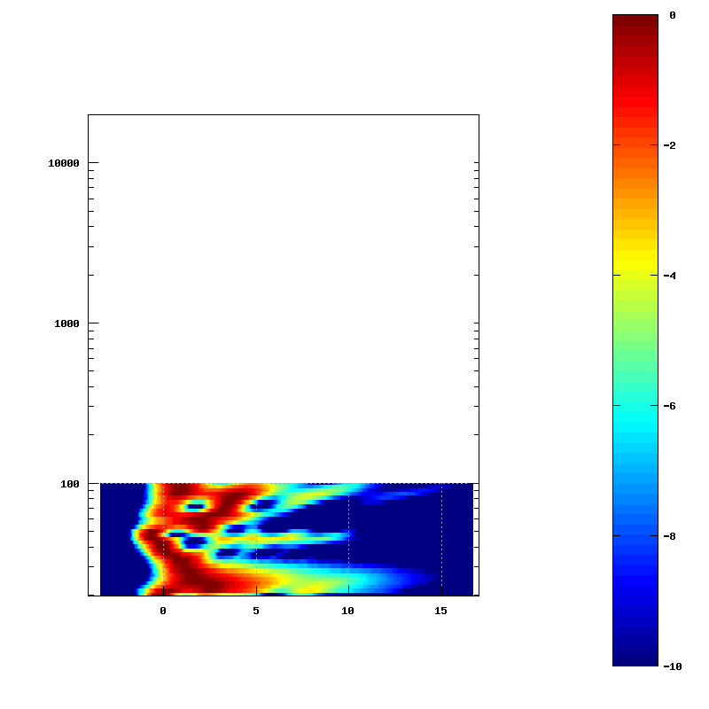

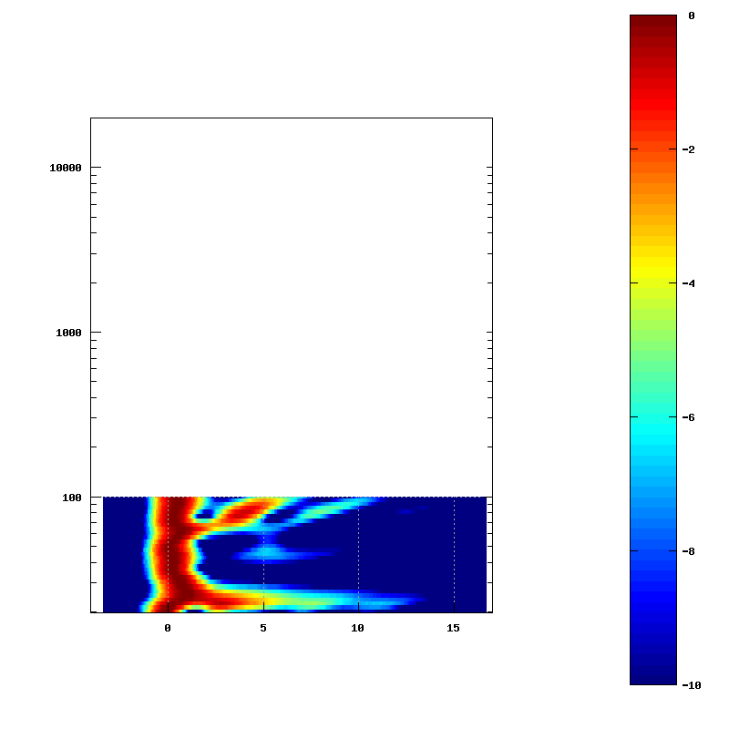

From these measurements it can be said that in the case of the dipole the time the envelope maximum occurs follows quite well the original envelope, but in the case of the monopole the envelope maximum occurs in almost a randomly manner. With monopole at some freqs the envelope maximum and thus the energy that reaches the listener is delayed - it has a poor energy delay (if one not like to use the term group delay).
Is this a reason for a perceived 'slow bass'? In this sense the dipole is 'faster' - the energy delay is smaller.
The beauty of using this excitation signal is you can listen how the room sounds like while doing the measurement. I can state that comparing dipole and monopole in this room one can hear big difference. I think in this case the visualisation yields the same result as the ear hears: In the case of the dipole the bass notes are clearly separated and it is easy to follw the bass line, whereas in the case of the monopole the bass sounds like it's never going to die out and the bass line is mudded.

Great to see some measurements.
However -10dB is not that interesting as "direct sound" is what you mostly get. -40dB is a lot more useful. -60dB even more so. RT60 and all.
10ms is only 3,4m so you can't really tell me that you are showing any "in room" response.

Take a another look at equal loudness contours at bass frequencies. 10dB is a huge perceived difference. 60dB dynamic range at bass in a small room is a wishfull thinking only - the signal has to go above pain level to achieve that.
And I think RT60 is not much of a use in small rooms.
Note again that the time axis is in periods, not linear time!
