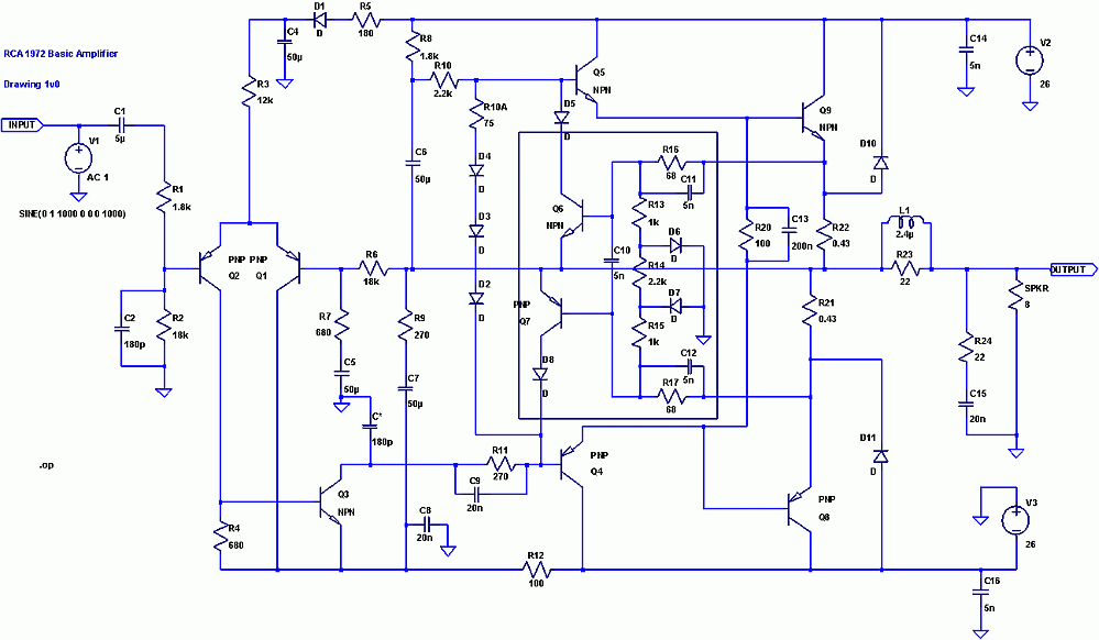

Looking recently for information to construct a simple set of amplifiers to complete my HTPC amp , I attempted to discuss the issue on the DX thread.
Since I was forced to modify the layout because of my application (stealth amp retrofit) , I could not use the DX board. I also have a surplus of 2sa992's , mje/ and other on- semi devices.
The amp in question was originally an RCA application note (1972)...
http://www.hilberink.nl/amps/amps2.htm
As most of us know , this is the "original" .. skillfully upgraded and modified by "uncle charlie" , aksa , and too many others to count.
Also very interesting is that on the other pages (link above), many of our DIY SS amps found their beginnings in these RCA designs.
This thread is to address ALL modifications that are possible to this simple topology (even minor ones). In other threads it was suggested
that the use of new high Ft devices would render both the sound and stability of this amp unusable AND that if a constructor does modifications,
strays from the path,or asks questions, they will learn nothing !! 😕
I know this to be false , as many clones of the RCA exist of world class performance that DO use modern parts. (I already have 2 that are 1 year old 🙂 )

NO intention of adding any "fancy" things here. Just basic reverse engineering. The only thing might be a CCS. the DX's zener "acts" as a crude CCS , rejecting "garbage" from the positive rail. The RCA's diode/R - C also decouples the LTP from the "garbage"(rail).
Also , when you built the RCA , you used the 3 diodes instead of a proper Vbe , which made for bad sound (Xover distortion).

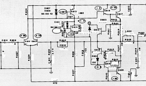

Have you seen this errata ?

Well , here is the amp that is supposed to oscillate :hot: .. 🙄
I have 2 of the the NPN LTP version (not as refined), not a problem for a year. Attached is a FULL (models included) .ASC for the above schema. Not a PPM amp , just 9 devices.
A few posts later , either me or BG will "doodle" the original. I also have a PCB layout in the works with integrated DC supply. At 5.5" X 3.5" , it will leave nothing else to build... just hook up the trafo - and enjoy..

Thank you, my friend. I see (learned)2 things from your schema (the diodes on the VAS and Vbe).
They seem to be "insurance" to make the design foolproof (2 are thermal for cfp OP - better than P3A).

Here's the schematic into spice, please check for errors. Then I will post the actual file.
It doesn't work as-is because it uses default library for the active devices and so it isn't going to balance. Check it first - but I think the LTP is so out of balance that this must be fixed.

By Bigun -Here's the schematic into spice, please check for errors. Then I will post the actual file.
Looks correct , Gareth. 🙂
I will find the closest devices to the RCA's that I can and post a .ZIP with their models.
On the topic of high output distortion , after that 2/3rd's "point" THD
stays .1% all the way up to actual clipping and is almost exclusively H2 in content. I suspect this is the reason for the pleasant bass or the perception of "better bass" , especially at high levels.
I "looked" into the bootstrap cap as I increased the level and saw both phase and level changes within. It should be cool to see the plot of this while stepping the input. (next)
