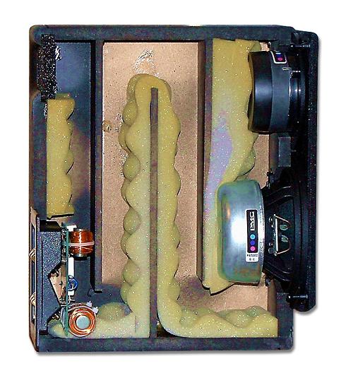

Does anyone have enough insight to suggest how it might be possible to make a clone of this speaker ?
http://www.pmc-speakers.com/docs/145af95710b4df_DB1-C.pdf
The claim is that this is a TL design in a bookshelf sized box ?
(I have a pair of FB1's and they are really nice).

planet10 said:Here is a dimensioned drawing based on the pdf of post 2.
Perhaps someone with MJK could model the line (assumming that the drive ris a stock VIFA and not a custom OEM)
dave

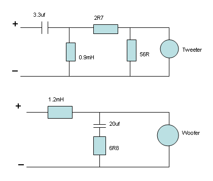

Joined 2009
oh my gosh, clones they do have !
http://www.ornec.com/Von_Masoch_TB2_Bookshelf_speakers_QQC100111A
If TL demands quite different drive unit parameters compared with a standard unit and many of PMC's drive units are actually custom designs produced with significantly different specifications then these clones are probably not like the real thing.
I wonder if there's even a TL inside the box
anyhow, getting more information as I search.
Attached is the XO design...

Did anyone check this out before ?
http://vids.myspace.com/index.cfm?fuseaction=vids.individual&VideoID=55250566
A video by PMC talking about their TL technology. Some of the claims include a special foam filling that works over a broader frequency range than what other people use and allows them to retain the performance over a wider volume range too.
Any thoughts on what is special about the foam and whether I could find something suitable to use for my own design ?
