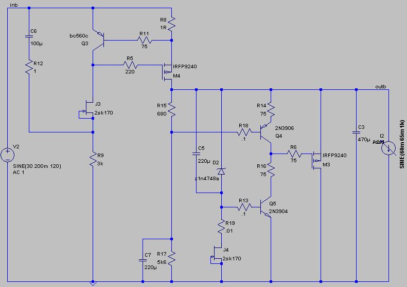

I'd like to start a thread on this simple but IMHO very good design. Various changes have appeared in various places but it would be nice to have a thread dedicated solely to this subject. Here is the original schematic, and as time goes, we'll get a pcb for it and/or variations. A number of people have implemented this regulator and have praised it. Please share your experiences if you've done it, so others can benefit from it.
attachment.php
There is a long thread about the jfet phono stage also designed by salas, which can be found in the following link
http://www.diyaudio.com/forums/showthread.php?postid=1665552#post1665552
in which the regulator was introduced first. If there are any people well versed in pcb design and would like to help, please step up.
Personally, I have implemented a few variations and can say that its performance, as far as I can tell, is very good. Besides that, it seems very stable (not prone to oscillating), easy to build, and with a low parts count.

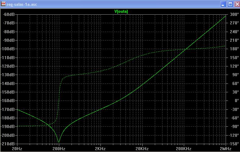

salas, thanks for pointing that out. I was planning to post all of the variations, perhaps with some simulated results (ripple rejection and output impedance bode plots) so people can see the differences. I'll do that as I get time.

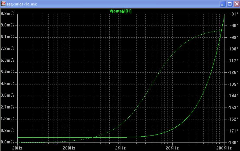

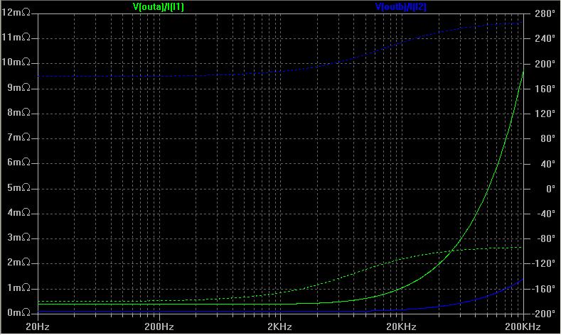

However, tweakanitis is a heavy burden for one to bear, and personally am heavily infected. The variation shown below offers a slightly better output impedance in the higher frequency, including audible range. In the bode plots below V(outa) is the circuit of post #8, and V(outb) is the circuit below. Note that higher idle current results in lower output impedance across the (almost) entire frequency spectrum.
Note, this is highly experimental and AFAIK this circuit has not been implemented yet. So, with a 1R resistor, the shunt mosfet passes 676mA, and is supposed to dissipate about 15W. We can perhaps agree that one that is willing to do this may not be all there in the sanity department, but hey, I am planning to try it out soon.

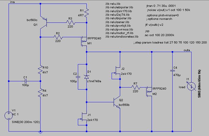

Using the Circuit above on your post #8 as the starting point, (and let's see if we can stick with the same component numbers all the time) there are a few questions to include some variations already tried.
1. One pcb for + and - rails?
2. Using inverted 2skk170s rather than j74? or other devices, pinouts?
3. pads for a k170 option for R10?
4. extra Resistor as per your new Cct in series with C1 or is that a SIM thing?
5. Is there a Resistor between j1 source and 0v?
6. Is there to be a Resistor between the Shunt M2 and 0v?
I would like a small adjustment to the voltage - about 0.5 volts to compensate for zeners, correct for amp offset, etc, etc. Would a small pot (50R?) between zener and rail stuff up the performance?
Could you check this out with your magic circuit cruncher thing!!
