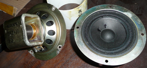

BTW, Dave and I discovered that the holey baskets come in a number of variants, including a black-coned one! (Mine are 8 ohm, SONY-badged)

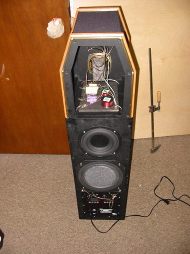

Those were a little experiment I did without using a formula. This is what the inside looks like except that I didn't leave room to show the back panel of the cabinet. You'll have to imagine it's there. 😉
The result tells my ears the line is too long. They are shy on bass.
I have enough Coral HB's to make the BD-pipes, but I also have 2 pair of Sanyo FE103A's. When I eventually get time I'll swap those in for a comparison.

Oops, that last post was for another thread. The design of the bi amped 4 way includes two cabinets in one, the front being the 3 way with a 100Hz cut off, and the Coral running OB at 1000Hz. The back of the cabinet is the woofer, PR and plate amp. The shot you see is an old one when I was trying out the Foster 10F3's you see in the boxes a couple of posts up.

Here's a picture of my black holey baskets ...

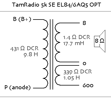

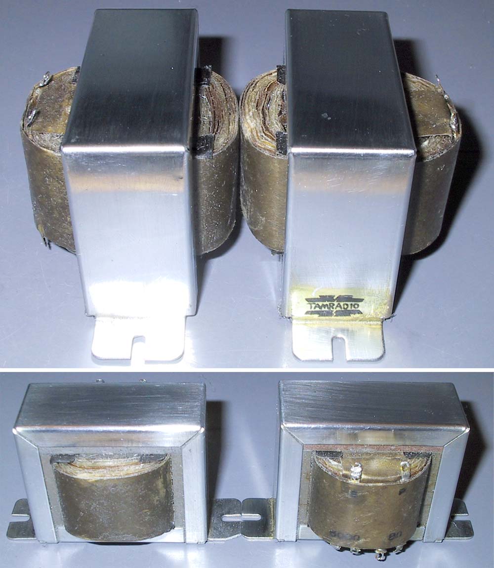

I'm enjoying a pair of Corals from a 500A. Now I would like to use the rest of the goodies to build a SE guitar amp. Can someone help me understand the windings for these Sony Opts? I used the AC voltage test to measure the secondary windings. One pair appears to be about 8K and the other to low to measure. I assume I'll use the 8k secondary for my project but would like to know what the purpose of the other winding was in the reel to reel.
