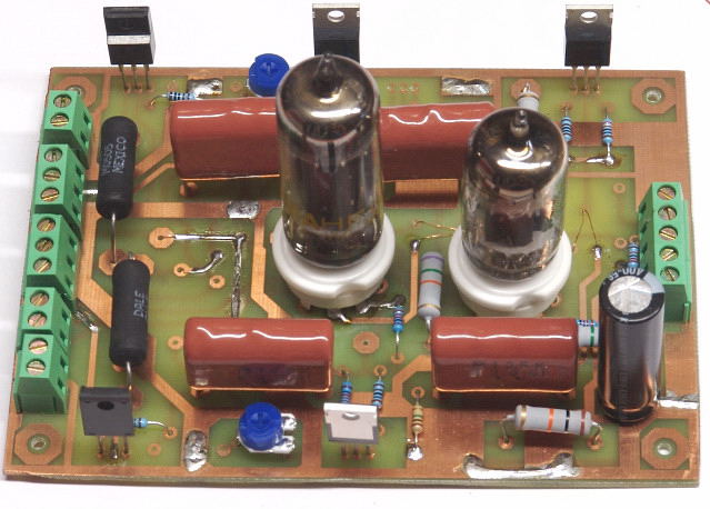

I started laying out a PC board for my "universal driver" design while I was sitting around a hospital in Pittsburgh waiting for my mother in law's chemo treatments (late December).
I finished the lay out in a hotel room in Georgia on my trip home (December29).
I made two "home cooked" PC boards right before I had to go back to work in January.
I started populating one board in early January. Then Sherri had to go back up north, tasks started piling up, my job started demanding long hours, so the board sat on the shelf unfinished.
Today was the first day that I have had a few hours of spare time this year, so I got the unfinished board off of the shelf and started soldering.
I put all of the parts necessary for testing on the board. Everything looked OK so I hooked it up. Nothing, NADA, zip, not even heater glow. I had 6.5 volts right on the pins of the tubes, but nothing. This sickening feeling came over me. When I realized what had happened, I strongly resisted the temptation to throw the board into the trash, or worse!
Back when I made the board, I had swapped the top and bottom transparencies. The board is a mirror image of what it is supposed to be. Which brings me to one of the first rules of laying out a PC board. ALWAYS put some text on the board somewhere on EACH layer. I was in a hurry when I laid out this board, so I left the text off. Text would have made it obvious that the board was mirrored.
So now I can toss the board in the trash, nuke it in the microwave, run it over with the truck, or try to salvage it. If I had to choose right now I would nuke it, but that really stinks up the house, so I cracked open a Bud Light instead. I may have some time to deal with it tomorrow. It may be possible to remove the tube sockets and semiconductors and put them on the back side of the board.
I have about 10 days until I must travel back to West Virginia to help with Sherri's mother. I will be gone for about 10 days which will put me behind again, so tube time will be limited. On the bright side if I time it right, I might get a day or two to hit the Dayton Hamfest. It is the biggest electronics flea market in the world (or so they say).

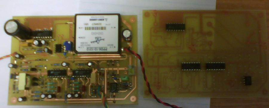

I've had a few bad days, too. I used to lay out boards using rub-on resist pads and rub-a-dub marker (it works if the PCB copper is 1 oz or thinner - otherwise you get pinholes). I went all the way through the process of laying out and etching the board (a hybrid amp using the UA739 IC), then realized everything was mirror imaged. Duh...
My board maker will not accept any layout unless there is text to identify the layers. Guess they learned the hard way as well...

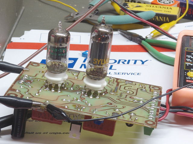

Last night I was rather disapointed by my stupidity and almost tossed the board. Today I had to prepare our 8 year old vehicle for a 2500 mile trip. While I was underneath the car I was thinking about the board and two blonde brain cells must have got together and ignited a spark. I didn't need to rip the board apart, I didn't even need to take the tube sockets out. I could just tack solder two more sockets on the back of the board. The CCS chips have 3 pins. The center one is the input and the other two are tied together through two resistors. I just need to swap the two resistors. All of the other parts have two leads, they don't care which side of the board they are on. I left the car half finished and came inside to try this out.

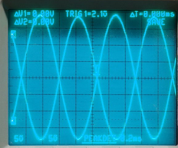

Does it work? There is no PowerDrive circuit yet (those parts might wind up on a piece of perf board due to another really blonde idea), but does 400V peak to peak of drive from a 550 volt supply sound like enough to make some screen grids glow?
I reduced the input level to make the picture fit the scope screen. This picture is only 350 volts peak to peak. Now I must go outside and put some oil in the car engine before I do something else really dumb!

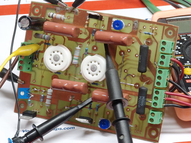

Well I finished the car so I resumed where I left off. I had previously twisted my power supply as far as it would go to see how much drive voltage this thing could put out. The power supply goes to 550 volts. While working on the car I was thinking 550V? The 10M45 is only rated for 450 V why didn't it blow? When I resumed I was scoping the 10M45 and I discovered that it was indeed seeing about 500 volts. It was also starting to smoke! Power OFF! Well the 10M45 will indeed handle 500 volts, It really does not like to dissipate nearly 5 watts without a heat sink. Heat sink added. Heat sink is elevated to 550 volts. Note to self. Don't touch it. While doing some further testing I started to smell a smell that only an electrolytic cap can make. Note to self, 400 Volt caps really don't like 550 volts. I took it out. Board works fine without it. It ran for 1/2 hour at 550 volts.
I have decided to cease playing with this dangerous toy. I have tempted Murphy twice already and I don't want to have him visit me today. I want to add the PowerDrive circuit so that I can make something glow. This means moving the CCS's to the other side of the board. If I get done tonight I will "test" some tubes. I don't know which ones yet.

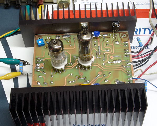

Yes< this little project started out on shakey ground, stumbled a few times, but grew up big and strong. I moved some more parts from one side of the board to the other, and added the mosfets. I installed some absolutely monstrous heat sinks because they happened to already have tapped holes in the right places.
I plan to use this WMD to find the limits of screen drive, but first I intend to answer a question that I have wondered about since I was about 15, but only now have the ability to really answer. The question? Just how many watts can a pair of 6L6GC's put out without melting?
I have made guitar amps since I was 14. Most of my early ones used old TV parts, but somewhere in High School I graduated to 6L6GC's. My best amps strained to make 60 watts. I know that a major weak point is the propensity for an arc to occur between pin 3 (plate) and pin 2 (heater). This limits the plate voltage, so I plan to explore the possible power gains to be had by using AB2.
I will report on these activities in the 6L6GC AB2 Amp thread and the Screen Drive Push Pull ideas thread.
