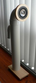

Another option for an enclosure if you can't build a box is to use PVC pipe and fittings that can be picked up at hardware stores and plumbing supplies. The one in the pic is a little one I did for a TV/DVD thingy in a small room.... easy and cheap but the sound would not be suitable for your needs.... does give you an idea though.

Another way to think outside the box and mostly PVC pipe fittings which makes it cheap and easy.
