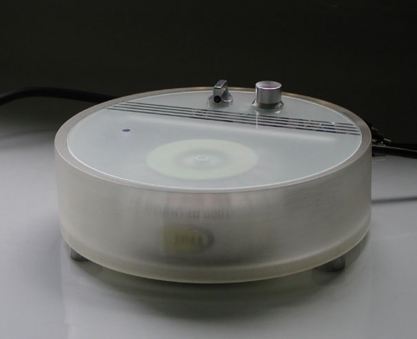

Philo, considering the dimensions of the heatsink it is not strange that it heats too much. Without the hood it is still quite acceptable though. Additional heatsinks saved from the old processor will go left and right at the current heatsink. Holes will be made at the bottom and the back of the case. Should be enough. Btw, that second amp which has whole 2mm aluminum case almost can not get even warm, no matter how long or how loud it works.

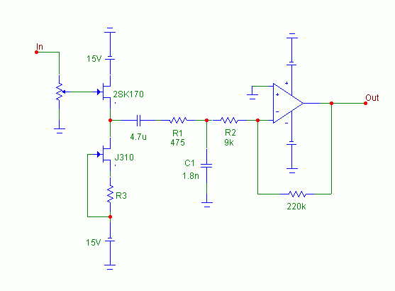

It is indeed important to have some kind of low pass filtering at the chip itself. Last night I tried it with my ‘clone’s JFET input buffer. I will update the content of my gainclone page with it this weekend. For now, this schematic shows what I have at this moment. I usually practice to take a step back to check what I really have made, and will do the same now also, but this sounds like I have got a missing point about that buffer. Filter rolls-off at 20kHz 0.09dB and phase shift is 10° (matches to the “magic” -3dB at 130kHz rule). These values are derived by simulation and are confirmed by measurement (everything happened last night). FET is hooked to 15V and sourced by some 14mA. I intend to exclude R1, just need some time to determine the FETs output impedance (simulator shows some 25Ohms, if so, then C1=47nF will respond to this).

Joe, it seems you were right again. I tried the lpf with the slope similar to that you proposed (I put to the schematic above R1=75 Ohms, C1=47nF; 1kOhm-4.7nF could be better since styrene cap can be used) and… fine, just fine. I did not like the idea of such radical (coming inside the audio band) roll-off, but it works.
Anyone else to join the experiment?
It is understood, the time was too short for the extensive listening. But I am quite sure I am close to something better than bare ‘clone. For some reason I still do not understand (though I have presumptions about it for the export), the buffer made some sort of the aggressive dirtiness for which I found is mostly coming out from my tweeter. Making this lpf and lowering its roll-off point makes that stress became less and less, but even more than that, soundstage and resolution improved. All the time dynamics and openness I get the first time I applied the buffer, is preserved. I have some further plans regarding the filtering.
