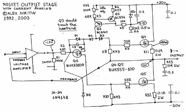

Hi All,
I do apologise for a rather rough drawing. However it is quite correct and could be built. I did omit the voltage amplifer, as it is a matter of taste and there are plenty of circuits around. This circuit will work both inside and outside the NFB loop. It is a proper follower with a high input impedance and low output impedance (aboul 0.2 Ohm). This circuit is close to the very first one I've designed in 1992. Since then it's versions (considerably improved and developed) were used by me in a series of Creek Audio Limited amplifiers (I was a chief engineer there till the end of last year) , starting from 4240 and including latest 5350 and A50 amps. I did publish the original idea in the RadioHobby magazine (in Russian) in 1998. If you DO understand how it works, well done. Many people don't. However it performs nicely and could be even happily biased into class A providing sufficient heatsinking. It is NOT short circuit protected, so take care about that. Power supply with the transistors shown could be between +/- 25-35 V .

Hi Al. This is right up my alley at the present moment. Have been doing *lots* of experiments withthis topology. I like the way Q1 Vgs partially counters Q4 Vgs so there is no output offset; something I had been pondering. Instead of the current source at the top, my ccts had a resistor fed from a rail that rode on the output. What is the purpose of D2 & D3? It would seem that this circuit could be scaled up to heroic proportions without much trouble. 😎
All diodes for protection only . And you quite right, you can build a really BIG one using this topology. With the resistor you will be not able to control the idle current with temperature, and you will lose the symmetry as well.

this looks nice to me. I have lot of IRFP250N, and IRFP150N. I think they are useful for this project. Do You think that IRF9510, or 9610 suitable as Q1?
I want to use this amplifier with +/-65-70V to get some 4-500W. I want to use valves as voltage amplifier. E88CC with two stage common cathode amplifier looks nice.
Add some DC servo to the gate of Q1 can helps to keep the output at 0.

Good thinking - one of my first prototypes in 1992 did actually work with IRFP250 and 9610. Don't forget to put 9610 on a heatsink, reduce R8 and R10 to 150R (1W 1%) or 2x 0.5W 300R in parallel, increase R7 and R9 to 68-100R. For +/-65-70V you'll need to use 9610 (200V) as 9510 is only 100V device. And you'll need to replace Q2 with 9610 as well, on a heatsink, replace R4 with 1.2V bandgap reference (it will give you perfect temperature compensation for IRFP250's), increase power on R6 to 3W and reduce R3 to 24 Ohm or put (better) an additional resistor in parallel to R3 RV1 chain, say about 47 Ohm. I also would advise you to use a small inductor on the output (1-3 uH) in parallel with 1 Ohm resistor. Servo is also a good idea and the circuit will work fine with a valve VA, just provide for some voltage limiting so not to overvoltage the input too much.

Sorry, I think that this value should be more like 68-75 Ohm, otherwise the adjustment range may be not enough. Try with R3 33 Ohm first and without additional resistor - it should be safer 🙂 .
Also for RV1 position better to use a cermet trimmer pot with at least 0.5W rating.

Is it possible to use higher positive rail for the Q2-Q3 network, I think this will gives more output voltge swing.
If I use valve input stage there will be no problem to put the whole current regulator network 20-25V over the positive rail.
To avoid the input overload I will use two zener+diode series networks to the power supply rails.
I think to use higher value source resistors, say 0.33-0.47, to get better bias regulation. With 16 output devices 0.47 ohms is not too much.

It is not just possible, but very desirable - actually i did it in that prototype circuit. 10V-20V is enough. Input limiting could be done just by adding one more diode from the input to the positive rail of the output devices. higher source resistors OK, if you will use several devices. You may find you'll need to increase the current through the driver (9610) to be able to drive more of these. Just reduce the value of the resistors further and calculate the power dissipation carefully, especially on Q2.

Yes, IRF610 may be used in Q1 position without changes.

Thanks! Obviously I thought about IRF9610 🙂 - I was half asleep replying. However N-channel device (like IRF610) could be used in Q1 position (!) thought the circuit will become an inverting and amplifying stage and will require an appropriate driver arrangements and input biasing.
