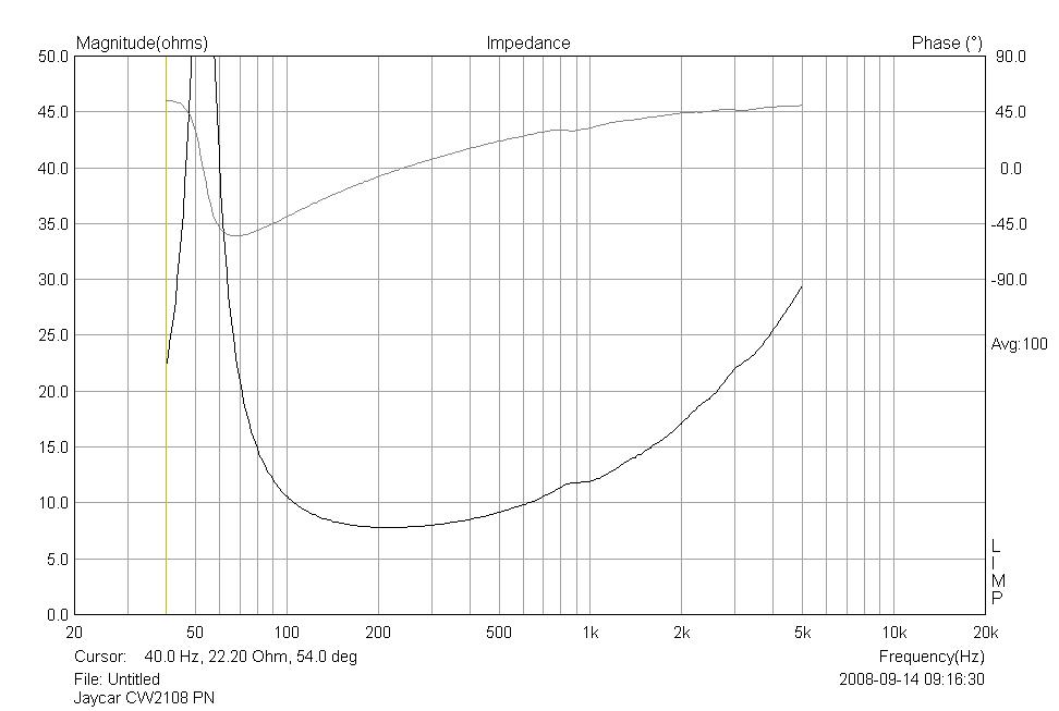

I used the CW2108s paired with CW2142s as a 2.5 way in 50L cabs tuned to ~40Hz (I'm at work, so numbers are only ballpark...)
CW2108s - respond nicely up to ~4KHz and fall off rapidly, like a good polycone should; In fact I'm running these without any crossover parts on the CW2108s
at the low end Fs is higher than Jaycar's specs (surprise surprise) but they model well in an EBS alignment; downside is they can't handle low end power very well at all, but if you've got 4/side they may be OK, depending on how loud you play. Otherwise I think they're a good mid driver.
I'll look out my measurements tonight if I remember when I get home

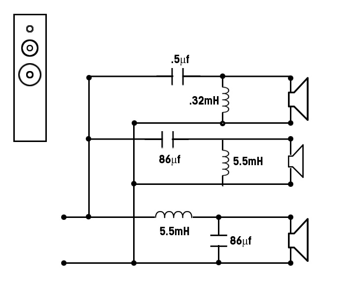

Ive quickly done up a crossover network for this design.
I was thinking of making the 6" mids run off a bandpass crossover config, but then read that to only use bandpass when the frequency difference is 20 times the crossover frequency or 2 frequency decades. So i canned that idea as the high pass would be 230hz and low pass would be around 4000hz. (going by the advice you two have given)
If I run two 6 "mids together in paralell, this would create a 4 ohm load. Would this matter at all or would the changing the values of the coils and caps even this out ie. insert a 4ohm load into a crossover calculator instead of 8 ohm. I presume the crossover would even out the load with the right values.
Anyway, have a quick look at the attatched file. See if that network is good to go so i can start ordering the parts 🙂

I'd run the 6" mids in series - I think that'll give a better match to the sensitivity of the 8" & make BSC easier
No, the crossover won't 'even out the load'
What Impedance values did you use to calculate your part values? - we can't check if they're right if we don't know that.
Re: your xover diagram, I'd make it even simpler, - omit the C on the woofer, this lets you use varying the L to deal with BSC;
& also omit the L on the mids at first, the CW2108 drops off fast enough that you don't need it
You may need a resistor in series with the tweeter to adjust how bright it is, but try it without at first.
Also, how wide are you planning to make your cab? - need to know to calc the BSC freq.
(Excuse my terse replies - I'm at work and have to squeeze answers in while I can 😀 )
I find that the wider the range that the mid plays the better sounding the final speaker, the advice I've read is to have the mids play a MINIMUM of 3 octaves, so 250 to 4000 works, I agree with peter in this instance, try it with no inductor at the top of the band pass, just cut the low frequencies with a second order. Add an inductor at the top later if needed.
If you decide to run the mids in series it will double the inductor value needed ( and halve the value of the capacitor of course ) so costs increase rapidly as high value inductors wound with large wire aren't cheap.
However; I have found that inductors in the return path to ground can be of a relatively high DCR without too much effect on the sound.
Jaycar have a 9mH laminate core you could try that value in your calculations.
