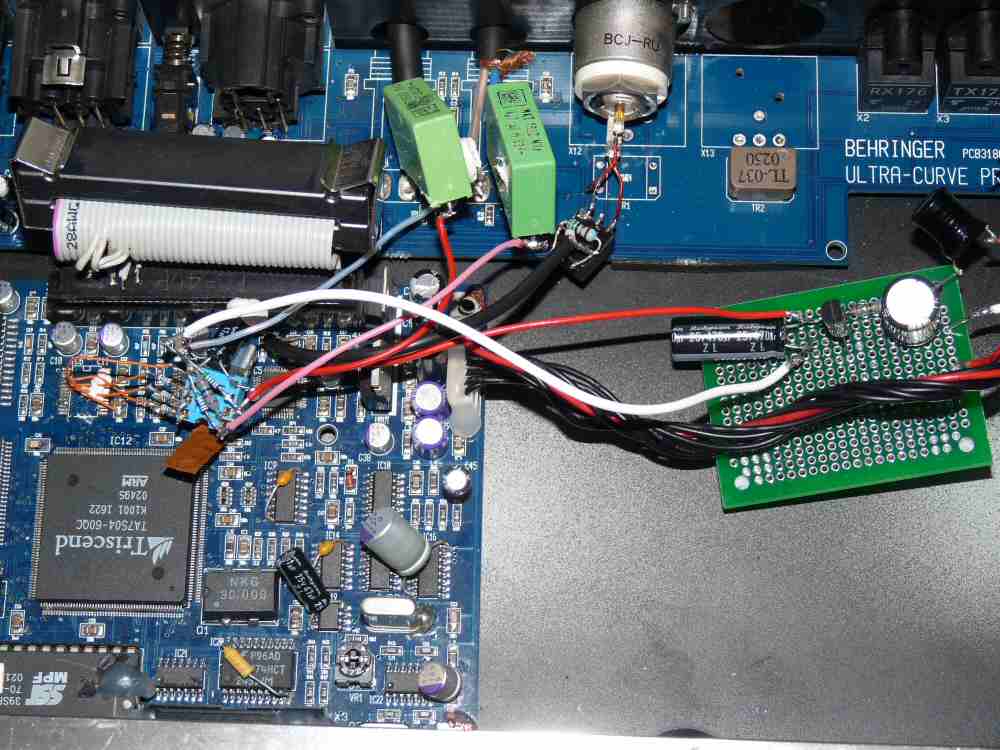

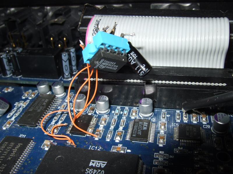

I checked the pins of ak439 and the data sheet and it does seem to receive I2S signal. So I went ahead and tap the pins 5,6,7 (BICK, SDATA, LRCK) of the ak4393 and it works.
I got 1 channel working and the sound is not too bad (considering that I tap from a poor power supply).
I tried the eq and it works with the 1543 too. I believe the deq works in 24bits but 1543 just ignore the extra bits.
I will put in a better 8V for the 1543 and complete the other channel when I have more time and see how it sounds.

What did you do with the audio out from the tda1543? Did you cut the trace from the old DAC and insert the tda1543 audio at that point or did you just parallel up the two DACs?
Just wondering if your tda1543 went through the same transformer output as the original DAC in your comparison.

Here is another pic.
Sound is very good. I now using tl431 to get 7.5V instead and add a copper foil for heatsink. The tl431 give a better sonics than the standard 7808 regulator.
It seem this tda1543 will make cracking noise when over heat, so I reduce the voltage a bit and add a copper foil.
And I confirm that I like the tda1543 better than the akm4393 with tranny direct out.
Now maybe I might try the tda1541 next... with opa861 perhaps...
Or pcm56 if someone can tell me how to convert I2S to interface with pcm56...
