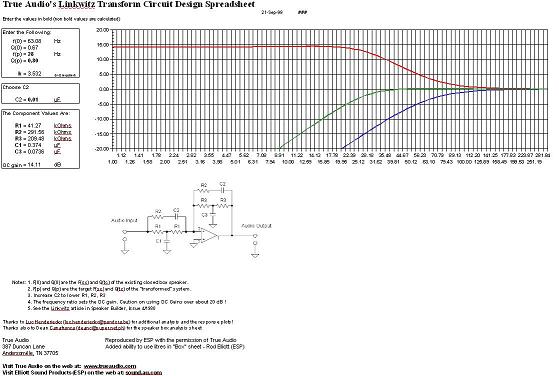

I'm planning on using 2 of them is a 42L cube, sealed with Linkwitz, to go to -3dB @28Hz

how much LF gain is required to get down to 28Hz?chris661 said:I'm planning on using 2 of them is a 42L cube, sealed with Linkwitz, to go to -3dB @28Hz
14.11dB
loses 1db per Hz down after that.
Sounds good in some bigger boxes - had to put bottles of water in to reduce int. volume to 21L/driver.
pics of the spreadsheet attatched.
red line = correction
Green = overall output
Blue = pre-corrected output.

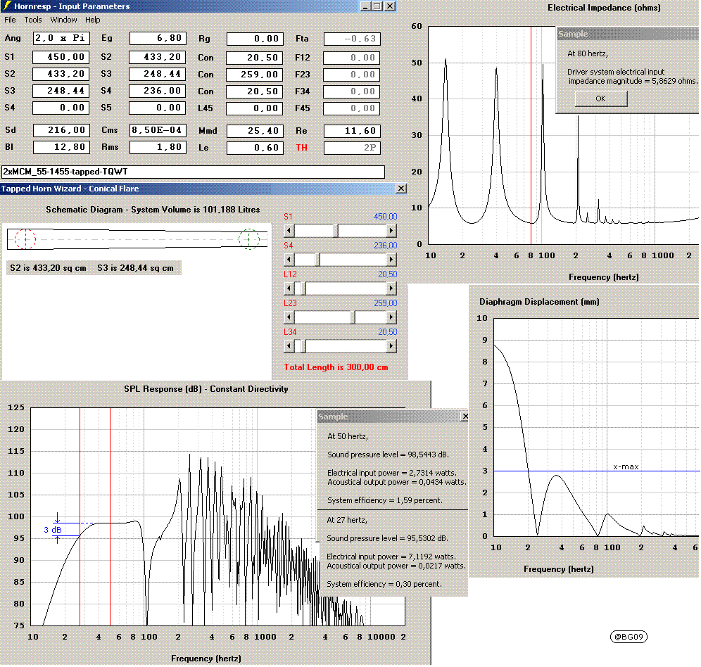

Hi chris661,all,
A last minute suggestion:
Why not build a stuffed T-TQWT (Tapped-( folded) Tapered Quarter Wave Tube) using the two suggested drivers.
Only one internal divider and two bracings is needed.
See the submitted picture 1(1) of a HR simulation.
