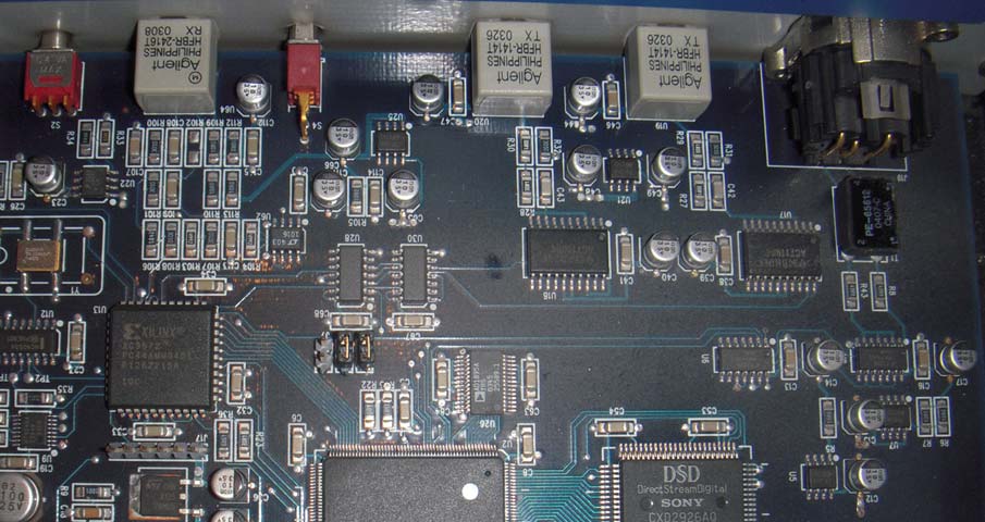

this is from the
EMM lab CDSD model player
aglient HFBR-1414T tx and HFBR-2416T rx

Looks like EMM are using the app note circuits...
I can see a LT1016 near the RX. Nice to have some confirmation that we are on the right track.
Any chance of a clearer pic of the ACT series chips near the TX?

TJF said:... near TX I see no 74ACTQ00 ...
Thomas
Yes, you are right! I was getting a bit over-excited. There is some kind of ACT chip used however

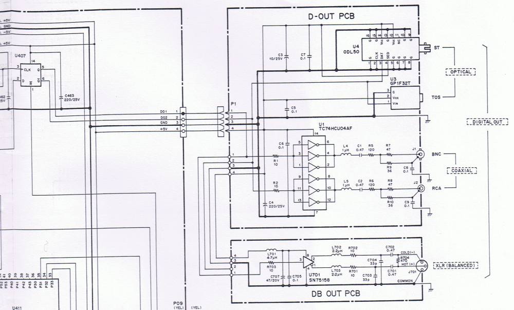

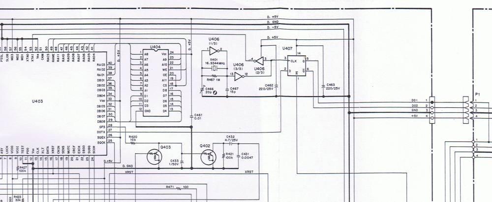

The aim is to find an ST compatible RX and TX. The up to 2000 it seems the ATT/CTS ODL 50 series II pair was used by most high end manufacturers but these are now extremely hard to source. Schematics posted to the ShigaClone thread by Peter Daniels are an example of the type of circuit being used.
http://www.diyaudio.com/forums/showthread.php?postid=1743945#post1743945
The current crop of RX modules which have sufficient bandwidth no longer feature the TTL outputs of the ODL 50, so require additional external gain. So we've been looking for a suitable circuit in the app notes. The circuit in AN 1121 appears to fulfill the requirements. The TX would be driven from the same data as the SPDIF outputs.

George,
thanks for posting those schematics 🙂
I guess one way to approach a TX board would be to simply replace the ODL 50 with the 74ACTQ00/HBFR-1414 combination.

I think that EMM lab CDSD
did not use any of fancy chips to drive...
I shall try to find and post out a bigger pict.
(we opened the damn thing to explore fault of transport mech
philips one cheep VAL used in some philips DVD players sacd style...
EMM put the laser in constant operation, so it died very fast, and after that tryed to charge 500usd w/o posting, to fix the problem... changed only lasr diode, now working good... Also PS is from chopper fashion... And pretty emputy inside... dissapointing from that amount of money)
