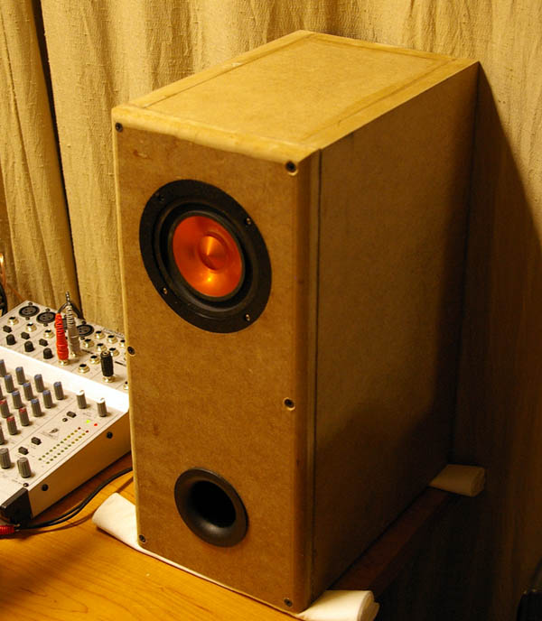

I felt like experimenting, so I went out on a limb and picked up a pair of CHR-70s for my first shot. Everyone seems to highly regard Mark's Alpair series, so I was really curious how a "cheap" speaker from the same designer would perform. Since I'm playing around with getting a lot of great sound out of as little money as possible, the $70 a pair price range seemed pretty sweet.
These first boxes are fairly large. they're not the "mathematically optimal" size for deepest flat bass extension, but they're not much of a compromise. For my first boxes I wanted to see how the speakers would sound in an optimal box designed so the speakers could stand alone. Next I'm going to play with a much smaller enclosure and see how small I can go before they really loose their oomph.
I'd like to experiment with some really small boxes, and then use one of the Adire Extremis 6.8s that I have laying around to do a small subwoofer, and make a matched 5.1 system.

If you guys don't mind I'll just babble here a bit about the construction or whatnot, as I'm a noob and all the basics are still interesting to me, plus, anyone else looking to build a cheap speaker with these fellas might be interested.

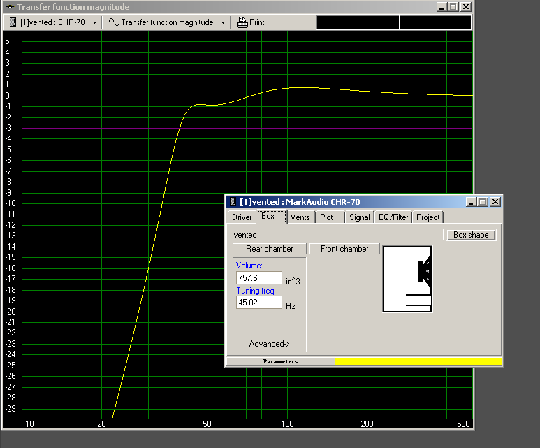

The box ended up being about 12.4 Liters, tuned to 45hz, with a 1 1/2" diameter port at 4 1/4" long.
I actually just used a bit of pillow stuffing along the back of the speaker for damping. I may try adding some more to see what effect it has on the sound at a later time.
Attached is the WinISD plot of the box as built!
Random anecdote: I was originally going to build the boxes at the "optimal" size as determined by WinISD's "Chebyshev" alignment, for deepest and flattest bass response. This meant that the 4.24" ports that I ordered were plenty long and, in fact, I'd have to cut them shorter to make them work. I then decided that the boxes were simply TOO big and I wouldn't be able to put them anywhere, and even though I'm experimenting it'd be nice to have something halfway usable, so I shrunk them down exactly as much as I could without having to order or build a longer port, so in a way, the size of the box was determined by the length of the port that I happened to have sitting around 🙂

nice! do you have any BSC?
and how is the sound overall? midrange? high? tonal balance?tresch said:What really impressed me was their low end performance....
Thanks! And no, no passive filters yet. My audio source is a computer, though, so I can use Winamp's built in EQ to shape the sound, and I've been experimenting with with that to tame the high end a little. It doesn't take much. In a lot of music I actually almost hate toning it down, just because the high end actually sounds quite pleasant!
That said, I've not actually objectively looked at the baffle step problem, I'll definitely have to do that today
Overall fantastic, I'd say. Forgive me as I am not exactly the worlds most seasoned listener, but I do think I have a taste for decent sound. My high-end listening experience is largely based around Grado SR-80s and the B&W 602s that I mentioned above. In that context, I really love listening to these speakers and I find myself digging for music just as an excuse to listen to them.
The midrange is just lovely, and the highs are suprisingly unoffensive. There are definitely a few frequencies that the speaker plays really strongly relative to others, but it doesn't sound distorted, just... louder at some high-mid frequencies. This could, of course, be due to the whole Baffle Step thing, so I'm going to have to look into that

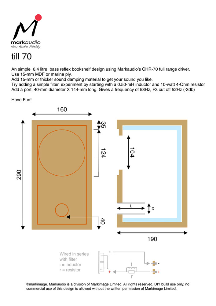

Hi Everyone
I'm receiving lots of emails asking me for plan builds for the CHR-70, especially simple BR that's a handy size. Here's a plan for a 6.4 litre BR.
I've suggested using a 40-mm port and a filter to get started but feel free to experiment, each to their own tastes.
