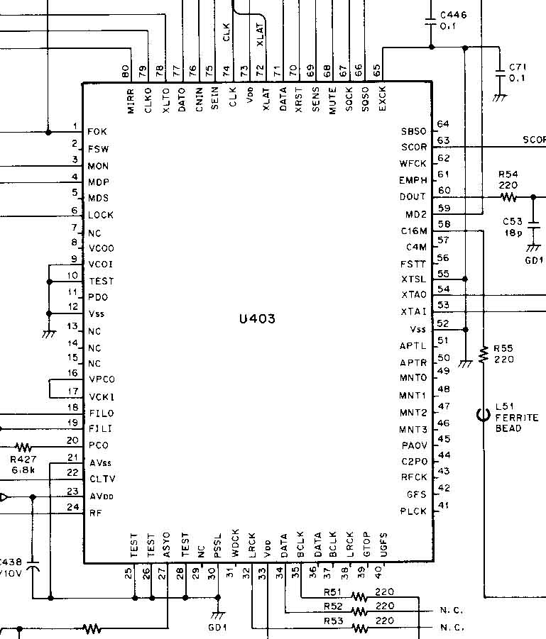

I would like to know if there is an I2S signal somewhere in a Teac VRDS-type transport? It would be great to forgo the SPDIF link and use a buffered I2S link to connect the transport to the DAC or just build the DAC inside the transport.
I'm using a Teac P700 transport at the moment, but I'm looking for a VRDS-T1 that has a lot more room in the box for modifications.
inside a T1
I've got a T1 transport and I've got the schematic. I don't know enough about I2S to say if you can tap the needed signals, but for those with more expertise, here's a scan of part of the schematic where I think you should be able to pick up the signals. Can anyone else comment?
---Gary

Hi PJR and Gary B,
I think that I help you in the model of GaryB I can see the eschematic of the pins U403 and I see the pins numbers
32 is LRCK, 34 is DATA, 35 SCLK all pins
connected with the resistor of 220 Ohms.
You can pick up next these resistors and you have the three singnals that we need for the I2S bus, I can help you more but I need the reference
of the U403, Type and manufacturer.
By carefully you don´t connetc before
the resistor becouse the square wave
is bettre next these resistors.
PJR if your Teac transpor use the same
chip the solution is the same.
Best Regards.
Jesús

By carefully you don´t connetc before the resistor becouse the square wave is bettre next these resistors.
really? the square wave looks nicer after the resistors? why would this be?
i connected them before the resistors because my digital decoder datasheet says these pins can only put out a maximum of 1ma. so if i could squeeze in an inch closer, i would do so.

GaryB and Jesús,
Thanks for the info! I'm glad to know it can be done and it's definately going to be my next project.
GaryB, do you have the full schematic scanned for the T1 transport? I would love to receive a copy since it's only a matter of time before I'll find one with my name on it...
Check out if the chip you are tapping the signals from is including the digital filter (decoder/dig filter in one).
If it is, the signals are useless...
Check the schematics, if the dac's are right behind this chip, the dig filter must be inside (or before). One other methode is checking the clockfreq..
GuidoB
VRDS T1
Guido,
The T1 is just a transport, so I suspect the data will be valid. Just in case, the clock frequency is 16.9344Mhz. By the way, the stock VRDS T1 is just an OK transport. I've had it for a number of years (>5) and upgraded it with a low jitter clock and output driver from G+D transforms when they were still in business. The output driver uses some Motoroal ECL drivers and the combination is a big improvement over the stock unit.
Regarding a complete scan of the T1, no I don't have one. Why not just call up TEAC and have them send you a service manual. Thats what I did and it wasn't too expensive. Definitely less than $20.

Gary,
You are right, if it is only a transport, there is no dig filter.
But it could be that the output is not i2s but some other format!!
Check were the signals are going (spdif transmitter i guess) and if it can handle
i2s and is setup to handle i2s. There are many serial formats..

The Sony chip outputs EIAJ format, which means the data is right alligned and bck is 48 WCK. The chip has a fout times oversampling filter. Wether or not oversampling is active depends on the pin57. If I remember correct if pin57 grounded then the oversampling is bypassed.

Hi DonJuan,
For my experience I prefer pick up the signal netx the resistors these resistor don´t influence in the corren source of 1mA it are in serie configuration and more
and these resistors are for the adapter the line to DAC, my experience is that before en ln digital lines and source clocks I have more overshooting + ringnig
these overshooting have High Frecuency componets and this is no good for me, and netx these high frecuency are muffed
next the resistors.
In the RM20 you can see that resistors are next the NPC digital filter, I think that is an integrate DAC but in the case of Gary, he has a Transpor and he needs an
external DAC, also I suposse that Gary needs before pick up next the resistor he needs a buffer for external output becouse is not recomendable pick up without bufer for external source or he nedds on tratament of these signals before tha external source..

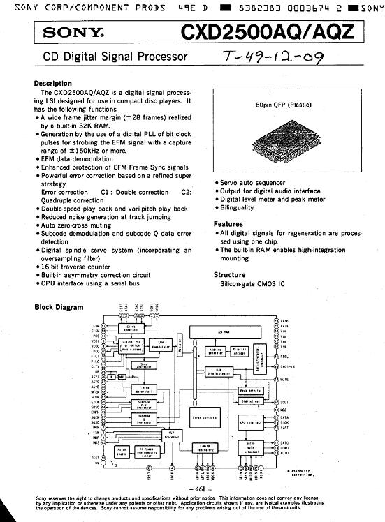

This must be wrong....when looking in the data-sheet the pin57 is marked: 4.2336MHz output. Subject to vari-pitch control.
The data-sheet is to big for posting....🙁
Here is the first page in datasheet:
What do they mean by: Digital spindle servo system (incorporating an oversampling filter)
Is there a filter present to prevent the servo system to go bananas because of noice, or is it a digital oversampling filter active in the chip's sound-processing ?????
