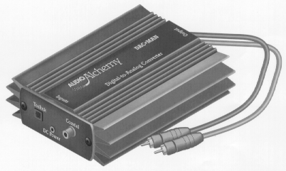

A friend gave me an Audio Alchemy DAC MAN with "if it works and you want it, make me an offer..."
Does anyone know anything about this DAC and what it may be worth?
Also, it came without a power supply. The power connector seems to be a stereo mini-plug, so I imagine that there were 2 voltages with a common ground. Does anyone know anything about the power supply?

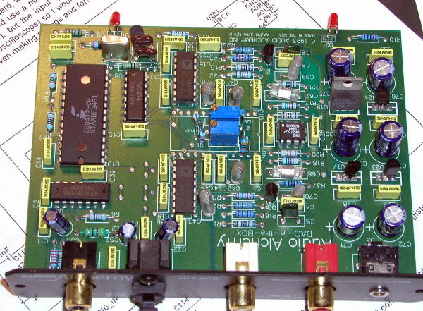

IIRC, it uses the CS8412 and the 8pin CS4330. Sorry, don't know what it is worth.
ray.
Here's Dac in the Box.

Hi Alex,
I've own Dac Man for a year an then sold it to buy a DDE v3.0.
This was some years ago.
Anyway, my brother bought one too, and still has it.
I made a stabilized PSU for my brother, and it gave big improvements in sound (specially in the bass definition).
Anyway, the details are:
PSU: +/- 12 volts (and ground), on a stereo headphone plug.
Dac: Crystal 18 bits (I don't remember the code).
Op-amp: PMI OP275
Internally you have several (yes!) 78L05/79L05 for the digital seccion and 78L09/79L09 for the op-amp (it's only one).
You'll have big improvements with a stabilized +/-12v PSU, and if you change the op-amp for an OPA2132.
In this Dac, with listening tests of various op-amps, this one gave the best results.
Also, change the 2 main electrolythics, after the PSU input (220uf) for 470uf (you don't have space for more...), bypassed with 0.1uf under the circuit.
You'll find, as I do, that this Dac is damn good.
Damn, damn, damn good, it kills any mid-priced cd-player.
But keep in mind that it cost around 150 Euros when new, so I wouldn't give more than, say, 50 Euros.
But you'll have high-end sound for 50 Euros, and if you do these mods, believe it or not.
