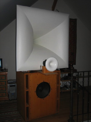

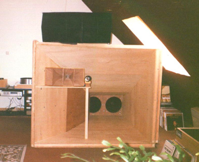

You'll see on the pictures on the page:
http://www.melaudia.net/rueil0903.php
what I consider as the maximum width for an axial Le Cléac'h horn.
We'll have a public demo of that horn during the weekend of 28 & 29 (march 2009).

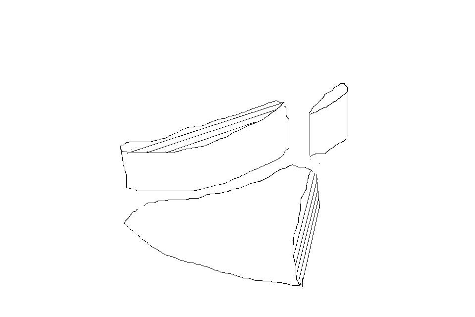

For cut-off frequency under 150Hz I don't recommand the complete axial horn calculated by my method.
I recommand a quarter of axial horn placed on a corner of the listening room as on the picture:
http://ndaviden.club.fr/pavillon/axial_murs.gif
For very low cut-off frequency I recommand 2 halves of quasi-cylindrical waves Le Cléac'h horns
http://ndaviden.club.fr/pavillon/cyl_mur.gif
The spreadsheet to calculate that horn can be dowloaded for free at: http://ndaviden.club.fr/outils/cylind.zip
You can see a picture of such a realisation at:
http://img383.imageshack.us/my.php?image=dsc30511280x768ac0.jpg
