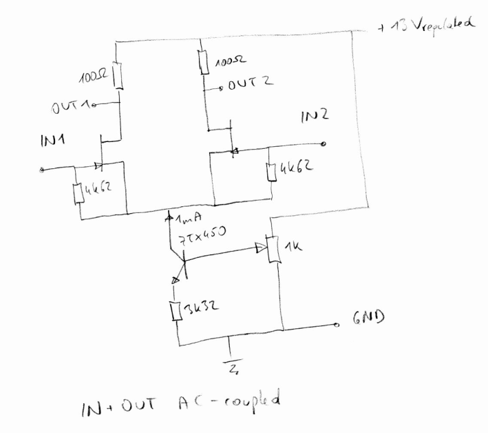

(See schematic below) A simple LTP consisting of 2x Toshiba 2SK369GR jfets (same as last time), no source degeneration, a simple tail current source using a ZTX450, setup for 1mA. Load resistors of 100 Ohm were chosen to keep Drain-Source voltage variation low as the used rails (0-13V) do not permit the use of a cascode.

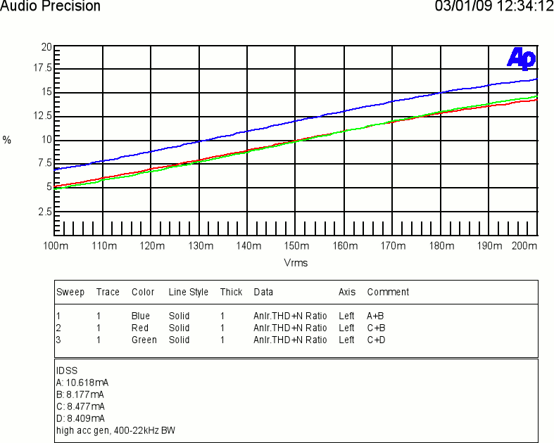

For starters the THD+N plot.
Jfets A+B represent the worst case where 2 randomly chosen jfets have largely different IDSS; in this case THD+N is constantly higher by about 1.5% absolute.
Jfets B+C is so-so matched (to 0.3 mA) and is nearly indistinguishable from the best matched pair in the comparison, jfets C+D (0.068mA difference in IDSS). If you look closely, you see that this closest pair actually performs worse for larger input signals than the mediocre matched B+C pair (look at 180-200mVrms).
To summarize the plot, avoid largely unmatched jfets for LTP-use, but even mediocre matched pairs can work better than tightly matched ones. So to reliably get better performance by matching, one need to use a distortion analyzer for verification.
One does not get automatically better performance.

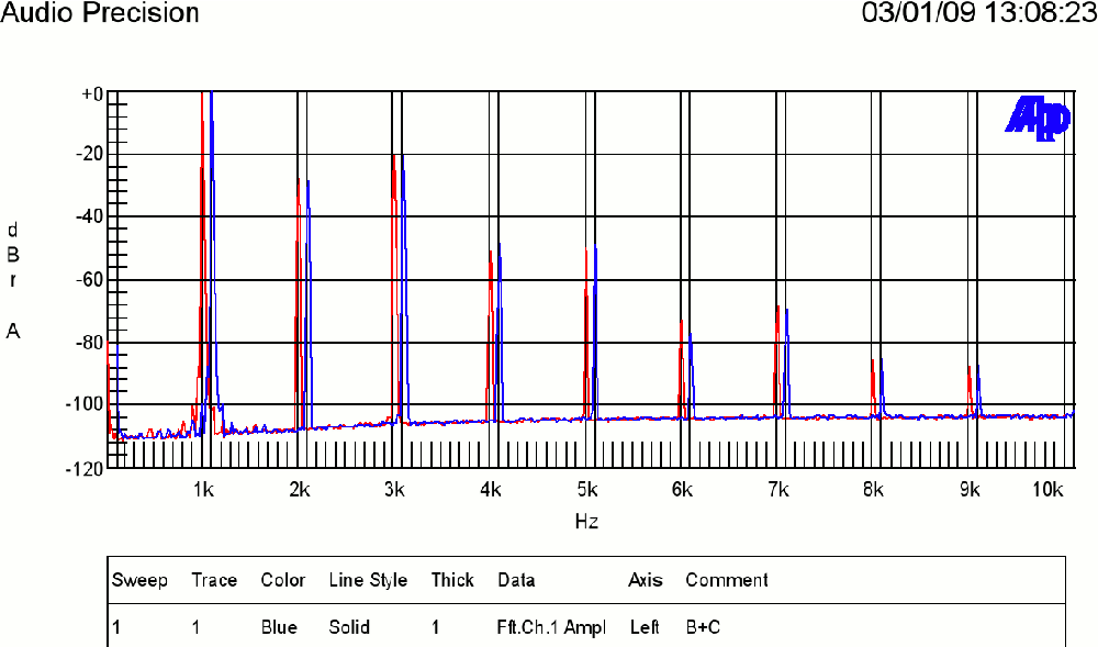

As there's often the discussion of distortion spectra, I might contribute some data as well.
Here the overlay of the mediocre matched pair B+C (blue) and the tightly matched pair C+D (red). No notable differences. Small differences for 4th and 6th order; odd orders largely unchanged.

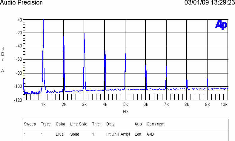

Finally the spectra of the worst case pair: large 2nd order distortion compenent,distortion cancellation no longer effective.

Ups, sorry spectra for the worst case were missing.
So here they are:
So here they are:
Finally the spectra of the worst case pair: large 2nd order distortion component, distortion cancellation no longer effective.

AC-coupling is no fun, higher rails, cascode would be nice etc. - however the comparison is still valid as all pairs are equally affected.
And the comparison was the whole point in doing this 😉

I guess you simply missed that the LTP runs on a single rail. So you cannot assume that the jfet source sits at ground potential. If you connect the gate to ground, the source sits much higher -> -VGS. The same as source degeneration.
As the current source takes all the voltage, the jfets would just cut off.
Have fun, Hannes

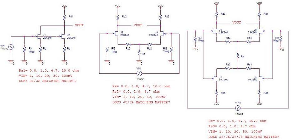

h_a, JFETs have a unique property: they self bias. Here are three self-biasing configurations that would be very interesting to investigate experimentally. I understand that's a huge amount of work (lot's of variables), but at least one of each cases will reveal some results. E.g.
- Two parallel JFETs (matched/mismatched) with 0.0/4.7 ohm Rs at various VIN (4 measurements/passes)
- LTP with two JFETs (matched/mismatched) with 1.0/4.7 ohm Rs and Rs2=0.0/2.2ohm at various VIN (8 measurements/passes).
- H configuration with two pairs JFETs (3 mismatches P/P, P/N, N/N) with 1.0/4.7 ohm Rs and Rs3=0.0/2.2ohm at various VIN (12 measurements/passes).
Hi Ovidiu,
thanks for your input!
Am I missing something, but #1 of your suggestions was part 1 of my little series.
#2 should be easy to implement, #3 needs a new power supply 😀
Of course, especially the complementary case would be interesting.
