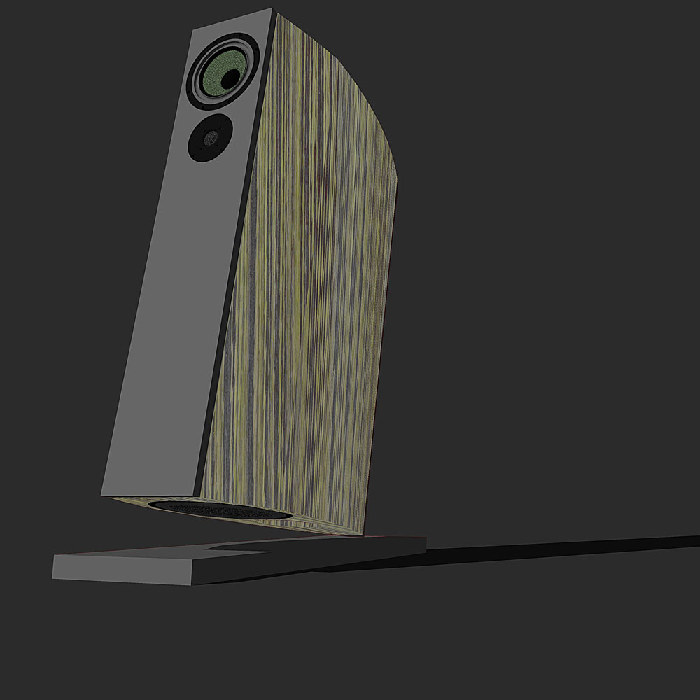

Oke, I made a new start, my dad likes the new design and so do I.
1. Sonus Faber Stradivari - style
2. Closed box instead of BR because of uncertain boxvolume due to making the box in about 60 layers of 18mm mdf and faster reaction.
30l for mid
40 l for basswoofer, more volume gives less output

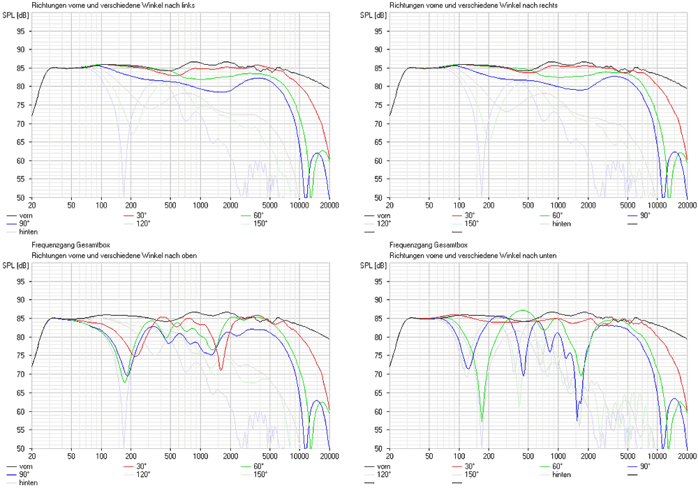

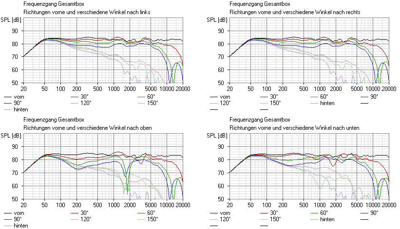

off axis
of axis is nice now i think

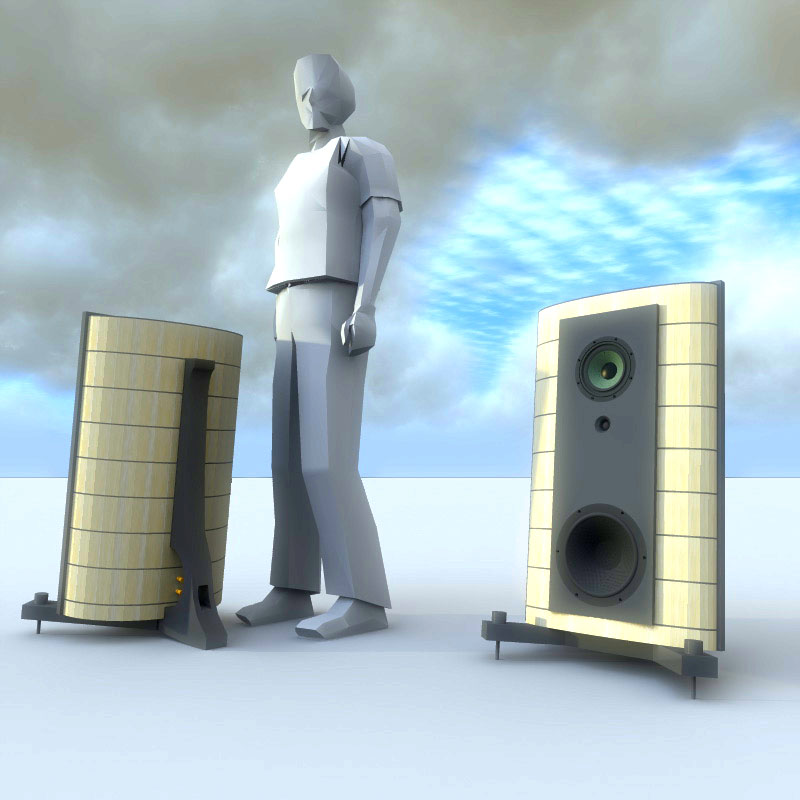

and rjb aesthetics is important for an architect do you like the design? is it sonus faber,? i tried to make it also a little different and doable.
it will be about 60 layers of mdf and the frontplate and backsideelement will nicely fit in
