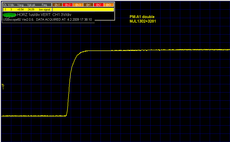

No output coil, you are right. I will make more measurements of this kind with suggested load later, as I am pretty busy right now. I promise to return to these mesurements. As a reminder, the original response into 4 ohm.

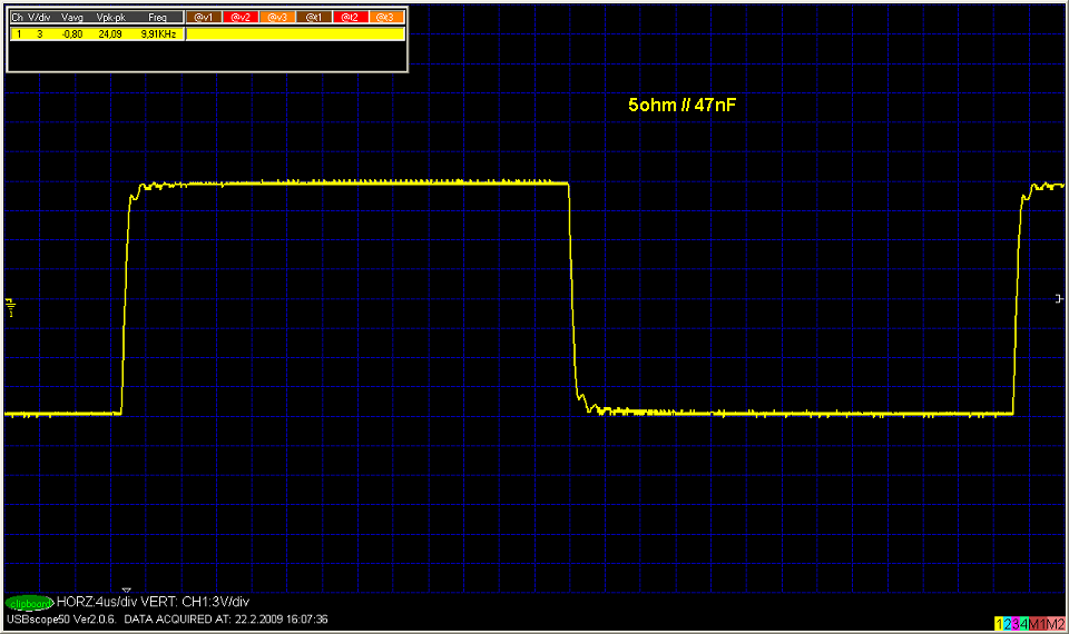

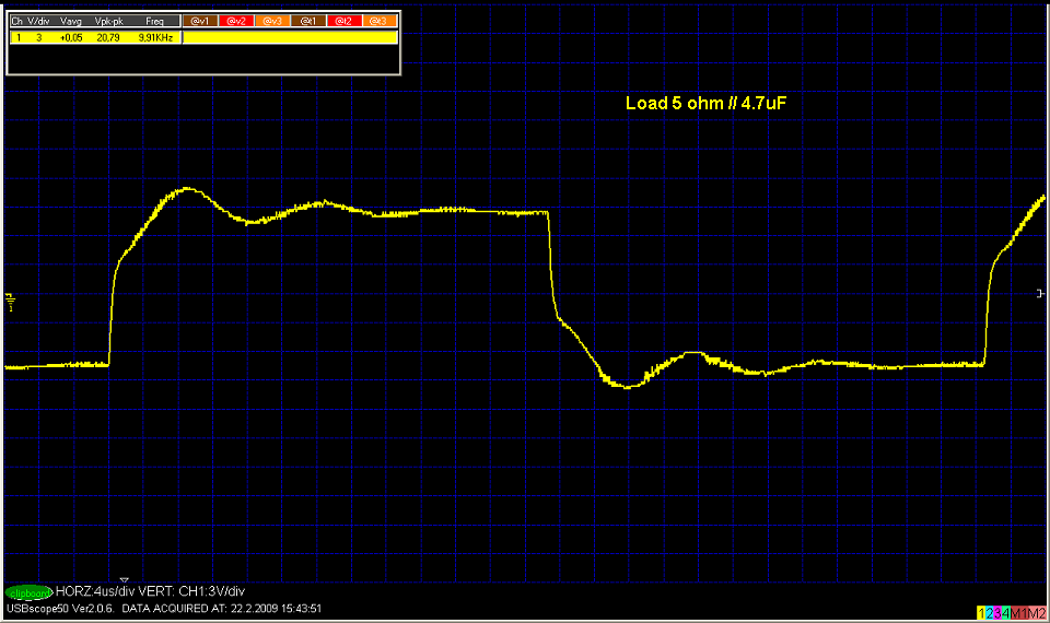

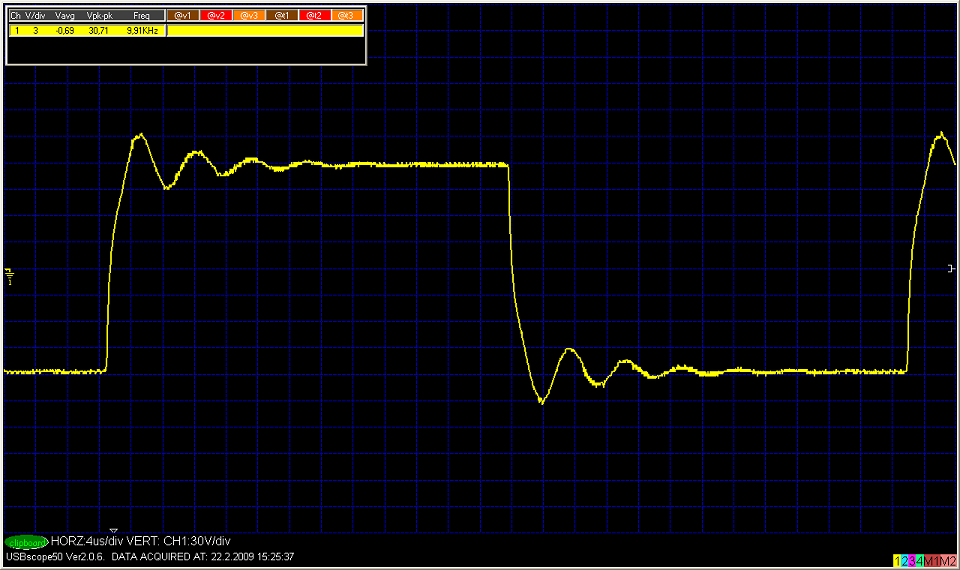

As you can see, probably no one would show us similar kind of measurements.
I should note that I measured at power amp speaker terminals, i.e. there is about 20cm of wires from PCB board to speaker terminal, and ringing seen in 1uF and 4.7uF load is that of the inductance of connecting wire and the cap.
Oh?
Without the inductance and just the cap, less or no ringing?
Syn08 shows us via a link his amp at 500kHz showing some overshoot, but at 500kHz. I am wondering how that squarewave looks back down at 10kHz?

PMA said:
Count with me. 400 nH of wire inductance, 4u7 cap. We see the resonant frequency.
I would like to see syn08's amplifier loaded by 1uF and 4.7uF, at 20 - 30Vpp. With 47nF, that is close to 100nF in syn's measurement, I have almost no ringing.
I would love to see that too, unfortunately I don't think it's possible. Short of the cap ESR and wiring, it is only the output impedance that limits the current through a capacitive load. As it is, anything over 100nF or 10Vpp triggers the overcurrent protection, set to about 24A. The final implementation as in the pictures on my web site has a 0.7uH output coil. With that I can go as high as 2uF||4ohm for 30Vpp @100KHz.
Your no feedback amp has much higher output impedance, which explains the allowed higher output voltage and the dampened response in high capacitive loads.
At 10KHz the response is perfectly square with a rise/fall times of about 50nS
