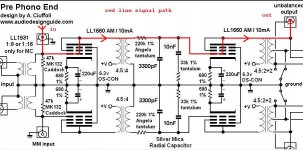

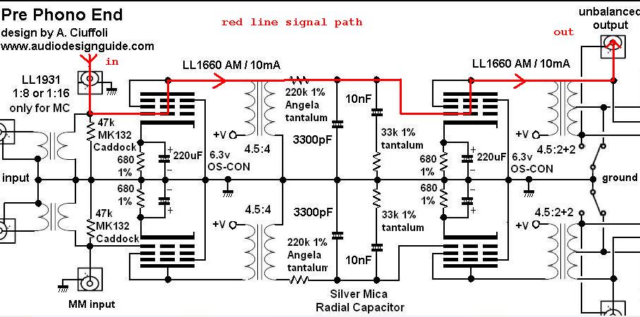

Hello Andrea
thanks for sharing.
You wrote “no compromise phono preamplifier”. But I can see some compromises.
First: The cathode bypass cap. It is not in the signal path but it has a strong sonic influence. Signal current causes voltage droppings and these are added (or subtracted) to the input signal between ground and grid.
Second: At high signal frequencies, there is more signal level at the grid of the input triode than at the output triode. Means dynamic loss at high frequencies.
Third: You have transformers in the signal path.

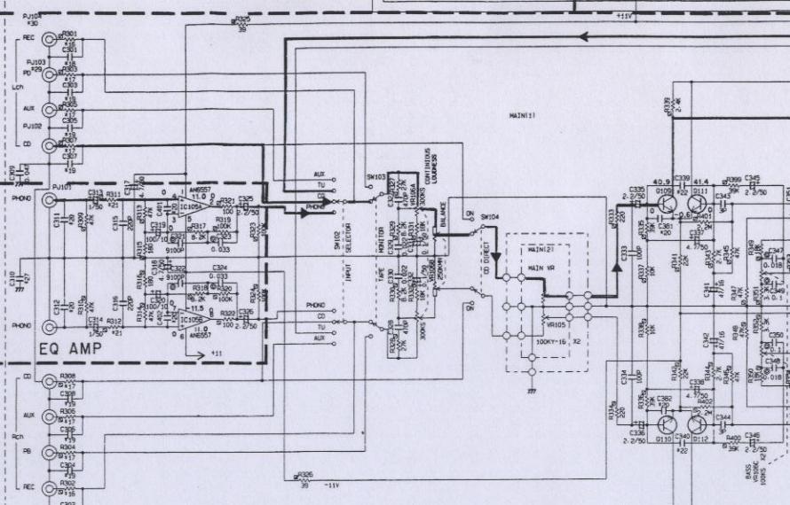

Yes it is. So are the EQ caps. So what? They are far closer to "ideal" than the transformers.
@ #6
Hi SY,
try to understand the difference between
signal path and current (loops). In the picture the red line shows the singal path, the green line shows the signal current in the output loop.
Comes from Have a look at some commercial schematics. This is the common way signal path is drawn.
I know, in the audiophool word it is different ... 😉
LG Darius

Since the expression for voltage at any point in the signal circuit includes terms involving the cathode impedance, the cathode impedance is certainly in the signal path.
How does drawing a red line eliminate the cathode impedance terms from the expression for voltage at any point along it?

The red line shows the signal path, that's all. Drawing the red line does not "eliminate" something. I'm sorry. Please note #7.

How does the "signal" know that it doesn't go anywhere else? Is there no signal at the cathode? The bypass caps are perfect? No "signal" goes through the RIAA caps? They're an open circuit?
Drawing a red line doesn't change the flow of charge or take terms out of the transfer functions.

Most of the input tube's AC signal current passes through the cathode cap, any 'errors' are reflected back as a grid-cathode voltage. The cathode cap is very much in the signal path.
Re: @ #6
The red line appears to pass those transformers right by.
If the red line defines the "signal path", then of what use is consideration of the "signal path" since there are more components out of the "signal path" that influence the signal than in it?
Count me among the ignorant as well, since the last cap before the transformers is also in the signal path.
