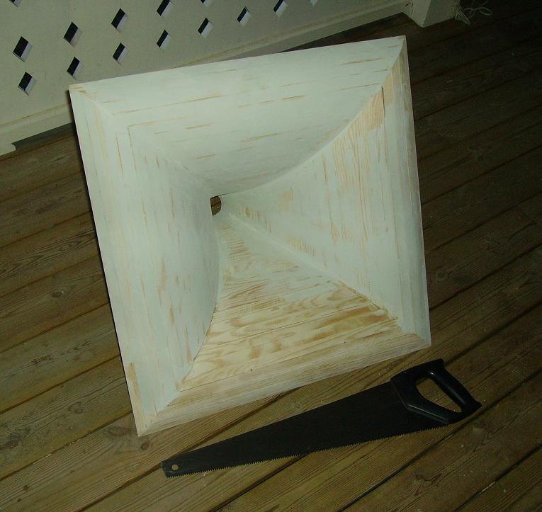

A couple of months ago I traded some tubes against a pair of Eminence 1" drivers that would fit the EV horns (HR90 to be exact), still not knowing what to do with them.

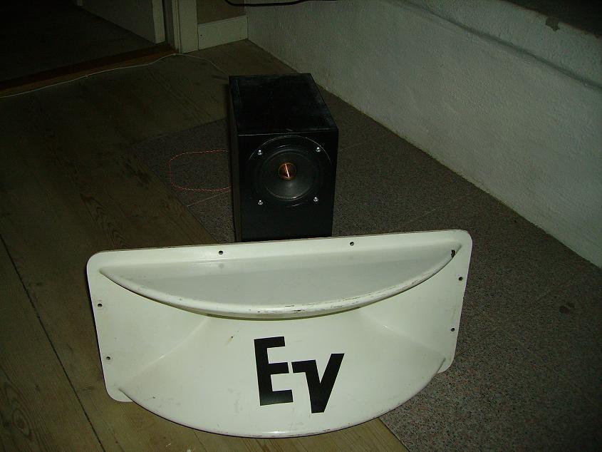

One late evening a couple of weeks ago I suddenly felt unusually creative and decided to lend an ear to those horns and drivers just to calm my curiosity.
After spending an hour assembling and connecting them with just a simple first order crossover (read: 30uF russian PiO caps) it was time for the moment of truth: would they sound as horrible as I expected?
The answer was a big "no". Obviously nothing below 500Hz or so but what was there sounded smoother than expected and even laying on the floors these horns managed to produce a quite impressive soundstage. Interesting...

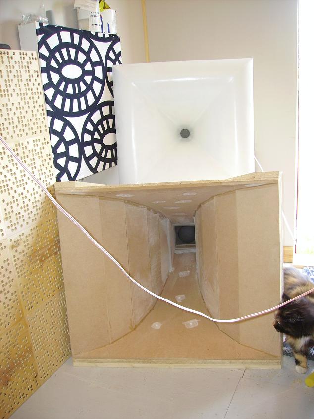

The lack of bass was quickly fixed by hooking up a pair of CSS FR125 drivers in aperiodic boxes. As I had no crossover coils at hand so I just tossed a pair of towels over the CSS´s, acting as mechanical lowpass filters...:bigeyes:

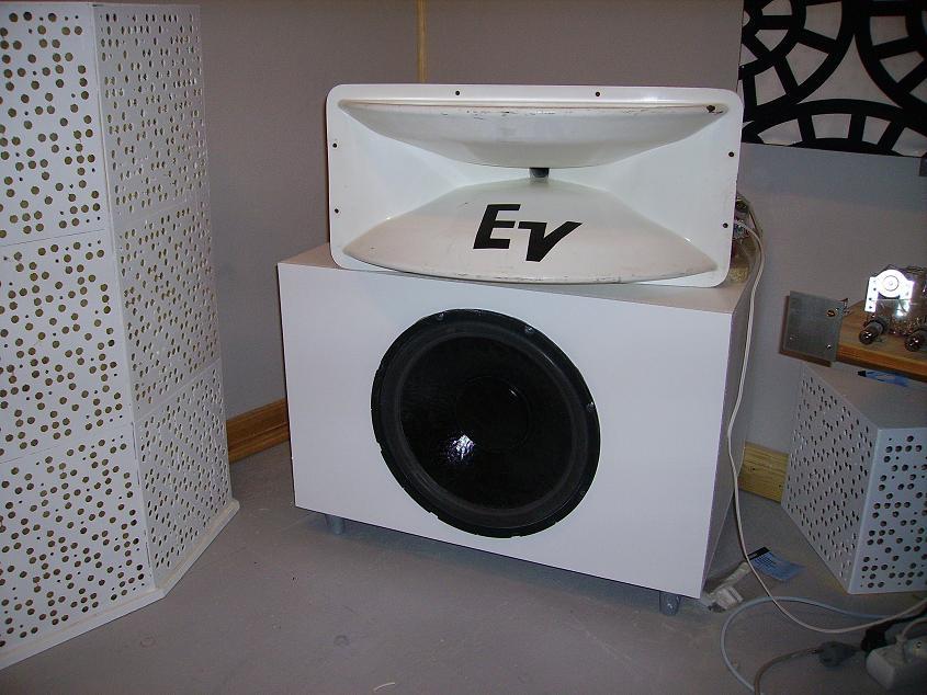

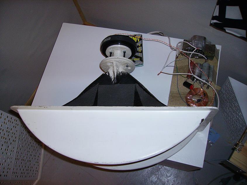

Obviously, those tiny CSS drivers were nowhere near capable of matching the sensitivity of the horns so I decided to move the horns out to the garden shed and hook them up with my 120 litres closed subwoofers.
After a deep dive in the junkbox I found parts to build a pair of simple 6/12dB 580Hz crossovers:

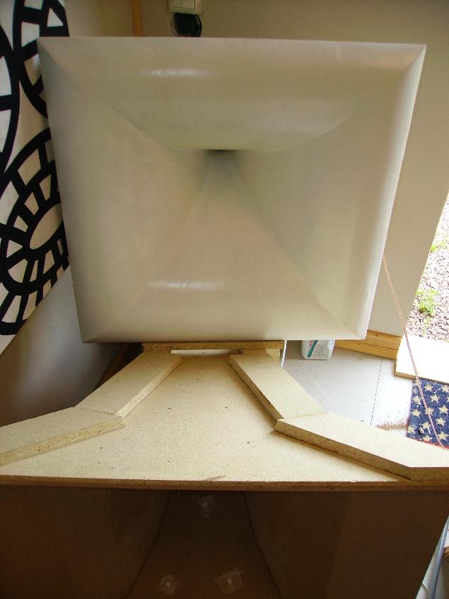

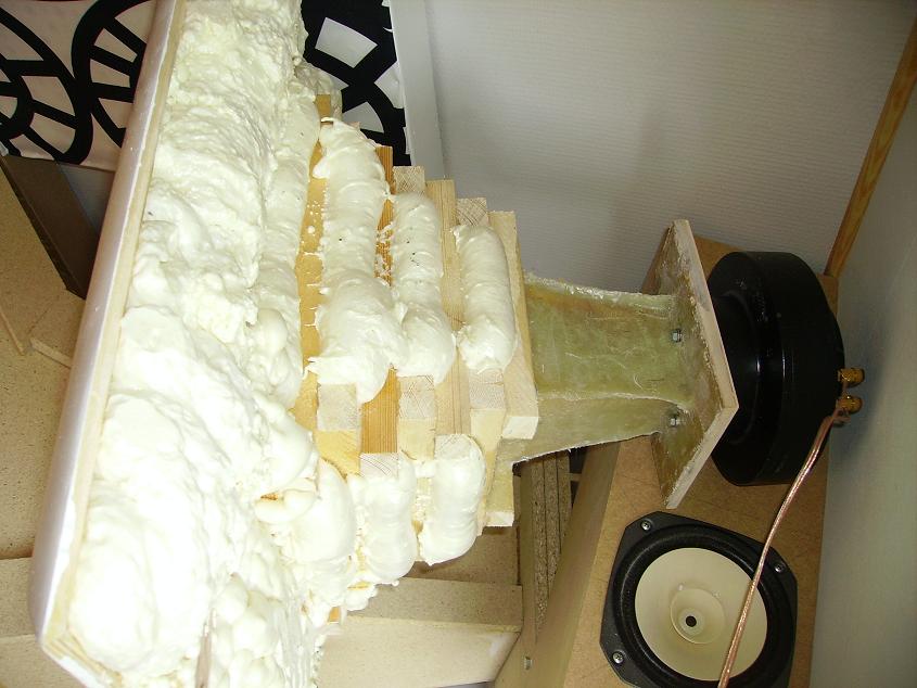

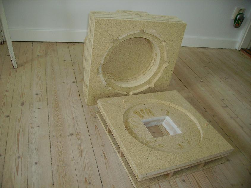

My 15" subwoofers are doing quite well in the bass department but they´re a bit "slow" in the upper bass.

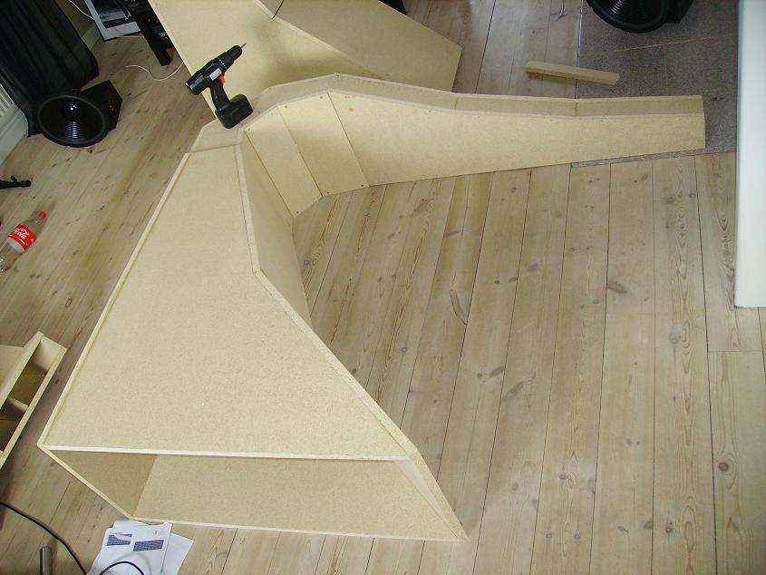

Something more dynamic was called for, resulting in a new project:

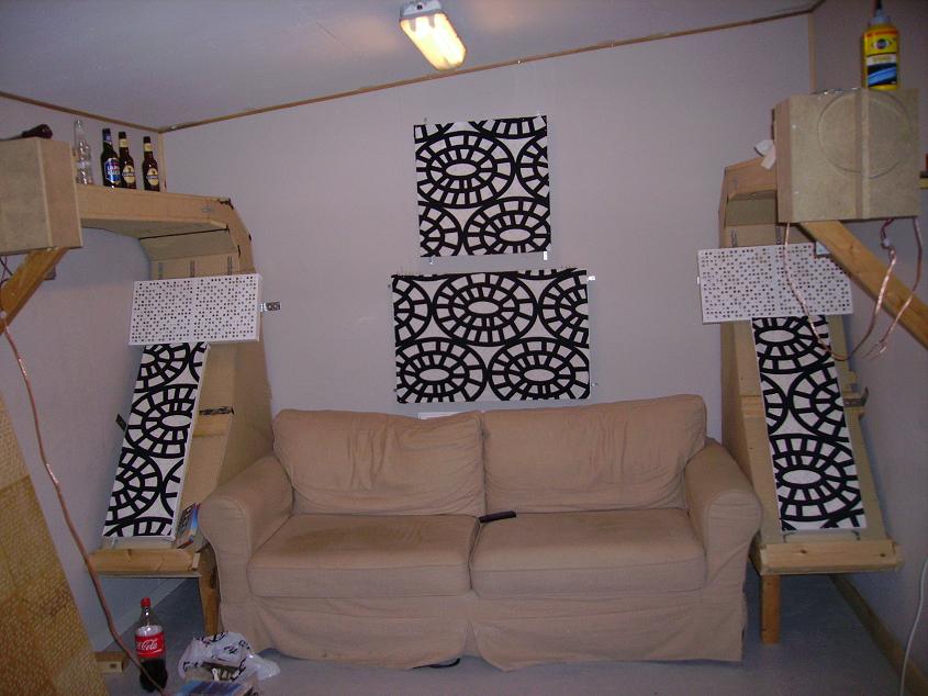

With just a few hours of work left before the initial listening test of the midbass horn disaster struck: One of my cats decided to shred the dustcap on one of the JBL2202H drivers into pieces...
Fortunately that driver wasn´t in a very good condition even before the attack which somewhatt lessens my pain...:whazzat:

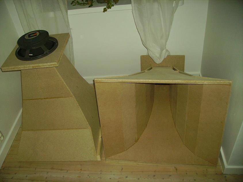

I love it, especially the ingenious use of beer bottles to dampen resonances!
Was floor-loading of the bass horns part of your design from the beginning? What difference do you think it would make, if the mouths of the bass horns were pointed directly into the room, perpendicular to the floor?

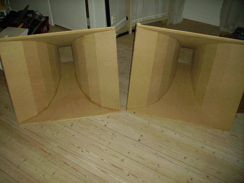

Th bass horns were originally designed (by linnar, www.kensonpro.com) as folded horns that would fit inside a standard wardrobe. After consulting the designer I shortened them from L=340cm to 300cm and rearranged them to load against the floor/corners.
They should probably hang a bit higher from the floor but this position works fairly well, giving a full blast down to 38Hz.
I use Eminence Beta 10 drivers.
Another front view.
The speaker wire hanging in front of the horns goes to the left channels bass horn, a very temporary solution.
The cat seems a bit suspicious about the horns...
