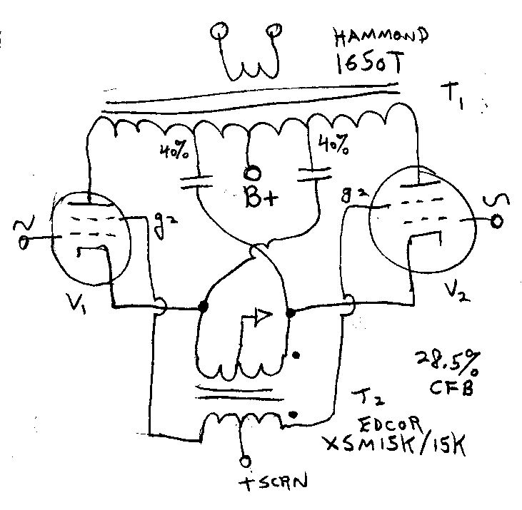

A roughly similar scheme is attached. 40% UL taps on the OT xfmr provide 28.5% CFB. Some advantage here in using more than half the primary by each tube for better coupling in class AB during switchoff. The nominally 2K Ohm P-P Hammond 1650T provides about 4K P-P "equivalent" in this configuration.
Could put caps between the cathode and screen of each tube also, less stress on T2 then.
The cathode windings on both sides of ground are both driven by each tube independently (nothing has to pass thru the xfmr to get both phases), so they can be used for high bandwidth feedback taps for a driver stage if wanted.

Just think, If you did a CF with %60 g2 feedback, you would have an inverted ultra-linear.
Common cathode w/ %40 NFB ~ Cathode follower w/ %60 PFB
