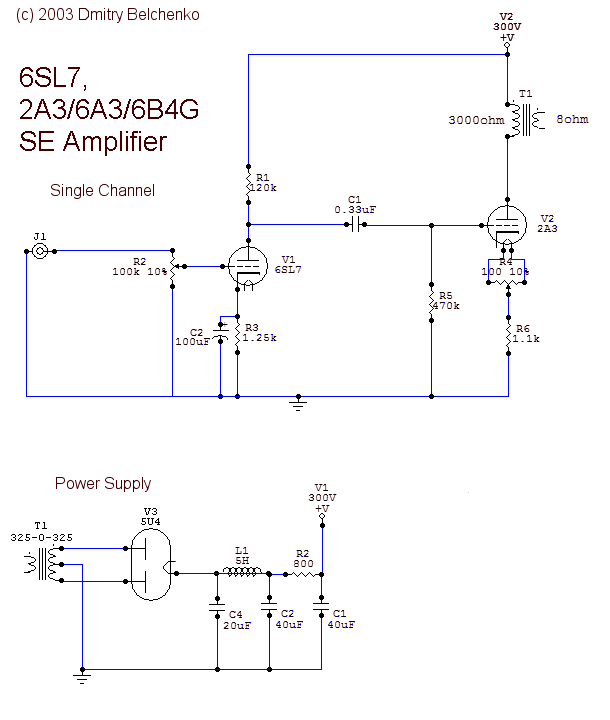

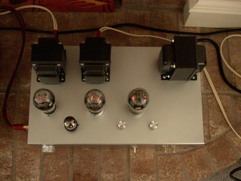

Well I finally got all my parts in last week, redesigned the power supply, and changed the 2A3 B+ and bias. I finished soldering last nite at around 11:30, plugged in my test tubes, hooked up a speaker and a portable cd player and.... Wam!!! sound!!! I was really surprised that it would work at all on the first attempt. So now its working very well, although the hum is a little higher than the PSUDII predicted 8.4mV; this problem will soon be corrected when i change the 5H choke to a 15H. In addition, after hooking it up with the proper components (Cambridge Audio D500-SE, and Boston Acoustic VR-975 Lynnfield Speakers) and plugging in the right tubes (all NOS, JAN Phillips 5691, Sylvania 6A3's, and JAN Sylvania 5U4G) I was blown away by the sound, so transparent, so smooth, now I know what all the hype is about DHT triodes. Although I was in a state of mania while soldering and didnt take pictures of the progress, here are some pics of the final result, in addition to the schematic.

That looks really good! I'm thinking of tackling a 2A3 amp soon, and this is a schematic that I hadn't seen before. I have a few questions:
* Is that a standard Hammond aluminum chassis? What finish did you put on it? It looks pretty nice. Also, what tools did you use to for the metalwork?
* What are the two knobs on top - the hum trimpots?
* What do all the switches do?
* Could you post some pictures of the wiring inside?

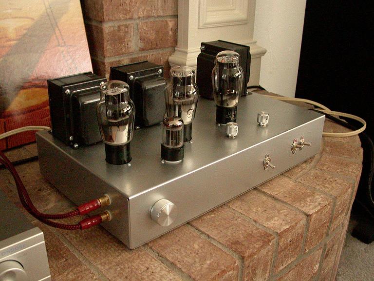

The chassis is Hammond, but steel, I didn't think the aluminium version would hold the transformers without sagging. The finish is automotive pearl silver spray paint. For tools i used a drill press, hand drill, drill bits including hole drills (1 3/8" and 1") for the socket holes, i used a rounded file to finish the holes of and to bring the 1" hole to the 1 1/16" needed.

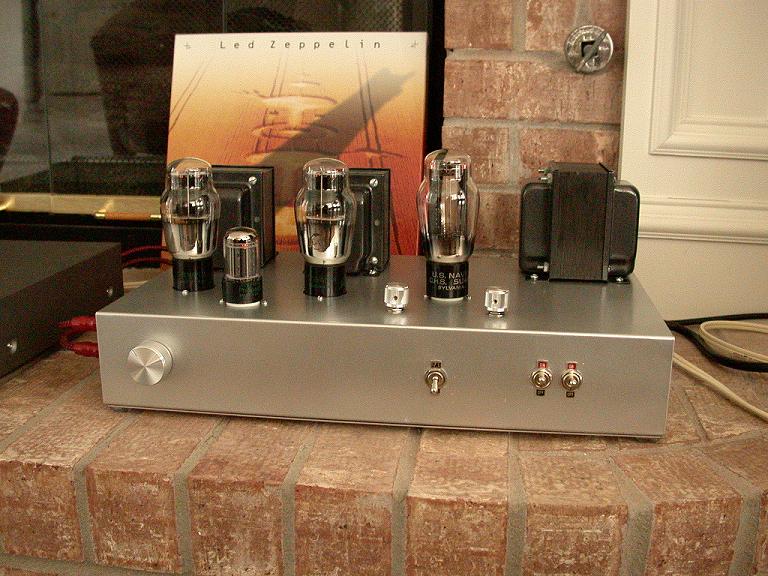

You're right about the knobs, they're hum trimpots. The switches left to right: filament voltage selector (2.5V/6.3V) to be able to run 2A3's and 6A3's, HV winding to rectifier, primary winding switch. Pics of the insides might be added later, check previous posting about manic soldering rush, hehe.

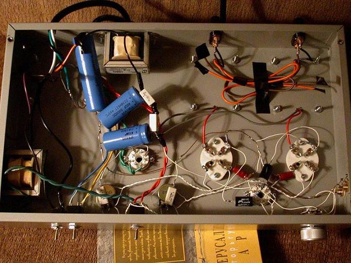

Morse, I didnt take offense, and sorry if it seemed that way, I was just sayign I planned the layout to avoid hum and all that nasty stuff. I decided to go and try your suggestions, sadly did not help much, so I guess I'll get a bigger choke and see how that fares.
Fdegrove, haven't tested it with 2A3's, and I dont know about inductive coupling, after all the PT is 90 degrees in relationship to the OPT's, or am I missing something?
Anyway while I was in there I took a pic, here you go.
Mig...first of all your amp looks very nice!!...Job well done....If I could give you hints on why you "MAY" be getting noise is that your wiring and placement of components needs to be straightened up....you have too many wires all over the place and its just an invitation for noise.......maybe some perf board and tie wraps would do the cure and you would be set!!!:idea:
Cheers!!The DIRT®
Hi Dmitry;
No problem; I was afraid I'd been a little cavalier with my comment about wiring. I remember how long I agonised over the layouts of my 2A3.....
Sorry to read that the 'hum monster' is still with you. Yep, sounds like you've got a good plan there. FWIW I'm using a 10H Hammond 193M in mine.
Those PS filters look really familiar!! 😉 I'm using Sprague Atoms, too! You might add some .1uF 800V bypass caps (series pairs of .22uF 400V film and foil caps) in parallel to the main filter caps - I did and was really happy with the results.
One other "little tweak" that worked wonders to make a smooth sound even smoother and more pleasing was the fitting of an "X rated" safety cap to the mains in; I've standardised on .1uF 250VAC Panasonic brand class X2 interference filter caps in that role and am very pleased at the results of a 90 cent capacitor!
One word of warning for anyone reading this: under no circumstances should a non "X" rated AC safety cap be used in that role; some of the things that make an "X" cap what it is are a built in tendency to fail open as well as fire retardent potting. Any other type of cap is a fire hazard as an AC mains filter!
Anyway, good luck on your amp! It looks like a winner!
Morse
Suggestions that may help, based on my experience building
SE amps, they are very susceptible to hum coming from insufficient
filter. I see you use 20uf and such, try using 220uf/450v after the
choke and see if it would help.
Alex
