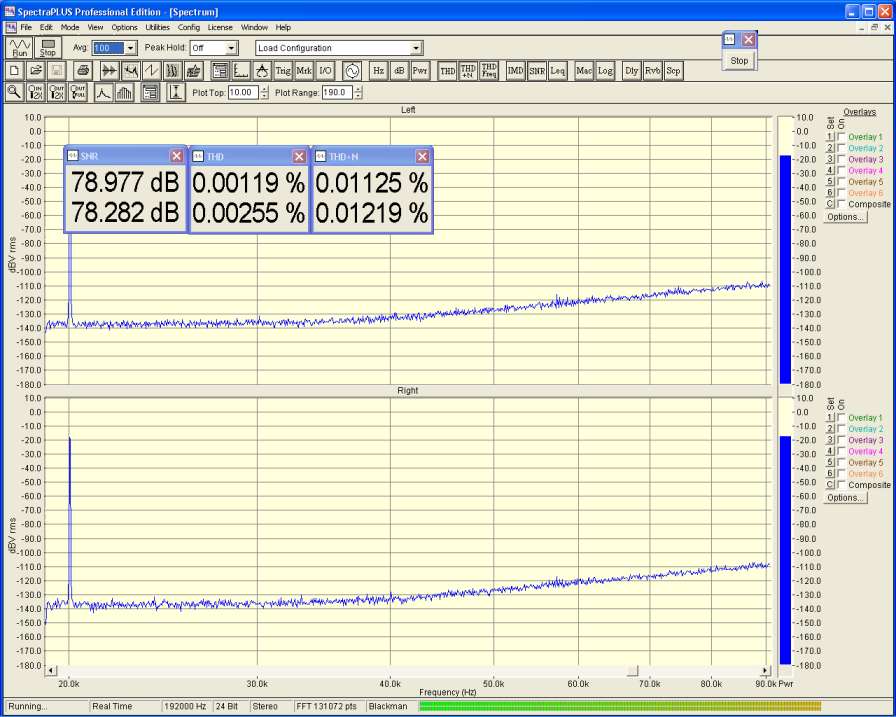

Stefanoo said:
would you mind posting your results (screenshoot of Spectraplus and picture of your set up)?
Since this soundcards are standard products I don't think an item can consistently differ from another (for same settings and same program management).
Xp Pro 32bit P4 3GHz 1GB mem
Settings on Spectraplus demo as yours, only 96kHz, 48kHz would not run on 24bits.🙁 Left channel only using a short coax on jacks I just made for it, so to avoid longer cable and RCA to XLR adapter for input, and RCA to Jack for output that I had. I post one from ARTA too, that did the 48k/24.
THD is REALLY far worse than yours. Any ideas of how I can do better with dated PC and notebook?😀 My input pot is at minimum and ''Direct Monitor'' disabled.

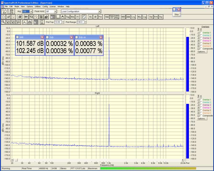

i will give you some advice that i am sure they will fix your problem since if i haven't understood wrong you have the same plattform as i have (win vista 32bit).
Assuming you have the latest firmware and the latest EMU drivers downloaded, then......to bad...you are busted 🙂
apparently with the previous releases you woundn't have had this problem.
But anyways there is a solution for it:
step 1: select desidered sample freq on EMU control panel (i would suggest 48KHz since that is the freq where i get best results: i suppose if i would have had the sistem of the other guy i mean X64 8GB and so on...maybe an advanced setting would have offered better performance)
step 2: select the same sample freq on Spectra settings
step 3: select on spectra plus under options menu -> devices
step 4: click on adjust gain and then double click on EMU (you have to do the same thing for both input and output)
step 5: select advance tab on the menu will pop up
step 6: finally select the same mode you are going to use coherenlty with the frequency previosly chosen.
That's it.
I think that you will be able to properly run.
Let me know if this work and please post the autoloop test with those settings so that we can compare..but you are likely going to have the same performance...which.....as PMA said....is very good (on Vista with the right settings i get -150dB noise floor....which is excellent)
Hope this helps.

I have Windows XP professional 32 bit actually. I get slightly better THD at -10dB 0.00053%), but the posted pic is at -9 to keep up with your exact settings. Also tried PMA's suggestion for calculating SNR at -60dB signal and then adding 60. It showed 61dB so that makes it 121dB for such a way. Thanks Stefano!

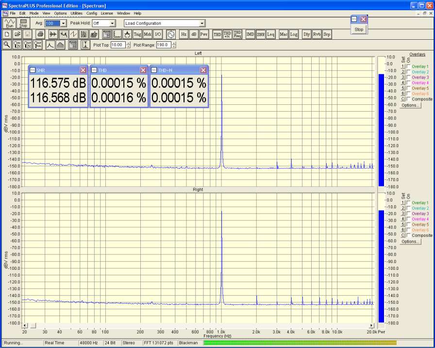

0.00041% and -150dB noise floor from 300Hz to 24kHz with the USB one at -15dB like your level. That's the best I will ever get with tracker pre, and its super for my needs. Buttons and USB cable give the edge to your PC card. Thanks Syn08.
You have most likely a problem with the 🤐 PatchMix. Use the default profile and mute down anything not absolutely required.
