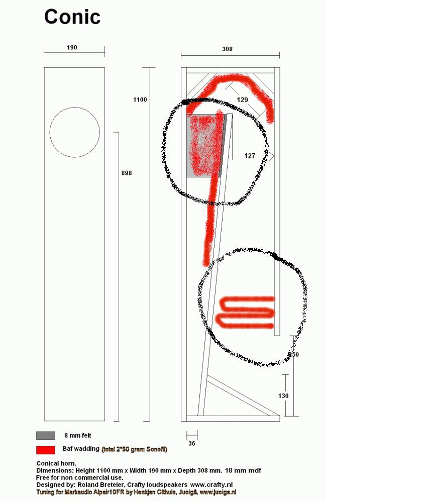

and a sketch:
and guess why I have not made a proper drawing

clarification from newbi
The shaded area at the top left of the right hand view, I take to be the driver mounted. I just wondered since it's shown as a box if that is what is meant or does it simply represent the driver installed onto the baffle.
And lower down on the right above the opening, I take the squiggly
red lines to be suspended dampening held in with a mesh?

Re: clarification from newbi
the red lines just above the port is damping material (about 50 grams of BAF (the white stuff)). in my case it just stayed in place by putting it there. so the other 50 grams are evenly distributed where the other red lines are, so a bit behind the driver, and some in the top
looking forward to hear your opinion of this design, I hope you like it as much as I do.
yes that is the position of the driver, so port is at the back (yes, this is important). the shaded grey area is meant to represent where the walls of the cab are lined with felt (8mm thick approx).madawasca mike said:The shaded area at the top left of the right hand view, I take to be the driver mounted. I just wondered since it's shown as a box if that is what is meant or does it simply represent the driver installed onto the baffle.
further clairfication and thanks
That's is most helpful and we can begin our project. I am still a bit unsure how the sonofil stays in place in the upper portions of the enclosure since it seems to defy one or the other of Newton's laws. Or
does it get glued?

Re: further clairfication and thanks
(I guess that Acousta-Stuf Polyfill will be the equivalent available on your side of the pond of Sonofil )
I used staples to keep it there, but some glue (spray-on) might also do the trickmadawasca mike said:..... I am still a bit unsure how the sonofil stays in place in the upper portions of the enclosure since it seems to defy one or the other of Newton's laws.
