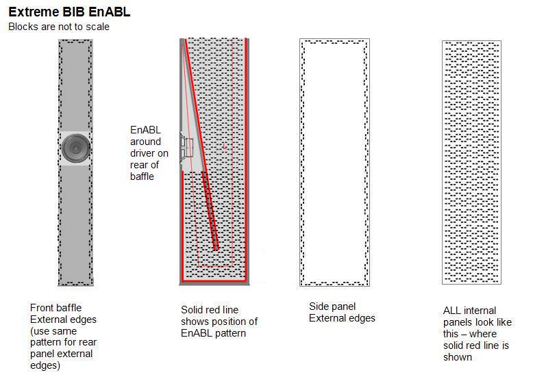

G'day,
Firstly, hats off to Bud Purvine (BudP).
Bud owns the patent for EnABL and has very generously made his technology available to the DIY audio community.
I have been exploring application of the EnABL pattern to baffles, ports, mouths and inside speaker cabinets for over 12 months now.
This is a different process to the EnABL application used for drivers.
This is an extreme application of cabinet EnABL as I would apply it to a BIB.
BLOCK MATERIALS
Materials that have successfully been used for cabinet EnABL include:
- PVC duct tape
- Norton 'All Weather Tape' - clear tape, thicker than duct tape
- Pin stripe tape
There are probably many other materials that are just as effective, they just haven't been tried yet.
BLOCK SIZE
You will need to use the EnABL block size calculator.
For baffle and external edges
- enter 18 block pairs
- enter 4 x baffle width as the circumference.
The calculator with give you the ideal block size for the baffle and all external edges.
For the internal block size
- enter 4 x internal cabinet width as the circumference.

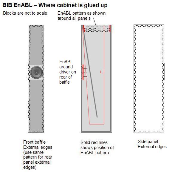

For internal cabinet EnABL, I have laid the EnABL block pattern onto sheets of clear contact (self adhesive stuff you use to cover school books) and then stuck the sheets to the inside walls of the cabinet.
Alternatively, you may find it easier to cut strips of tape to the appropriate thickness, stick them in place on the internal panels, then cut the blocks with a blade.
BLOCK POSITIONING
Please note that the EnABL pattern needs to be positioned one block width from the edge of the panel
Have a look at the attached pic.
Note that the blocks are NOT drawn to scale.

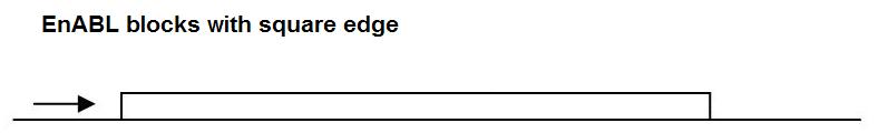

Some thoughts on EnABL pattern material:
- blocks must be proud of the surface
- block material must allow for good airflow over them
- thicker blocks seem more effective than thinner, although I suspect that there is a point where you can get too thick and create problems, especially with ports and mouths.
- the edge of the blocks should be square (see pic)
Vinyl sign material will work.
How important is this square edge? When EnABLing a driver with a pen or a brush (like I did) it will be hard to get those square edges. If I look at my drivers then the edges are not sharp. Also when using the pens from Ed's kit I realy wonder if that gives square edges.
Do the square edges also apply when looking from the top at the pattern? Where the pattern gets real small I resorted to dots...
Thanks,
Jeroen

G'day Jeroen,
The cabinet EnABL that is being described in this thread is a completely separate process to Bud's driver EnABL.
The square edge comment relates to cabinet EnABL only.
I know it can be confusing, but it's important to view the two as separate processes.
Things that may be relevant to one do not necessarily apply to the other.
