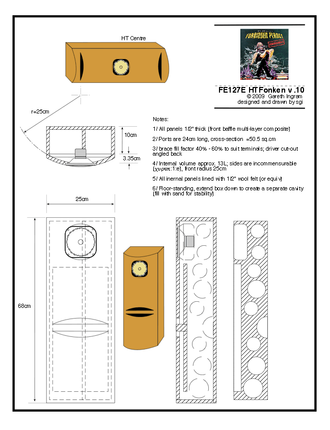

V8 Fonken design ?
Well, those of you familiar with the great Fonken family of designs from planet10 will recognize this design - it's a 'nod' to Dave for sure 😎
And if Dave has time to pass comment I'd be grateful - I've tried to produce a design with the minimum possible width and depth for a traditional Fonken cabinet as this better meets the constraints I face for in-room HT installation.

Hi Dave,
Can you say why the chamfers would be a problem ?
Even with my squashing the depth down from the regular Fonken I'm thinking it's probably unsuitable for horizontal mounting, there's simply too much weight to cantilever to put this on a wall and I'm not sure that the appearance of this design works so well horizontally. I'm going to play with this a bit more, but would love your thoughts on whether the ports would work if they were folded as in: http://www.diyaudio.com/forums/showthread.php?postid=1722155#post1722155 ? - after all the fancying around I'll probably do a simple box based on this if you think it's a go.
I have gone back to the Fonken-tuned floorstander as it is a shallower design. I'd really like to know a bit more about the port design. The cross section of the port is not nearly as 'thin' as the regular Fonken so it won't have the same level of 'resistance'. I assume this is because you were limited by the width of box. I would like to know if you think it's worth trying to accommodate a port that is thinner ? The attached drawing shows one way that I can see for doing this and at the same time I need to move the port to the front to allow wall mounting. Do you think this has a chance of working (no doubt you have built and tried many different configurations) ??
don't pay too much attention to the curved front, it was a thought experiment as you say and it could just as easily be flat. I do think it can be made curved but that's not the point - still trying to understand the consequences of tweaking your designs to suit my application.

Gareth - I'll let Dave answer most of your "technical" questions, but in the meantime, I'll offer the opinion that any potential benefits of curved baffles would be offset by the complications of fabrication of enclosures of the aspect ratio of the Fonken series, and most specifically, the mounting of the driver .
It would certainly not be impossible, but I think would definitely add a degree of difficulty to the build, particularly as your drawing appears to imply a recessed, flush mounting.
They are best all the way round the box, but if you are only doing 2 they should be on the sides....
As to whether tihe idea in the 1st post would work... in the Fonken167 we scored big time...
The FS is probably the most compromised sonically (but it is no slouch -- we listened to a pair quite extensively yesterday (with FE127eN)). To keep a tall skinny box like that from becoming too much of a TL the vent needs to open up near the middle. To get the bass reinforcement of the port, it needs to exit at or near the floor (and or wall), to make it simple you want only one.
You could add a 2nd port and half the depth and end up with something interesting.
Thot of many, drew many of those (you variation included), released a fraction. You need to drop by and look over my shoulder while i flip thru the variations in my CAD SW.
dave

Gareth, there's a bit of an artifact in the angle of the photo and the camera flash - as with the "Prime" and "steens" the ports do indeed extend almost to the rear panel of the cabinets.
This pair was the initial prototypes, and the inside of port slots and back were not painted out before assembly - as a result, under certain lighting and viewing conditions, you can see through the slots to the back panel.

In boxes with volumes much smaller than the regular Fonken the tuning requires a shorter port length and I would have thought to keep overall port 'resistance' the same the port requires a higher aspect ratio ? If so, what should it be ?

As I said, I'm now looking at the mFonken for the rear surrounds. A question (in addition to that about the port aspect ratio above) is your advice on box size:
What is a good target XO freq. between the rear speaker and the sub ? I have read that popular opinion is to put it at around 80Hz. In this case, the mFonken (4.5L) goes down to 91Hz (3dB). To achieve 80Hz I need to aim for Vb=6L.
The front speakers can and will be larger so I can use them to enjoy stereo - will a big mismatch in box size between front and rear be a problem for HT ?
Lastly, how do you like the idea of a square Fonken from an easthetic standpoint (attached) ? - with the internal port structures it isn't actually square inside so no worry about resonance issues. It just happens to be a good form factor for my rear surrounds. I wonder what the interior design police would say about this !
