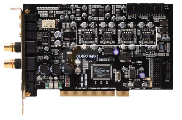

I've just taken my first step into the much larger world of audiophilia (not a very attractive name, really) by purchasing a nice sound card for my computer - it's an HT Omega Claro Halo.
The documentation says that it is meant to have the op-amps switched out as the stock ones are low-end, but of course I'm pretty lost in this situation.
It says the current ones are 4580 (JRC) - which ones can I even look at that would replace that one?
And I know it's all subjective, but can anyone recommend a good one that would work in this implementation?

Are the current opamps DIP-8 or surface mount?
What voltage is available at the power pins of the opamps?

Hmmm, I'm not sure what the difference between DIP-8 and surface mount is. I know that they're designed specifically to be popped in and out for experimentation, so I won't need to wrestle with getting them in and out. They look like all the schematics, but unfortunately that probably doesn't help you 🙁
Again, I'm not sure about the voltage, but it's a PCI card so I believe it's max voltage would be about 5v - that would jive with the current op-amps and their low voltages.

OK, socketed means they're DIP-8.
Well, at +/- 2.5V, or a single ended 5V, depending on how it's set up, I'd be looking at Analogue Devices AD823.
If you're up to soldering surface mount chips to adaptors (if you're unsure, that's a no, but maybe you know some-one who can) also consider AD8066.
You could also try LM4562 (same chip as LME49720 as recommended below). It's only just barely rated for +/- 2.5V operation, but it's a very good chip.

TheSeekerr said:OK, socketed means they're DIP-8.
They indeed are DIP-8 in sockets.
http://tangentsoft.net/audio/opamps.html - there's a partial list. It doesn't include the LM4562 - you can find reviews of that chip if you poke around the site a little - in short, it's very good, a transparent chip that never feels like it's adding its own signature.
I think a common combination has become use LM4562 on any inputs and use OPA2134 on any outputs.

Depends on the load to be driven with it - if it's feeding the input of an amplifier, LM4562 is a better choice, but if it's to feed a headphone directly, OPA2132 is a better choice due to its higher output current.
Can you check if the ICs have 24V across them or 5V (pin 40 to pin 8, you can remove the opamp and insert it into the PCI slot, and then switch on and measure the voltage).
LM4562 does not work very well at 5V. I know, I tried. Replacing a 4558 with a 4562 in a SB Live! card I had required me to hack up the power line (cut trace) and rework it to supply 12V to the chip, with a RC filter so it finally was around 10V).
They work very, very well with +/- 12V supply, some card makers are intelligent enough to run them like that (and stick to PCI, as PCI-express cards have no -12V supply).
According to the Opamp distortion paper, as memory goes, the best load distortion characteristics were for the AD797 (unusable in your card) followed by LM4562. I'm currently using a NE5532 in a headphone amp application and find that it is able to deliver all the current needed for a pair of 32-ohm phones, while sounding very good (need to keep input impedance low, but otherwise no hassle to use).
4562 needs good decoupling. I would suggest OPA series if you aren't planning on any hardcore modding.

I also have this card, I have no clue on how to find matching amps. Other than using DIP8, what other technical factors determine what's going to fit on there?
I'm trying to complie a comprehensive list of chips that can be easily plugged in there without any modification.
