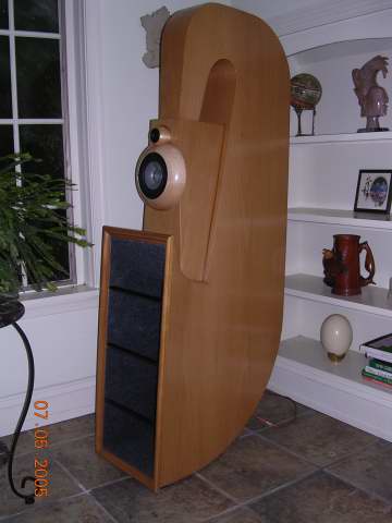

Example of BLH with Jordan
You can use the jordan very sucessfuly in a BLH, probably the same for the AN10. I've tried it with MLTL, but I like the BLH much better, much better base and dynamics. I used Martin king's spreadsheets to design these several years ago.

Hi PJN
They look great!! And I am sure they sound great too 🙂
I don't have access to MJK's Mathcad but I did read his back loaded horn articles and what really struck home was "If done correctly, a hybrid transmission line / back loaded horn enclosure will not require
any baffle step correction circuit which is the real big advantage. Imagine 94 to 98 dB SPL, at a 1 m distance for 1 watt of input, over the frequency range 50 Hz to 15-20 kHz produced by a single driver enclosure that is slightly bigger then a commercial tower speaker system."
Like many people I want to have a BLH but I dont have the space (height or size of room) to handle a massive cabinet. I am sure there is a BLH (TL hybrid) that I will be building soon 😀 Just need a design to make it happen 😉
