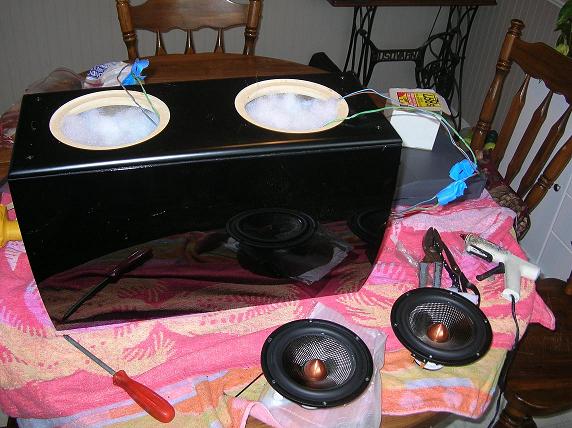

I'm very satisfied how the woofers blended in with the Line array. The sub amp does not have room equalization but does have an equalizer in it and has 10 various controls to boost or bring down the various frequencies from 20HZ to 150HZ. The amplifier (in case you are interested) are Reckhorn 400. Check on their website for information. I used 2, one for each side for stereo effect and I cross over at approx. 100HZ. CSS did sell them and they still may. As mentioned before, Planet 10 has a fair amount of info on these woofer drivers.

My drawings 🙂
Bob specced the BR, i did all the sealed. This woofer perfoms really well in a sealed box. The XBL motor allows you to use a little EQ -- i got them done to 25 Hz (14 litre sealed) in room with a touch of boost at 30 Hz. This is actually lower than the TL (when it rises to the top we'll do a sealed one and repurpose the TL). Next is a 4 SDX7 sealed/side for a more exotic mid-tweeter,
There is a minor mod that need]'s doing to the SDX7 at a minimum that greatly enhances its performance.
I consider the SDX7 to do what most 10s do. It won't go as low or move as much air as the SDX10, but it reaches smoothly up to 950 Hz (with the mod mentioned above) which makes it really easy to integrate with a FR, something that is harder to do with a dedicated subwoofer that might reach to a 1/3 of that.
dave

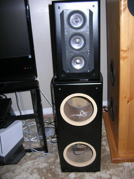

We have a single sealed 14 litre woofer (with amps built-in to support a pair of uFonken). Box walls are lined with cotton felt, and a light fill of polyfluff.
With a single driver 50W seems to do fine, with a pair somethig with good 4 ohm capability is required. I currently use a 150w amp, but that is more for its current capability than the power.
If you double the driver complement, you should double the volume. Have a look at the charts in the SDX7 doc on the CSS site... i show the SDX7 stuffed into a 3.5 liter cabinet, 14litres for 2 drivers gives a modeled system Q of 0,7, but for extended bass duties, a lower system Q is desirable.
The TL started as a sealed box, but when i put in the side-to-side brace (at an angle), i realized how easy it would be to make it a TL. Being a big TL fan i thot we'd try it. Turns out to be shy on volume, but the biggest issue was that it was too prone to unloading the driver, and when a typical XBL driver unloads to its stops it is not pleasant. The TL ended up being stuffed aperiodic and only gives a measured 5 Hz extension over the Fonken* (FonkenPrime) althou with much more weight.
The 17 litre sealed in Tysen, and the single sealed 14 litre in the 2.1 system both go lower with much less liklihood of unloading.
I have some other 7" drivers i'll eventually load into the TL. but they are doing a sufficiently good job now that i'm loath to move tem out until we get arounfd to replacements and that isn't high in the queue.
