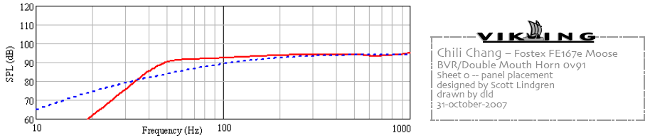

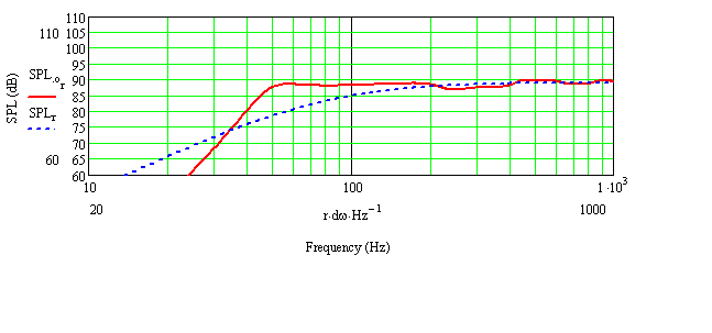

Or alternatively, as I suggested for someone via a PM discussion WRT a box for the Alpair6, a simple MLTL should provide more gain & somewhat less ripple (baffle-step aside, which also applies to the Needle)
30in x 6in x 4.25in, Zd = 2.5in, Zp = 29in, vent 2in diameter x 4in long. Line top, back & one sidewall with 1/2in wool felt, stiff fiberglass or similar.
YMMV of course. Just a thought.
A beginner's silly question :
If I understand correctly, a MLTL uses the length of the housing as a resonator. So I should expect higher order resonances than the fundamental, which need to be damped out by stuffing.
The SPL response you showed looks almostly perfectly flat, and yet the cavity is only damped somewhat on the sidewalls.
Any scientific explanations ?
Patrick
