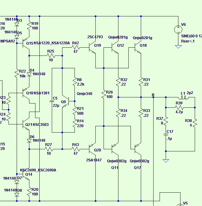

by anatech - When you made your prototype, did you supply the voltage amplifier stage from it's own regulated power supply
Not directly, but I did use current sources (like the krill)
for the diamond, (see attached schema)
and a classic Vbias
with my standard OP stage (frugal based). It sounds great,
but I like complete info..
As far as a input stage I used my frugal3 holman (apt)CFP
differential to drive the diamond.
I have tinkered with this diamond thing forever ,after seeing
the krill and marantz, will not give up..
OS
Hi ostripper,
That looks very close to what I built, minus the bias network.
My findings were that it sounds pretty good, promising. At higher power levels into a 4 ohm load, it sounds compressed but retains that wonderful detail.
This is what I was working on at the time of my accident. Now I don't completely understand my own work. It's like someone else actually did it, and I only have their notes to go from. That is both frustrating and a little scary.
The rest of the amp is pretty straight forward. A pair of very normal voltage regulators for the front end and a standard delay and DC offset protection network. You now have all the information you need. I may scan some of my notes at some time. This requires that I have both the energy and that I don't forget to do it.
Since this output stage is a single "drive line", it's pretty much completely self contained. You can drive it with whatever voltage amp stage that suites your fancy. My input impedance is pretty high, so I use a smallish coupling capacitor (0.22 uF?). DC offset hangs around 30 mV with no feedback, so I'm not really concerned about that right now. It has been driven by both tubes, op amps and various semiconductor voltage amplifiers.
It seems like a very nice building block. Interestingly, I went down this path after testing a signal diamond buffer that merrily drove 8 ohm speakers with very low distortion. The sound quality is very good, so I made it bigger.
That's how I arrived to this point.
-Chris
