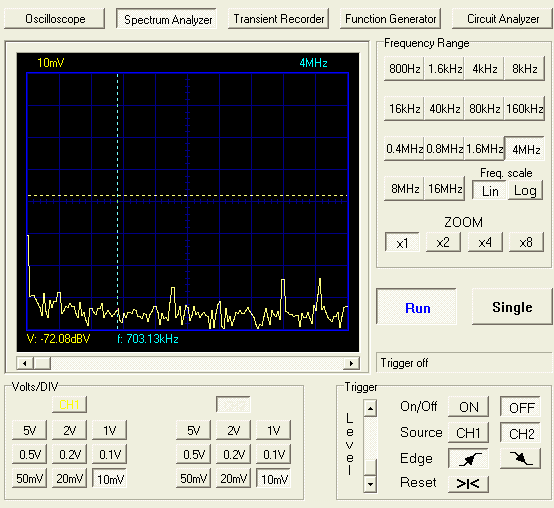

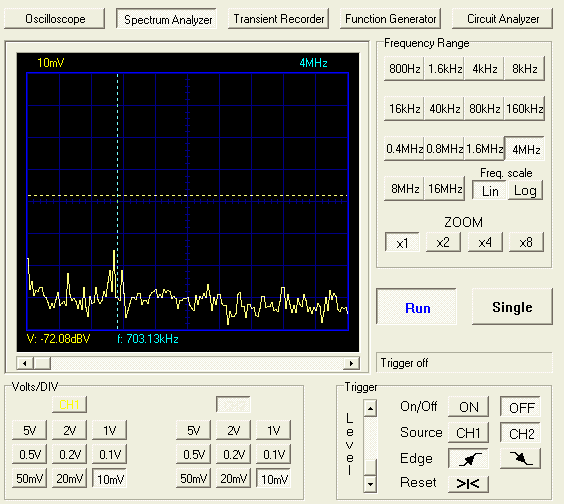

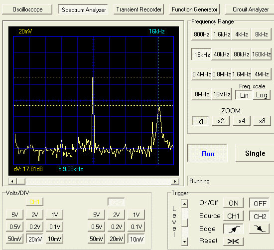

I just did some measurements of which the results seem to point in this direction.
I remembered I had a Velleman PC-DSO stashed away somewhere that I built ages ago. The software needed to run this 'scope also has a spectrum analyzer on board. Nice.
First I hooked up the probes to the input, but that was no good: they prevented the oscillations from occurring, so I moved them to the output (headphones connected).
I looked at some FFTs and they comfirm what I hear. Clearly above the noise floor I can see several frequency components moving to and fro in (opposite directions, sometimes crossing one another). With careful turning of the volume control knob I "steadied" one of those in the audioband. For reference I played a 5 kHz/-20 dB testsignal (test-CD). See attachment.

And another experiment. Having no capacitors handy I used RCA Y-splitters on the input of the headphone amp (HA).
I checked with only the Oehlabachs between DAC1 and HA -> problem. When I add another interlink to the Y-splitter (other end just hanging loose, of course) -> problem solved! That's gotta be the extra few pF of capacitance at work...
This must be one of those "worst case" scenarios that just happened to happen with my setup.

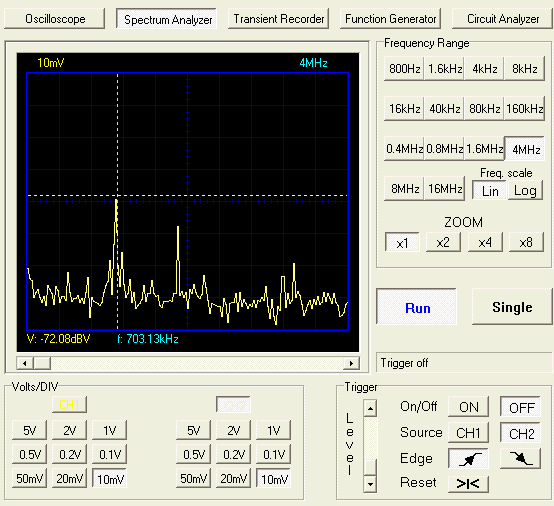

Edit: spectrum with one Oehlbach interlink.
which seems to confirm that the headphone amp is susceptible to the HF rubbish that the Micromega is sending out with the audio signal.
i.e. there are two problems, not just the amplifier.
could this HF be reflections in a badly/unterminated coax?
Apparently this problem is worse with short coax.
I don't know. Adding an unterminated coax to the Y-splitter on headphone amp for the extra capacitance lowered the 700 kHz rubbish a lot (compare attachments post #7 and #9, you may have missed the the image in post #7 which I added after your reply in post #8). I will try with capacitors tomorrow.
