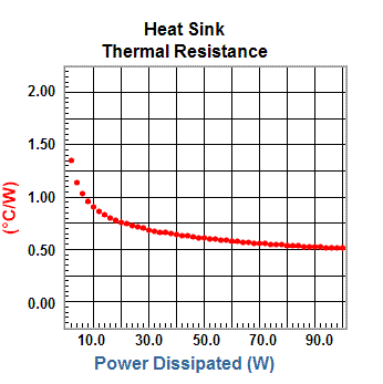

You will not find the thermal resistance for 14,6 W, because the table only goes from 20 to 60 W. At 40 K it is specified with 1,81 K/W. Let us pretend the characteristic were a straight line. That is not exactly correct, but sufficiently exact for out purpose. Just to get the idea.
Thermal resistance at 20 W is 2,07 K/W.
Thermal resistance at 40 W is 1,64 K/W.
So the change in thermal resistance per W is (2,07-1,64)/(60-20) = 0,01075.
20 W - 14,6 W = 5,4 W.
So the thermal resistance of this heatsink at 14,6 W is approximately 2,07 + 5,4 * 0,01075 = ~2,13 K/W.
While you must have expected a heatsink 10 % better than needed, you actually got one that is 6,5 % worse. So instead of decreasing the calculated temperatures about 3 K as expected, they would actually be increased about 2 K. And the bigger the heatsink, the more it will deviate from the published specs, because bigger heatsinks will be measured and specified with higher Pd.

- - Don't rely on the Overture Design Guide or the datasheet diagrams alone.
- Try to find out the heatsink's thermal resistance for the actual Pd you need.
- Don't save on heatsinks, even if you don't always run the amplifier on worst case conditions. Some day you will.

One thing that Aavid provides is a plot of resistance as a function of Pd. Attached is one from a model specified at a resistance of .44. It is the lowest in a very extensive product line.
Note well that over a broad range of Pd figures, it never reaches .44!
That notwithstanding, the Aavid web site has so many extrusion profiles it will likely have something close to whatever profile another mfg. might offer, wherever resistance as a function of Pd is not given. Then it would be possible to get close.
(If I were to construct a catalog search for heatsink profiles, it would start with Pd, an ideal sink temperature rise above ambient, and an upper limit for temperature rise above ambient.)
Good advice can be hard to follow:
Hi Toolr,
look again, that graph is for low power dissipation values.
Take one pair of coordinates:- 95W and 0.5C/W.
That gives a deltaT of 47.5Cdegrees.
Most heatsinks are rated for a deltaT of 70 to 80Cgdrees. It is also rated for the whole of the heat contact face isothermally at heatsink temperature.
Both of these parameters are difficult to achieve in practice.
Most manufacturers will give data on how to re-rate for temperature heated face size, device location, elevation, air speed, etc.
But, back to that 0.44C/W an assume this is rated for deltaT=70degC.
The dissipated power applied evenly over the whole surface will be 70 / 0.44 = 159W.
But any group of devices dissipating a total of 159W will be running with a Tc >= Ta + deltaT + Rth c-s * [Pd/device].
Let's put some real numbers to this.
4devices with Rth c-s = 0.6C/W and ambient air passing the heatsink = 30degC will run at Tc>=123.85degC.
This is obviously running very hot and that's why that graph shows data for low power dissipation.
Clarification
AndrewT,
The tenor of my post was a caveat, so I think we are more on the same page than your response indicates in my reading of it.
You write:
My point was that .5 is greater than .44, obviously; that is, ignore the .44 figure!
Let's add some more numbers to the mix. On the assumption that you have a sink with a resistance of .44, you might think an attempt to dissipate 20 Watts will give you almost 9 degrees C above ambient, when in fact at that Pd you will have a resistance of .75, and a rise above ambient of 15 degrees!
Again, as pacificblue pointed out, you need the figure for YOUR Pd. This can be hard to obtain. Plots such as the one above can help you do that.
But what about off the chart?
I think the assumption that .44 C/W is rated for a deltaT=70degC is risky; I would bet deltaT is higher still for the .44 figure, way higher. Still I agree entirely that we are dealing here with "running very hot," as you put it, and whether the plot covers "low power" I leave to future design(er)s. Frankly I think .44 is absurd; I suppose I should have said that outright. I can't see why anyone would publish such a figure at all. That figure sounds like a heat sink of this type at 200C located in a sub zero freezer.
BTW it is part # 62335.
AndrewT,
You write:
Take one pair of coordinates:- 95W and 0.5C/W. That gives a deltaT of 47.5Cdegrees.
