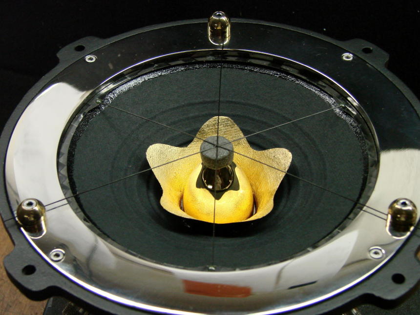

Ok, found another pic.
So it seems that larger diaphragm drivers has a somewhat simpler suspension. Or is it the opposite?
Still havnt found pics of voice coil suspension/spider.
But, if that's too realized with carbon wires, i guess it's pretty easy to figure out how it looks.
Oh my, it almost makes me to want t have a pair of them, just because of the looks.
Its just _gorgeous_.
Lookin that very large (metal?) phase plug I am afraid that the voice coil is not made of paper.
And how is the clearance between the cone edge and driver frame?
It is not clearly visible in the pics, but the edge does not quite looks as free standing, but as if being supplied with a collar, where the springs are attached, so no free/open edge here, I guess-
Anyway, that's one fiendishly clever construction. I love it!

No, it's not about mass.
I think it is just a pivoted attachment to the spring/suspension wire, to achieve longer linear (more or less) excursion.
I guess there is a real pivot/bearing built in the nut where another end of the shorter, heavier carbin rod is attached in the chassis. Could be just conveniently bending rod, too, but that could be pretty fiddly to manufacture.
Of course. Should have understand it in no time, must be only because of the local menu of the holidays. Must be that this ham we eat here has somehow ended in my head and replaced normal gray substance called "brains"

I'll try to give some info on the Fertin model 7.
The model 7, is a driver which the rubber surround has been
removed. The weight of the surround is about the same weight
as the cone. Also , the cone is decoupled from the basket.
This reduces the distortion from the cone break-up. The effect on
the sound : everything becomes clear, transparent,
especially in the mid-bass and bass.
To keep the cone centered, Fertin uses very light and thin carbon
wires. These are attached to 3 different places on cone and the
basket.But the cone is free to move up and down, as you can see
in the picture, but not laterally; thus keeping the cone centered.
You can pass a thin sheet of paper between the basket and the one
and this all around the driver. The space is 1mm. There are not
more cancellation from this than you have in a regular rubber cone.
As for the spider , it's a different technique. The spider is made
of carbon strips that are attached to the back plate and the cone.
The fs of the model 7 is 31hz.
You can use and amp of 2w to 200w to drive the cone.
As you see, the cone being free to move without the resistance
of the surround; you don't need much volume to make it work
as loud as a regular driver. Full range driver are best driver
by NNFB , class A amp (current amp) (read Nelson Pass article)
As to : did anyone hear them? Well for those who want to listen
to the Fertin model 7, you can at the CES2009 in the DaVinci room.
Peter Brem of DaVinci audio has chosen to build an open-baffle:
the Virtù loudspeaker using a 20ex model 7 and 2 pairs
of 30ex model 7.
The Vivaudiolab has a neet design using a surroundless driver.
It difficult to find out how he keeps the cone centered: a type of
mechanical device, ferrofluid? The efficiency is low: 87db and the
cone is rather small (3inch), not much info.
If you have info on other surrounless driver, it would be interesting
to learn about them.
The Fertin model 7 is available in any size from 13cm to 46cm.
