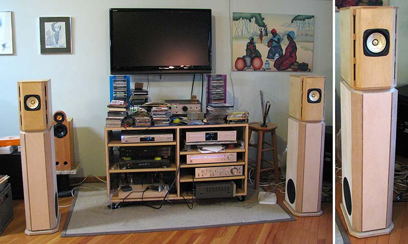

It's been a long time coming but my first speaker build has come to fruition. I finished a pair of the planet10's Fonkens and am very very pleased.
The Fonkens were commissioned by a friend along with an appropriate amp to drive them. Unfortunately the budget didn't allow for the planet10 modified drivers so they're currently stock. The pair is currently running off a 'Bevois Valley' amplifier; a 10W PP EL84 design by Morgan Jones.
Seeing as this is my first 'real' speaker experience I have to say I'm very impressed. I now understand 'imaging' in ways that I have not been able to glean from reading others' reviews. Female vocals, acoustic guitar, you name it, the spatial presentation and detail of the Fonkens with well-recorded material is astounding. The intended recipients room size and musical tastes are going to lend themselves very well to these little guys.
That being said I'm ready to move onto a pair of speakers for myself. I'm currently planning on replacing the pair of KEF bookshelves that I have in my office. I'm hoping to maintain some of the appealing factors of the Fonkens (imaging, detail, that lush mid-range, the 'involvement factor') while hopefully improving in the areas that the Fonken is deficient (bass extension mainly).
My motivations for a different speaker lie in the fact that the Fonkens didn't do particularly well with some genres of my musical tastes. Mainly:

Well, there is a Fonken design for the FE167, which while it doesn't quite match the midrange magic of the FE127, it certainly adds "authority" to the lower octaves.
It's also quite Wife friendly - with plinth base stands approx 1meter tall, 274mm wide x 238mm deep.
When Dave can get some spare time, he'll update the P-10 website build gallery.

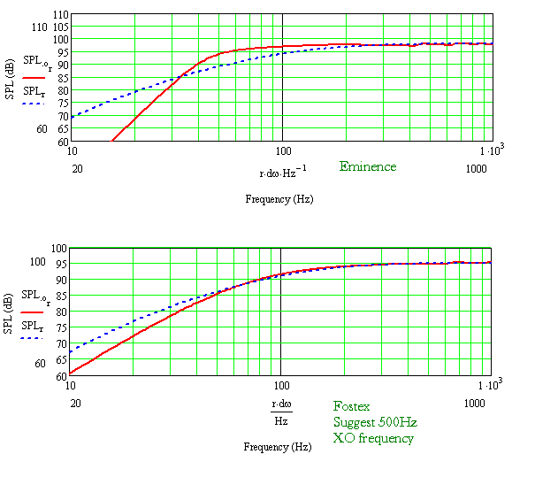

To get more bottom and better dynamics, there are 2 approaches (both already outlined above)... bigger, more efficient driver that shifts more air or take a smaller FR and augment the bottom.
I really value my mids so i chose the latter 1st, adding active woofers to a set of Fonken. I don't need all that loud so the XO is currently at 100 Hz. Move the XO up and you'll be able to get more level & dynamics out of them. Now this approach typically will cost more, but that depends on XO, extra amp & the woofers you use. I really like the SDX7, but they are not cheap (they do thou fit into a pretty small box -- something needed for the woofers to stay in the same footprint as the Fonken). The Silver Flutes look to be a good, less expensive substitute (we are currently working with the 5.5"), but almost any woofer that will go up to about 1k should be useful up to about a 300 Hz XO (unlike Scott i'd be hesitant to go much above this).
Note: i'm currently playing with tweeter above 15k on the system pictured... so my FR has morphed into a mostly FR 3-way.
Going with something like FE167 or FE207 or FE206 (to do that last justice you might be pushing the WAF), will cost less, have no XOs, and have less degrees of freedom to confound things.
