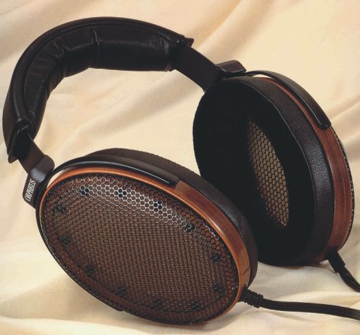

part II:
Within the wooden frame that houses the ESL-capsule two sheets of finely stamped steel protect the capsule from anything touching it.
Each capsule is wired by a three-wire-cord to the supply, hence, there is no PE-wire leading to the HP.
The bias voltage is 500Vdc and the associated amp could put out ~400Veff (1130Vpp).

Actually the charge stored on the diaphram can do some harm... Years ago I was following the instructions from Acoustat regarding the discharging of a panel while detaching the interface box. The gunshot-like sound and bright spark casued me to flinch and I smashed my elbow into the equipment stand behind me as I relexively pulled back! 😱
The Orpheus solution is a good one--grounded screen to shield fingers and outer ears from HVAC. Of course, from an electrical point of view, the stators are what I worry about. Quad used front (extruded) and rear (expanded) metal grilles on the ESL. Acoustat used way thick plastic stators (fluorescent light diffusers?) and cloth. Dayton Wright used plastic bags and grille cloth. Infinity used cloth grilles, same for Sound Labs, Koss and KLH. Other than Martin Logan (and DIY ESLs) what other ESL allows the stators to be touched directly? There are some small ESLs from Holland or Denmark that look like Martin Logans, they too may permit touchingthe stator.
How are you guys protecting yourselves and others from feeling the stator "pain"? Is there a coating I can apply in my basement workshop?

@jbeede: If You want correct information...reading helps! 🙄
The Orpheus doesn´t use grounded grids!
The protector film has the advantage that it is a ´passive´ protection, that doesn´t rely on any connection to PE or special circuitry. Too even the smallest things that may protrude through to the stators or even the diaphragm, e.g. hair, is prevented from doing so. Ageing effects should be reduced as well.
A grounded grid probabely won´t prevent hair from getting in contact with the stators.

oh, btw. My stators can be touched without any harm at full play too ;-)

Hello Calvin,
Is it your habit to insult people whom you don't even know? I do read English rather well, your reply I cannot easily decipher.
You have measured the resistance to chassis ground from the formed screens on your Orpheus? Hard to imagine that Sennheiser would allow any metal to float in the presence of an electirc field. Why would I care if my hair touched a stator? I should think that woven hair would make a fine, if impractical stator insulator. You have simultaneously touched your front and rear stators harmlessly? Are they coated like Martin-Logans?
...j
of course is it not my habit to insult people. I always try to answer in a precise and correct way, but if I take my time and put effort into answering to a stranger´s question its done in the hope, that the answer helps. To realize that the effort was in vain, because it wasn´t read carefully, let alone understood, is rather disappointing and discouraging. Disappointing, because it shows that I have to improve a lot on my English, discouraging, because were those sentences -just for example- really not understandable??

I suppose the worst case with floating (i.e. ac coupled) shields would be a static discharge-assuming that the shield is adequately isolated, mechanically, from the stators. It would be preferred to avoid grounding the shields for at least two reasons: avoid the extra conductor in the cord and eliminate the risk of injury when the ground path is interrupted. Okay, floating screens it is.
