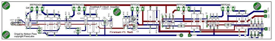

My version of F1 PCB
Hi, here is My version if PCB for Pass Labs F1 !!
This is not as original.
