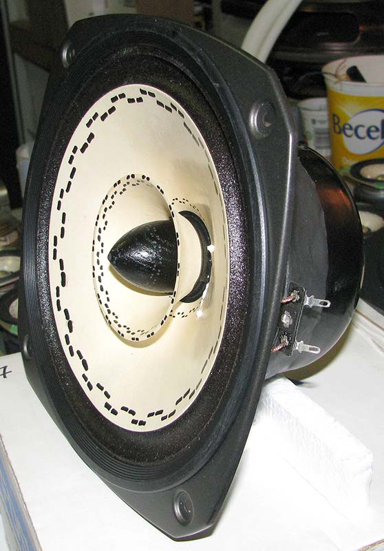

JC951t said:Yes this one. Do you have an experience with this ?
No, but it is an interesting design concept.
Alex from Oz said:No, but it is an interesting design concept.
Yes... poking around in the shop... "wonder if this socket would work as a phase plug?"
Glad to see he finally went with a plastic imitation... a socket is really hard to remove after being installed.

For upgrading I would prefer the 206 though as they sound incredible when mounted with a phase plug and an extra magnet mounted. My main caveat with the 207 is that you really need a supertweeter when you you want the most out of it whereas the 206s little lacking bass can be helped by the right horn or adding a (very good and fast) subwoofer to the setup.

I hands down do not like supertweeters, so I'd go to any length to avoid them personally. And making a phaseplug yourself isn't terribly difficult. Take a piece of broom stick of the right girth, fasten it into a socket spanner of right size and put that into an electric drill, preferably one with variable speed, clamp the drill to your work bench. Experiment a little with getting the setup to run smoothly. Now take a sander and start sanding away on the running rig. After a few tries you'll have your own, almost free of cost, phase plugs.

I haven't tried the decware ones but to me it looks like just another phase plug with a different shape. I reality though there's no reason to distinguish between the two. A phase plug is in fact the same as a wave guide. The hole in the dust cap on the fostex driver is to vent out compression behind it.
Although there's almost no measurable difference phase plugged drivers wins almost every single time in blind tests.

beauistheman said:I mean, adding phase plugs will end up costing the same price and simply getting tweeters would it not?
Even if you have tweeters you still benefit from phase plugs.

JC951t said:Taking a look at the FE206 or 207, theres a whole in
the middle of the dust cap & it must be there for a reason.
Now if we replace it with a wooden phase plug, does it not
muck up the sound of the speaker ? Wherelse the Deware
wave guide keeps the hole in their design which in theory
should work better.
The hole is in the dustcap. It goes away when you cut out the dustcap...
