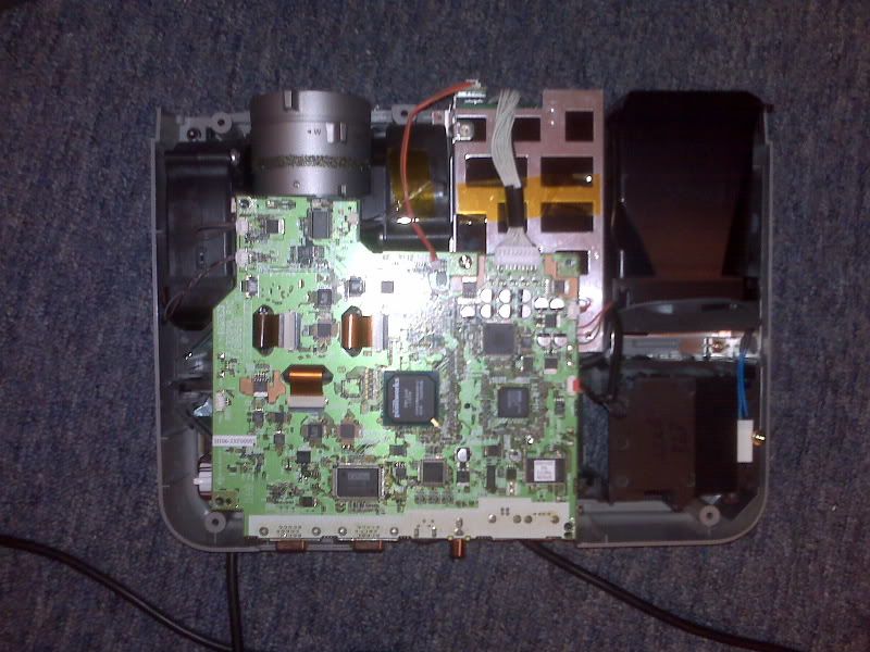

The current model - Epson PowerLite 73c

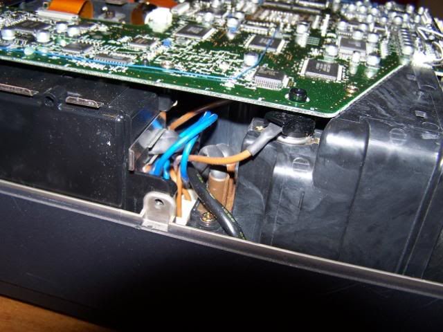

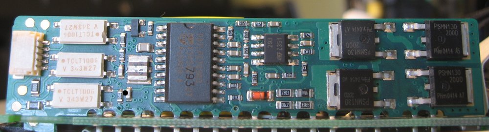

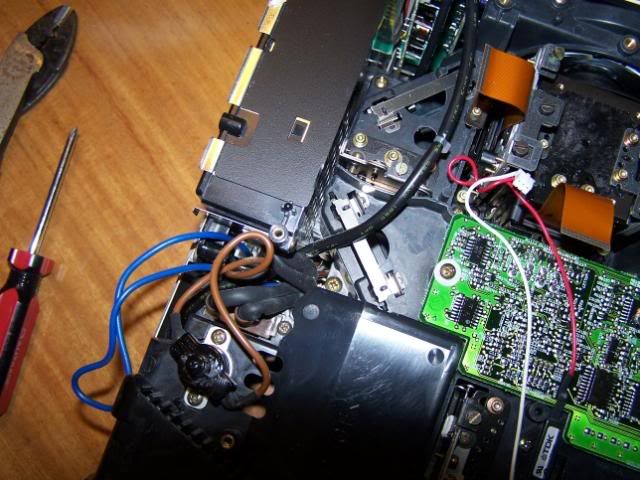

The ballast was pretty easy to bypass after some poking around with a multimeter.
***For those of you that are having trouble bypassing the ballast on any projector***
1 - Find the group of wires that come from the ballast to the main board.
2 - Power the projector on with NO lamp.
3 - Measure the voltages on all the wires connecting to the main board.
4 - Find the wire that is close to +3V
5 - Insert lamp (If you have one) and power on. Measure the voltage of this wire again. The voltage should be around 0V
6 - Connect the spot on the board where that wire connected to a ground on the main board.
This will bypass the lamps for 90% of projectors. It has worked for me on about 8 different models.
Here are some pictures of the inside and of the wire added ot bypass the ballast.
More to come as I test new lamp sources. LED and HID will both be tried. HID worked well on a DLP that I modded.

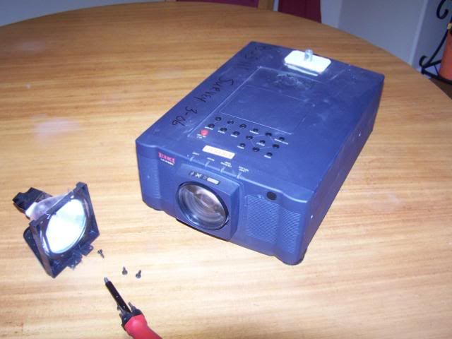

Very cool. I have an Eiki LCX-990 that has a dead bulb which I'm very interested in modding.
Victor
Victor
Not yet. I have to open it up first. Also, i'm pretty much a newb with multimeters so i might need you to walk me thru it

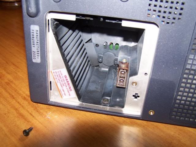

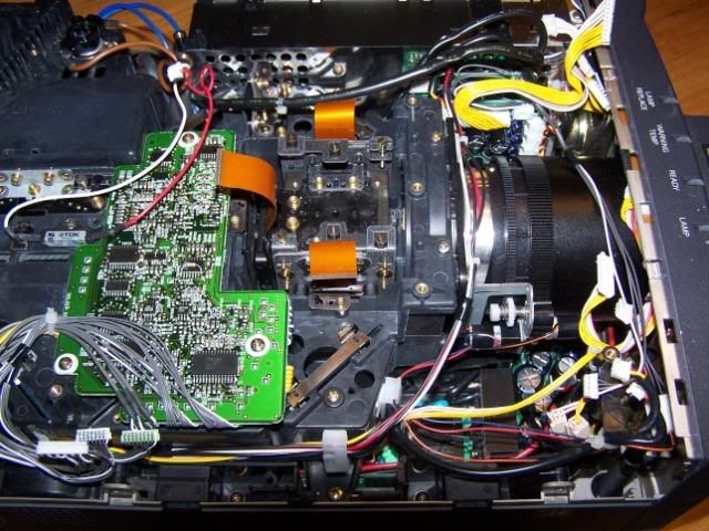

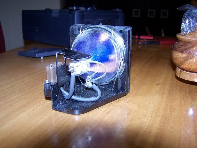

Here's something odd- and hopefully a good thing.
I did this to the old lamp- I took a piece of wire and connected the two, essentially making closing the loop on the current. Thinking nothing else would happen, I was surprised that zoom and focus functions work (they're powered on this pj) so something must be happening. I didn't test it for very long but perhaps on this particular pj that is all that is needed.

thats a dangerous way to bypass the ballast and it might fry it. You need the lamp reflector anyways so undo that. If the lamp is fried carefully remove the lamp so you only have the reflector and housing.
Follow my guide for ballast bypass and remove the ballast if its seperate. I will scan ur pictures better and see what I can see.
Things that aslo can be bypassed is the Lamp door and thermal switches.
